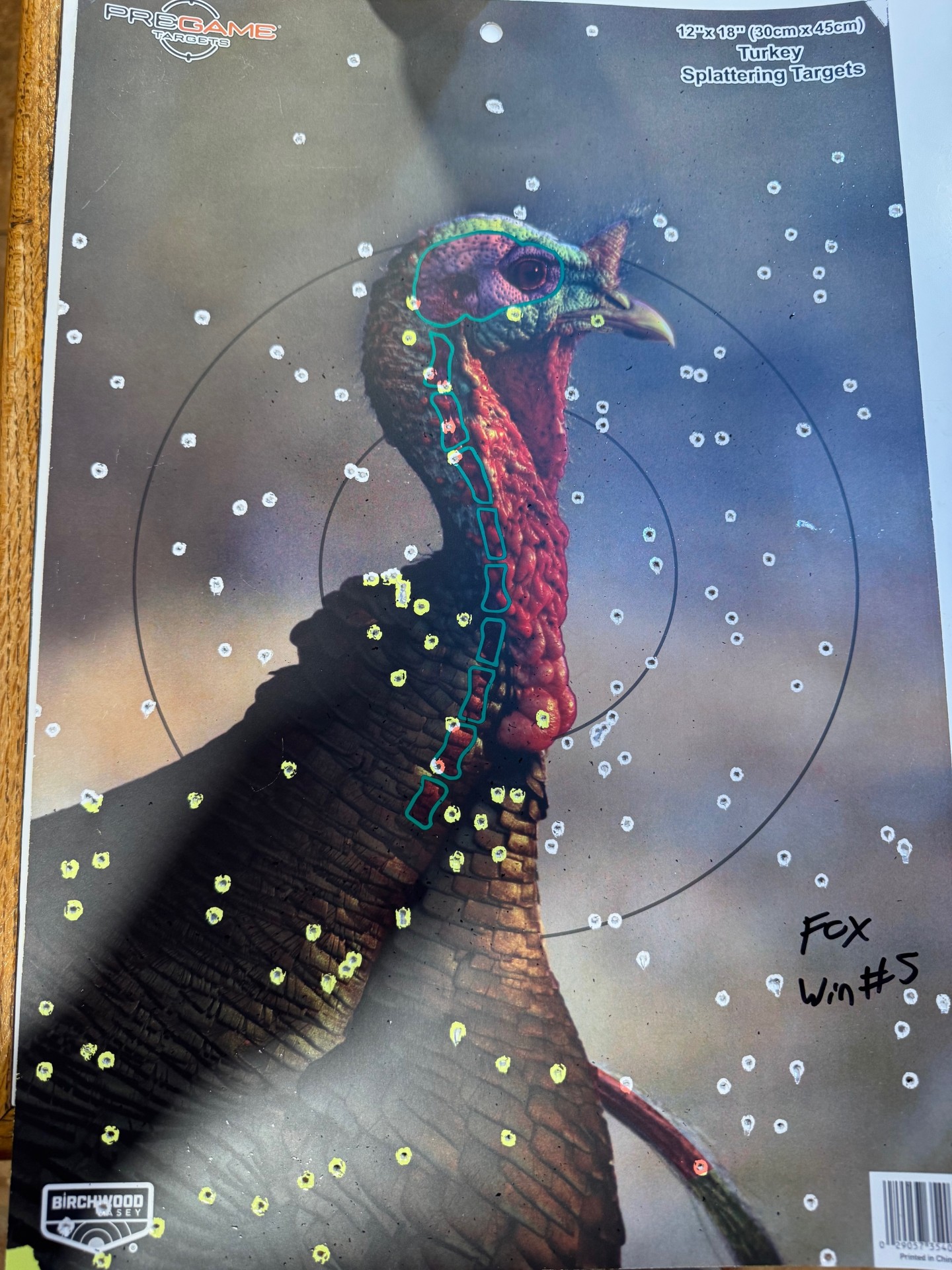

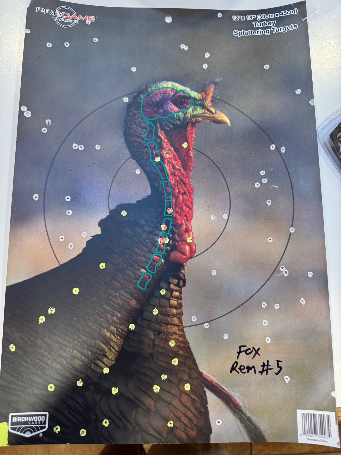

Since spring turkey season is less than a month away here, I decided to go ahead and try some loads in my Super. I shot three different loads:
1. Federal game load - 2 3/4" 1 1/8 oz of #4s
2. Remington XLR - 2 3/4" 1 1/4 oz of #5s
3. Winchester Super Pheasant - 2 3/4" 1 3/8 oz of copper plated #5s
I was shooting an 18"X12" target at 40 yards. All three shots were with the left barrel. My Super is also a 2 3/4" gun with 32" barrels.
1. Federals 2. Remingtons 3. Winchester As you can see, the Winchester load did the best. I'm happy with those results and hopefully this might can help someone else. Now it is time to start scouting and find some gobblers!

Good test, and thanks for posting your results. There’s no doubt in my mind that we’ll be seeing a picture of your super with a gobbler in the near future.

Re: Super Fox Patterning Results
Caleb, thanks for the info and report/pics of your results. While all three look good and would do the trick the concentration of the Winchester load is impressive!! A good reminder for us all to pattern each gun we choose to hunt with. Given the variation in bore size, choke constriction and chamber length of SF’s there could be a different outcome in different guns. Good stuff! Brett
