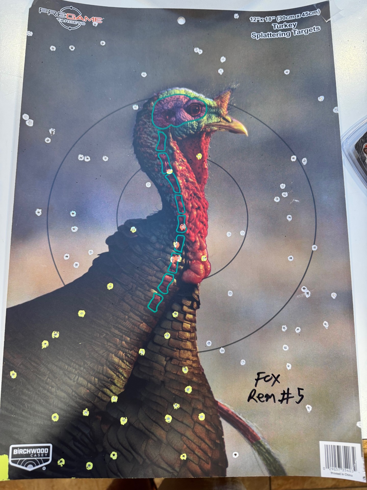

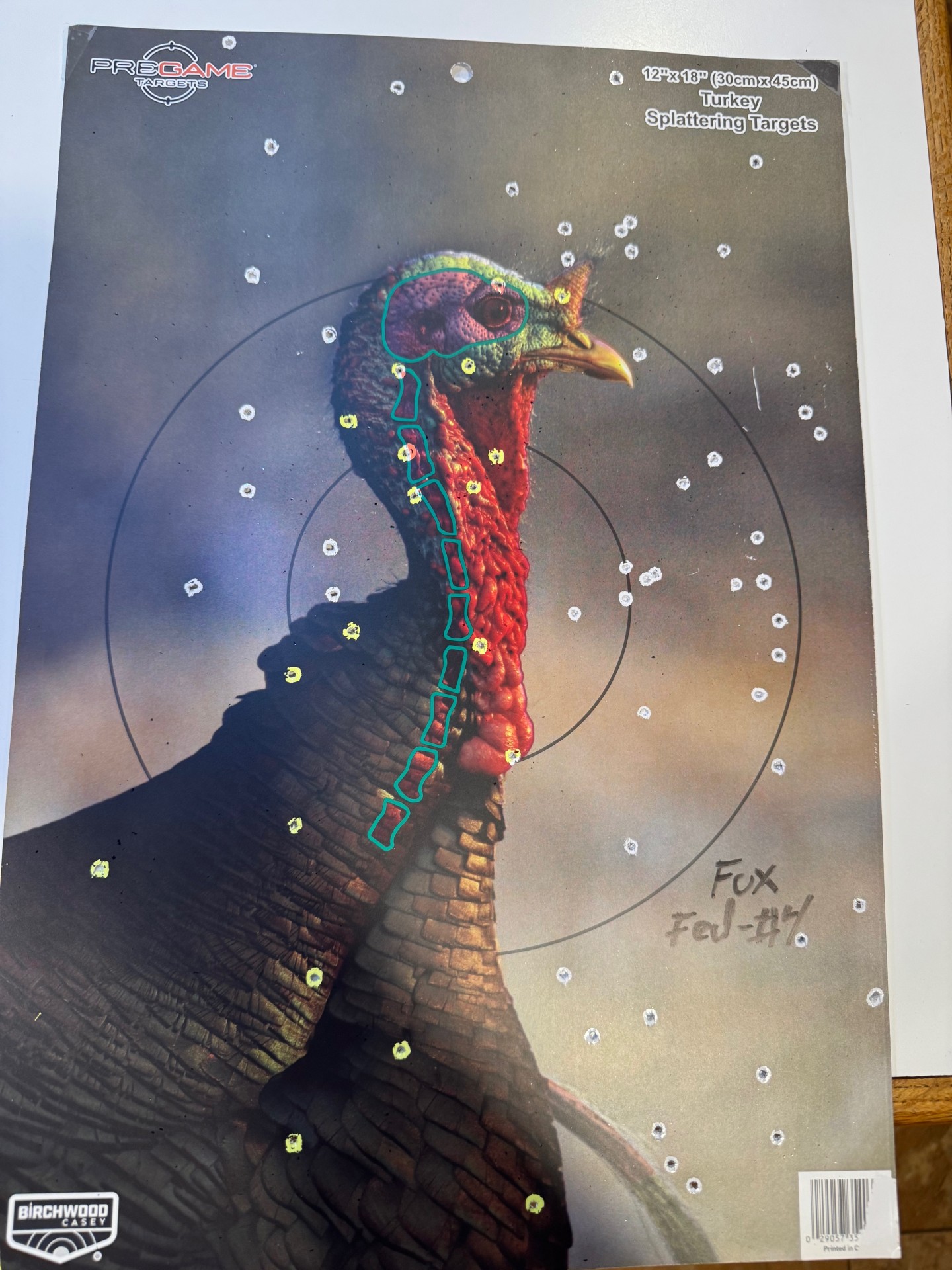

Since spring turkey season is less than a month away here, I decided to go ahead and try some loads in my Super. I shot three different loads:
1. Federal game load - 2 3/4" 1 1/8 oz of #4s
2. Remington XLR - 2 3/4" 1 1/4 oz of #5s
3. Winchester Super Pheasant - 2 3/4" 1 3/8 oz of copper plated #5s
I was shooting an 18"X12" target at 40 yards. All three shots were with the left barrel. My Super is also a 2 3/4" gun with 32" barrels.
1. Federals
2. Remingtons
3. Winchester
As you can see, the Winchester load did the best. I'm happy with those results and hopefully this might can help someone else. Now it is time to start scouting and find some gobblers!

Thanks for posting! How was the recoil with those Winchesters?

spyder wrote: ↑Sat Feb 21, 2026 6:39 pm Thanks for posting! How was the recoil with those Winchesters?
No problem! They have some kick to them but I would say it was comparable to the Remingtons and the Kent Bismuths I shot this past waterfowl season.

Good test, and thanks for posting your results. There’s no doubt in my mind that we’ll be seeing a picture of your super with a gobbler in the near future.

Caleb, thanks for the info and report/pics of your results. While all three look good and would do the trick the concentration of the Winchester load is impressive!! A good reminder for us all to pattern each gun we choose to hunt with. Given the variation in bore size, choke constriction and chamber length of SF’s there could be a different outcome in different guns. Good stuff! Brett

That Winchester load is what I would shoot all day every day out of a Soper Fox. Reality is you might shoot 2 or 3 shots a year out of that Super at a turkey.
Think I would shoot the other barrel and see what your pattern is also. My last turkey kills with my Fox was 11 yards away. It might be nice to know what the other barrel can do.

vaturkey wrote: ↑Sun Feb 22, 2026 4:39 pm That Winchester load is what I would shoot all day every day out of a Soper Fox. Reality is you might shoot 2 or 3 shots a year out of that Super at a turkey.
That is a good point, may test the other barrel before season gets here just to see what happens.
