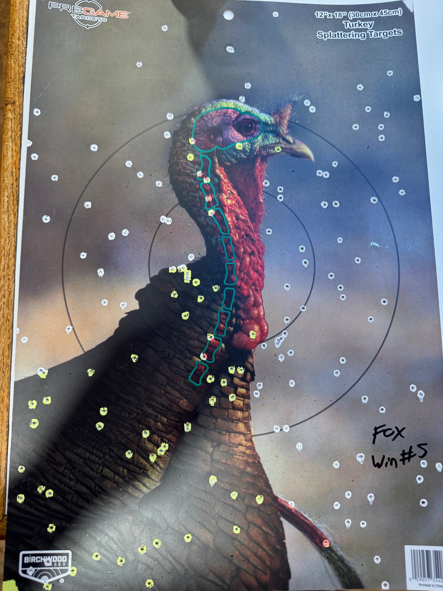

Since spring turkey season is less than a month away here, I decided to go ahead and try some loads in my Super. I shot three different loads:
1. Federal game load - 2 3/4" 1 1/8 oz of #4s
2. Remington XLR - 2 3/4" 1 1/4 oz of #5s
3. Winchester Super Pheasant - 2 3/4" 1 3/8 oz of copper plated #5s
I was shooting an 18"X12" target at 40 yards. All three shots were with the left barrel. My Super is also a 2 3/4" gun with 32" barrels.
1. Federals
2. Remingtons
3. Winchester
As you can see, the Winchester load did the best. I'm happy with those results and hopefully this might can help someone else. Now it is time to start scouting and find some gobblers!

Caleb, thanks for the info and report/pics of your results. While all three look good and would do the trick the concentration of the Winchester load is impressive!! A good reminder for us all to pattern each gun we choose to hunt with. Given the variation in bore size, choke constriction and chamber length of SF’s there could be a different outcome in different guns. Good stuff! Brett

I'm sure any of your loads will kill a turkey, but if you are a head shooter, a load of #6 will put more shot in a smaller target.

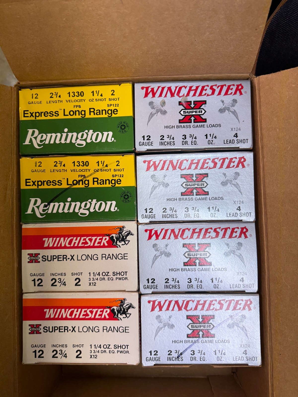

I'm set for a while. I don't know if the factories still offer High Brass 2's in 2-3/4" 12 gauge but I see relatively new old stock boxes occasionally at Gun Shows. Just an aside, when I was a kid I’d ride my bike two towns up the line to get Super-X or preferably Peters High Brass 2’s for fox hunting from a friendly shop owner who’d sell them from an open box, 5 for $1.00. Those “Peters packs the Power” adverts really got to me. :D frank
