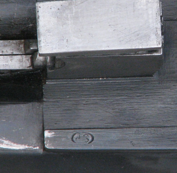

Just a comment on the "JS in a circle", Savage Fox at Utica proof tested its chamber work and stamped what I've long called the "SP/Oval" proof mark to indicate same. That's SP inside an oval not a circle. If the SP is viewed upside down it could be read as JS. frank
Edit: PIC ADDED ..... on this one the top of the P was lightly struck.

Posts: 2805
Has thanked: 855 times
Been thanked: 985 times
Re: Early Fox A Grade repaired by Savage?
Silvers wrote: Sat Feb 14, 2026 7:50 am
Cat955 wrote: Thu Feb 12, 2026 8:00 pm I had a friend email that in In Michael McIntosh's book A.H. Fox: The Finest Gun in the World, there is a discussion that the "JS" in a circle is attributed to an inspector at Savage, Mr. Joseph Santoro and is found on page 127 (in the 1994 Revised Edition). I do not have the book so if anyone does have it maybe they could confirm?
Agree, and I always thought the SP stood for Savage Proof.

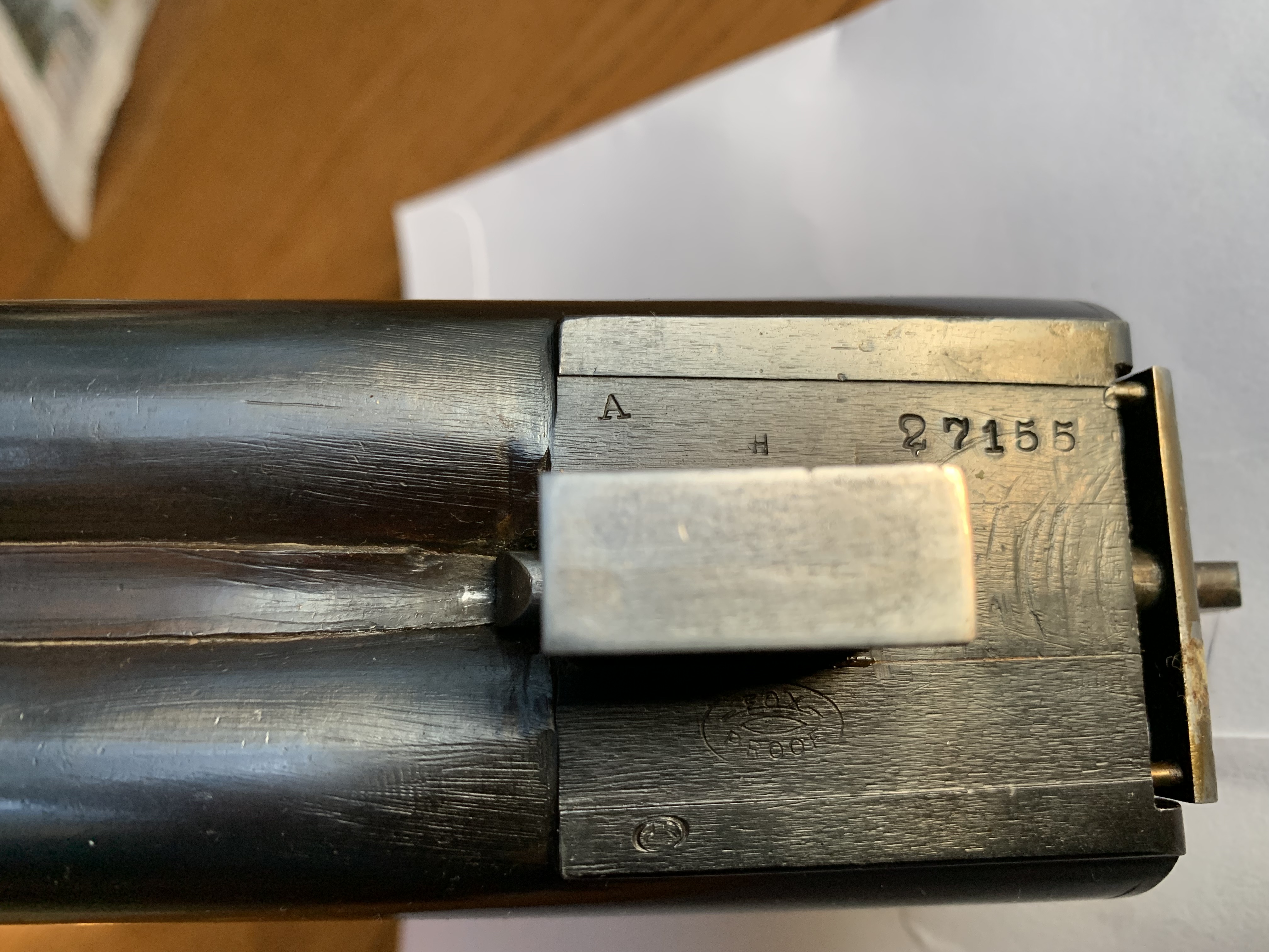

Gsheller
Posts: 7
Joined: Sun Feb 08, 2026 10:59 am
Location: Maryland Eastern Shore
Has thanked: 6 times
Been thanked: 4 times
Post by Gsheller »
Here is a pic of the SP oval on the Philadelphia A grade in my earlier post - interesting that it was also lightly struck in a very similar way as the one in Silvers’ photo.
Also curious whether the “H” stamp is original, or from it’s trip to Savage?
