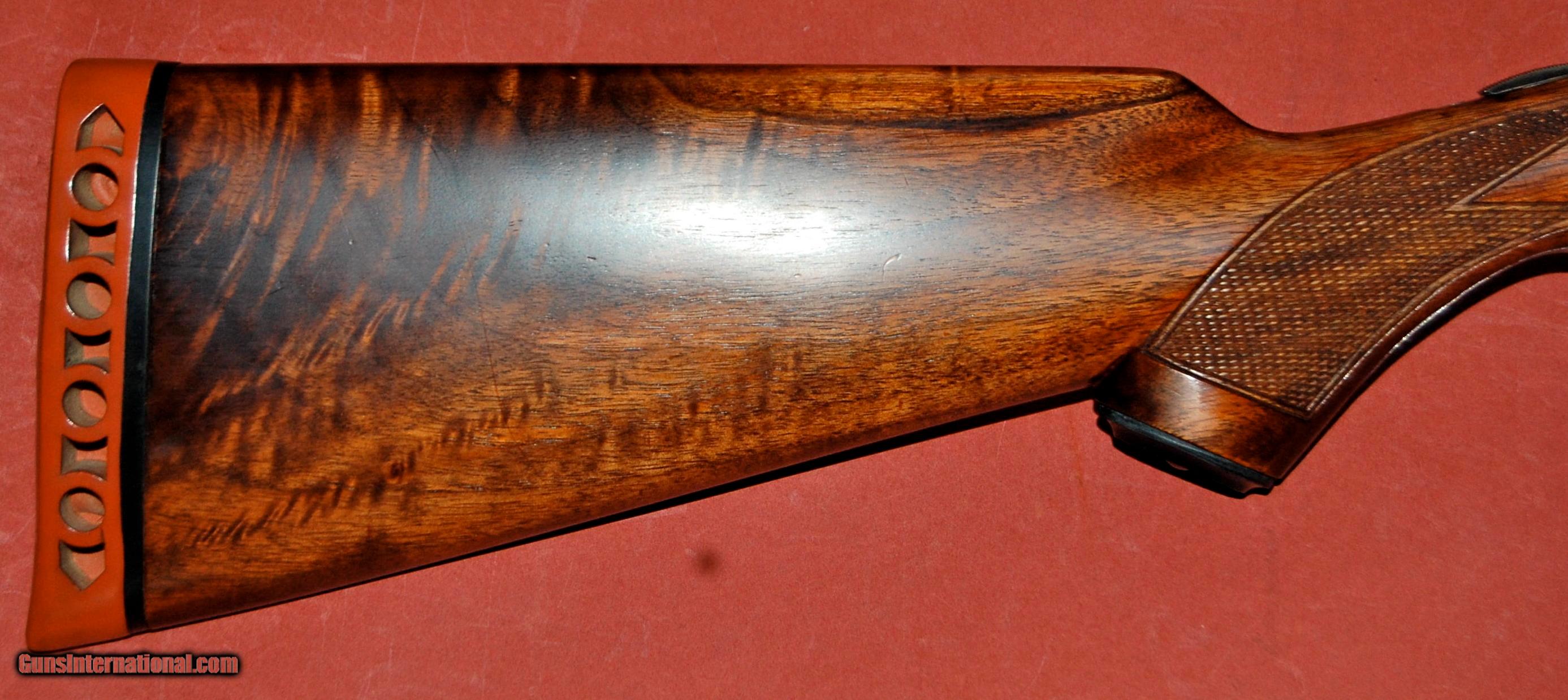

Could this Red Head pad on a 1922 AE 16 be an original factory pad ?
If not, What pad would be appropriate for that time period ?

Nope. The design for the Red Head pad was filed April 19, 1937, and granted as Design No. 105,358 on July 20, 1937.
The most found pad on A.H. Fox Gun Co. guns of that era would be the Jostam Anti-Flinch or a Silvers type (Silvers, Goodrich or Jostam Air-Cushon) pad on higher grades. A customer could order a one-, two- or three-ply Jostam Sponge Rubber pad. By the later 1920s the Hawkins pad was on the market.

Thank you very much for the information ... That was exactly what I was searching for.

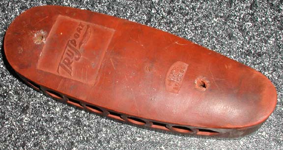

I've never see such a thing in a Jostam catalog or magazine ad. Would love to add a picture of it to my files. Red Head was in Chicago, and by the time of these pads Jostam was south of town in Peotone. We have seen quite a few different brands on the "Red Head" pad, like this marked Tru-Sport for E.K. Tryon --
TruSport pad 01.jpg (68.27 KiB) Viewed 9687 times
