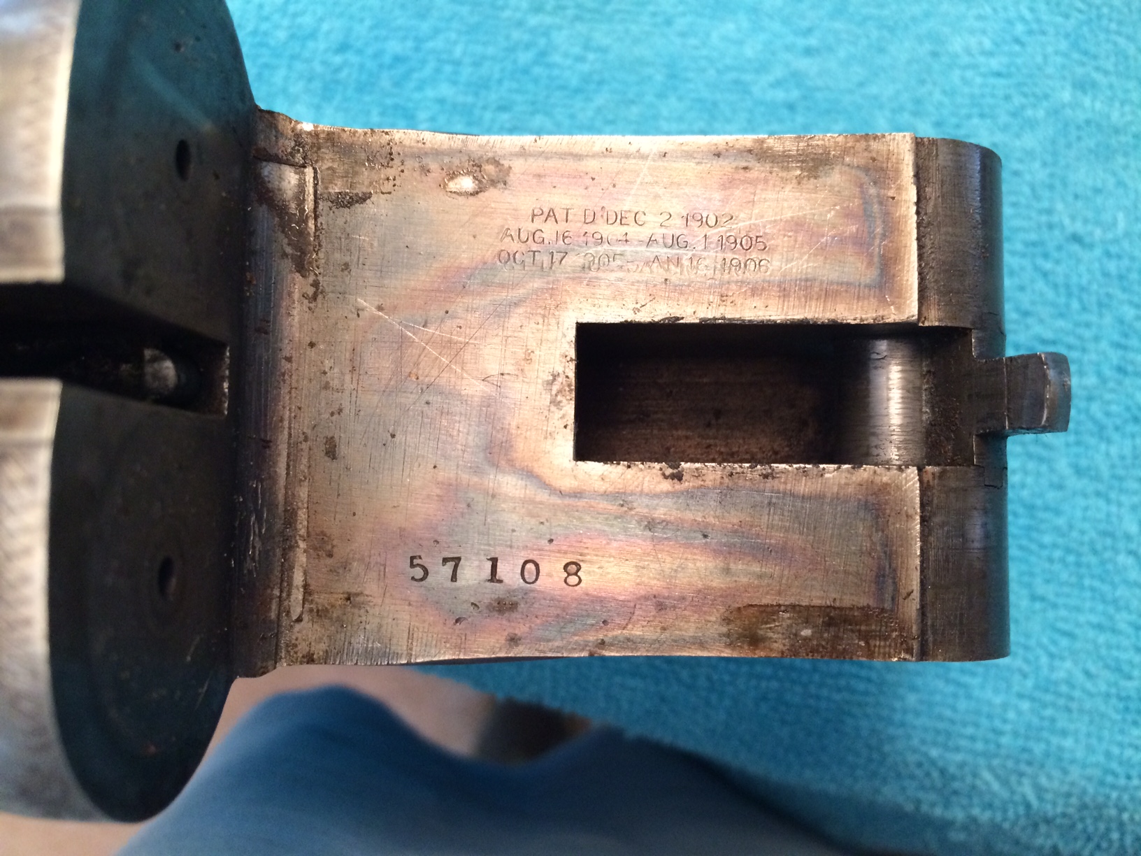

With that serial number the gun should be one of the Pin Gun's as I recall. (Google Fox Pin Gun and you will find info on it). I'd be very surprised if the barrels weren't cut on that gun given the serial number. Posting a picture of the barrel ends might help us out. FWIW, with hunting the birds your hunting you might want a bit more choke then what this gun seems to have. 12 gauge Sterly's are quite common to find in reasonably good condition for little money. To get an idea of real values, if you go on gunbroker.com and look up what has been sold in the last 30 days or so, you can get a idea of what the values are associated with the condition of the gun.

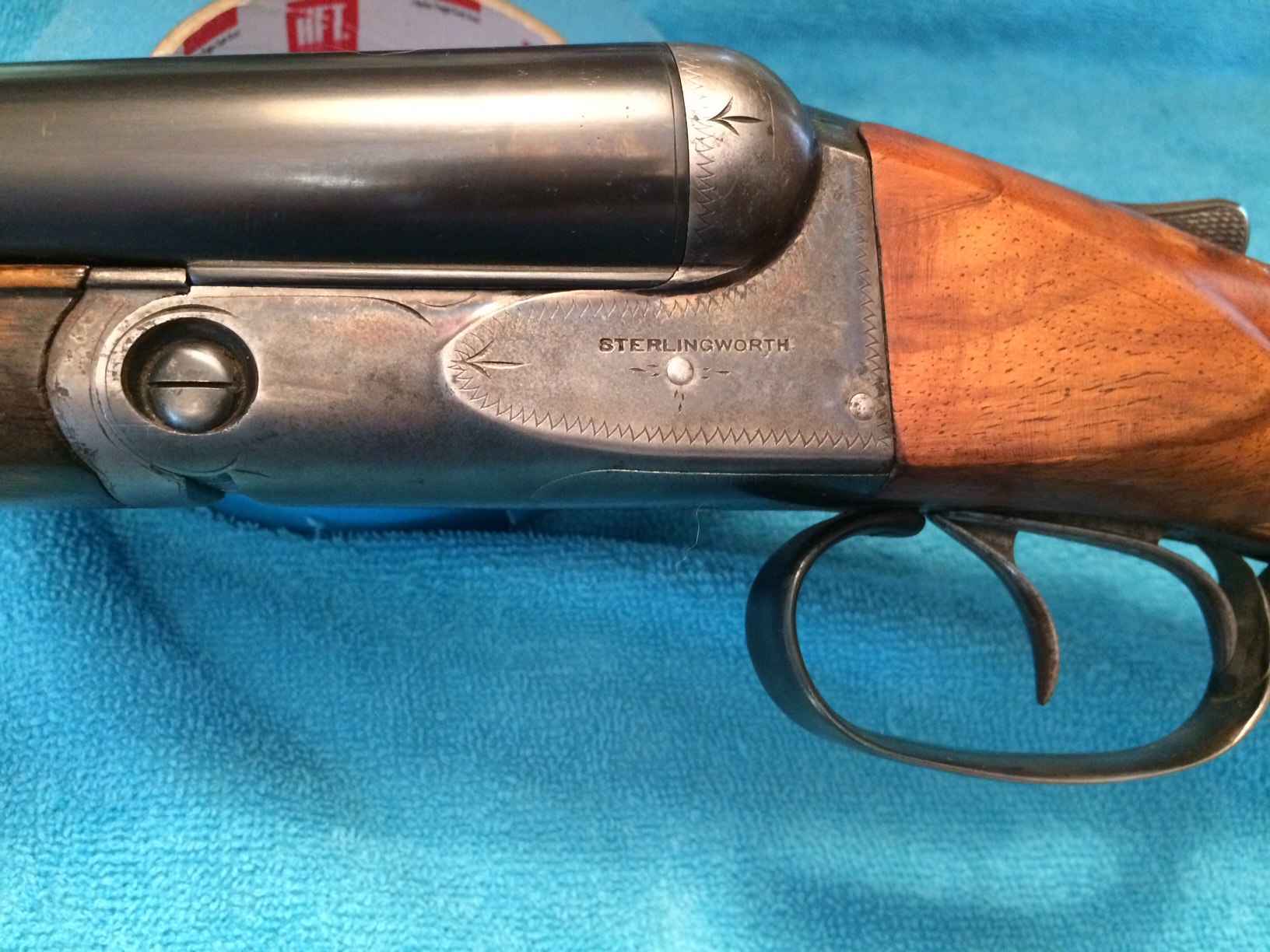

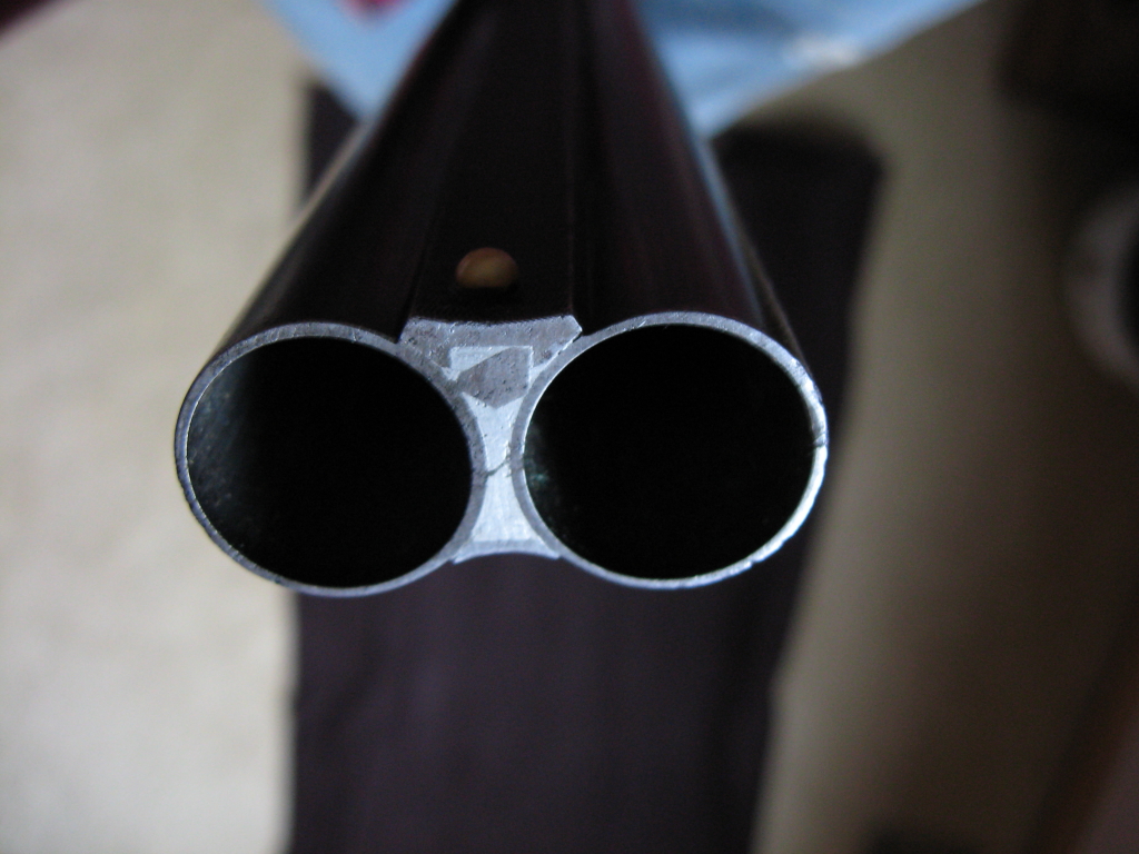

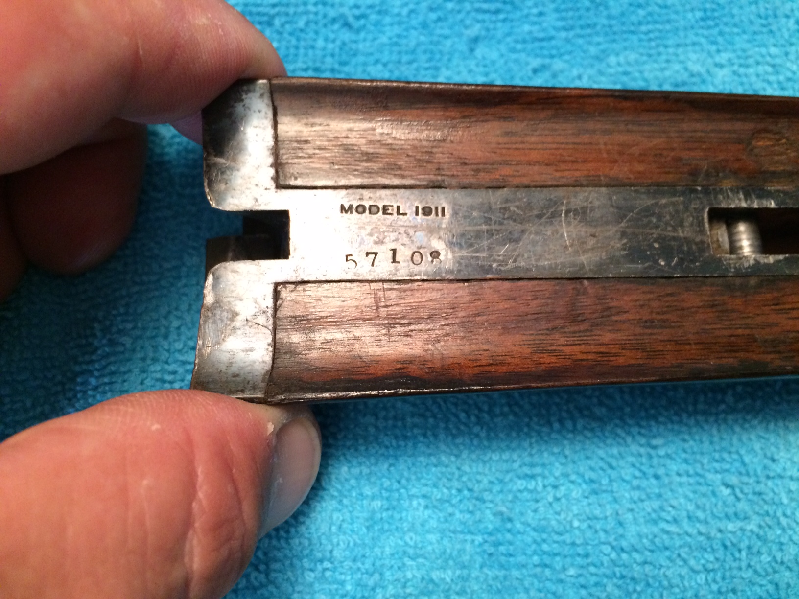

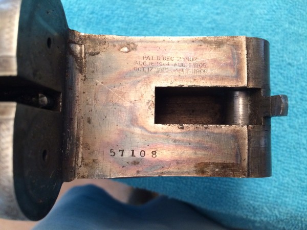

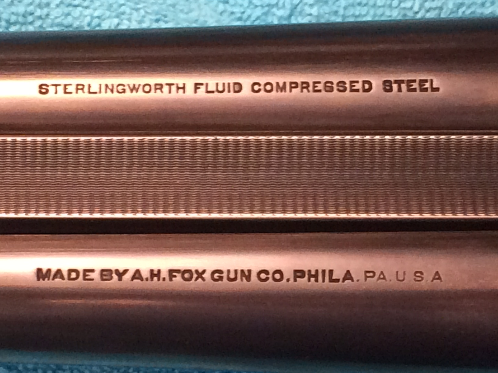

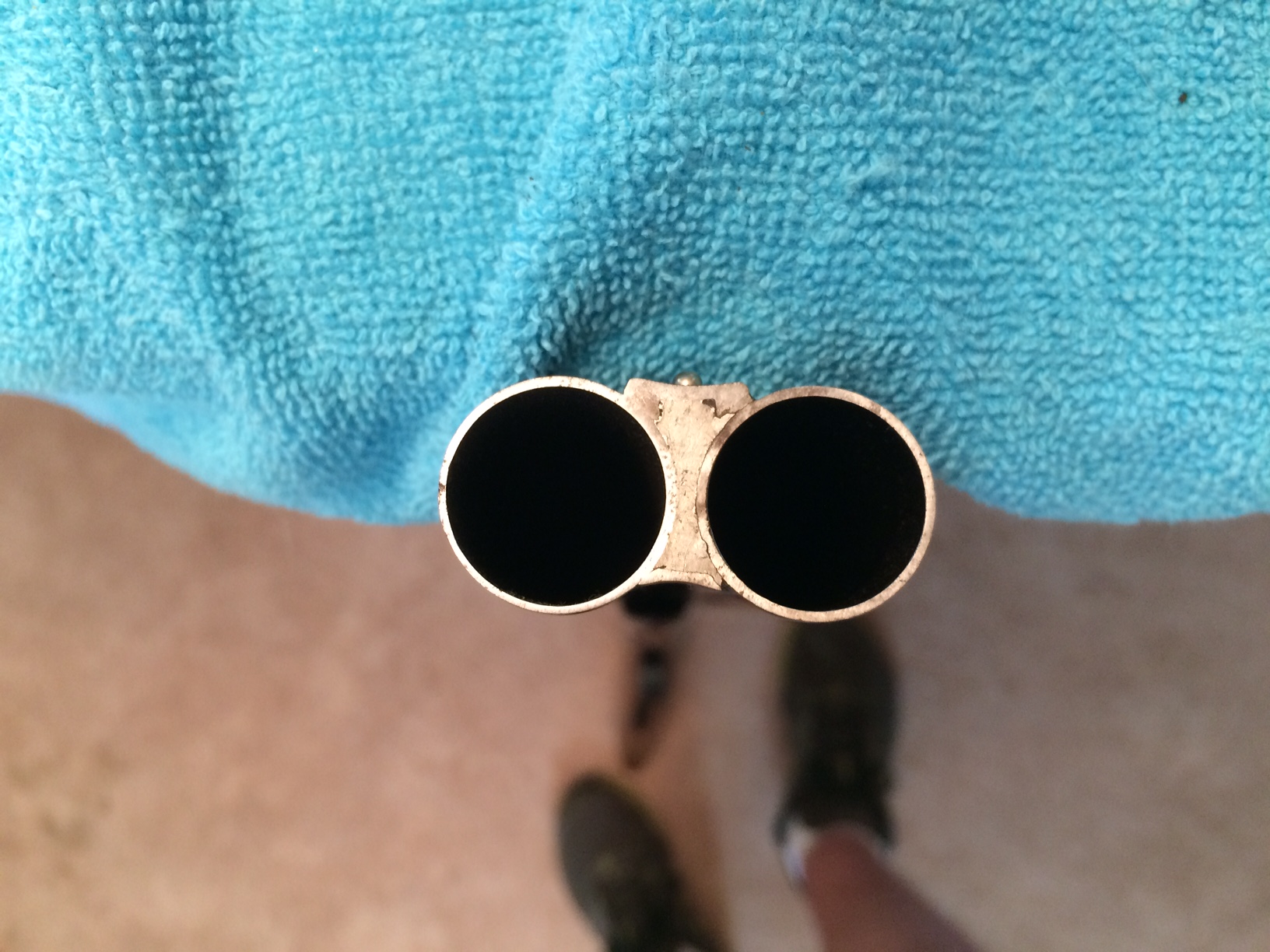

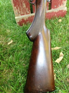

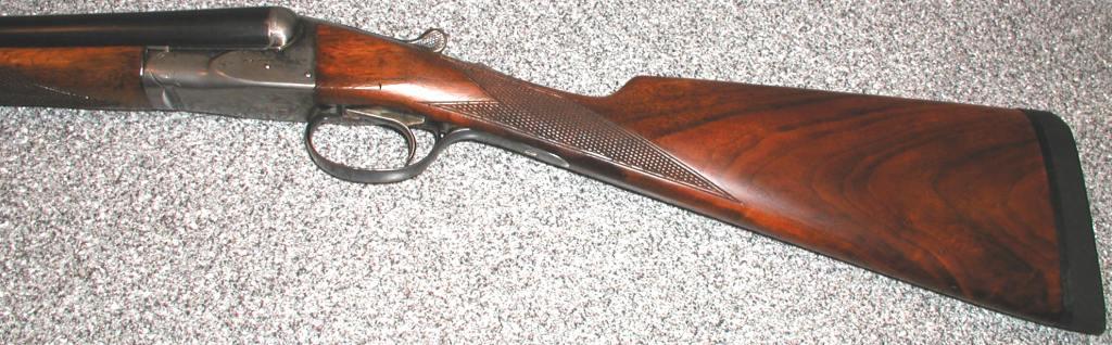

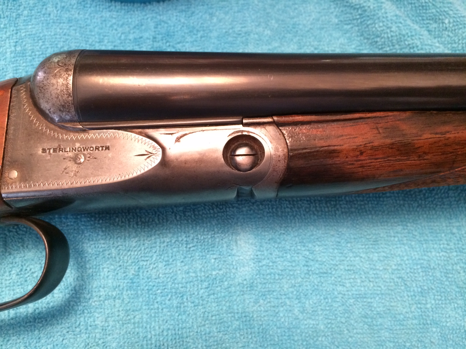

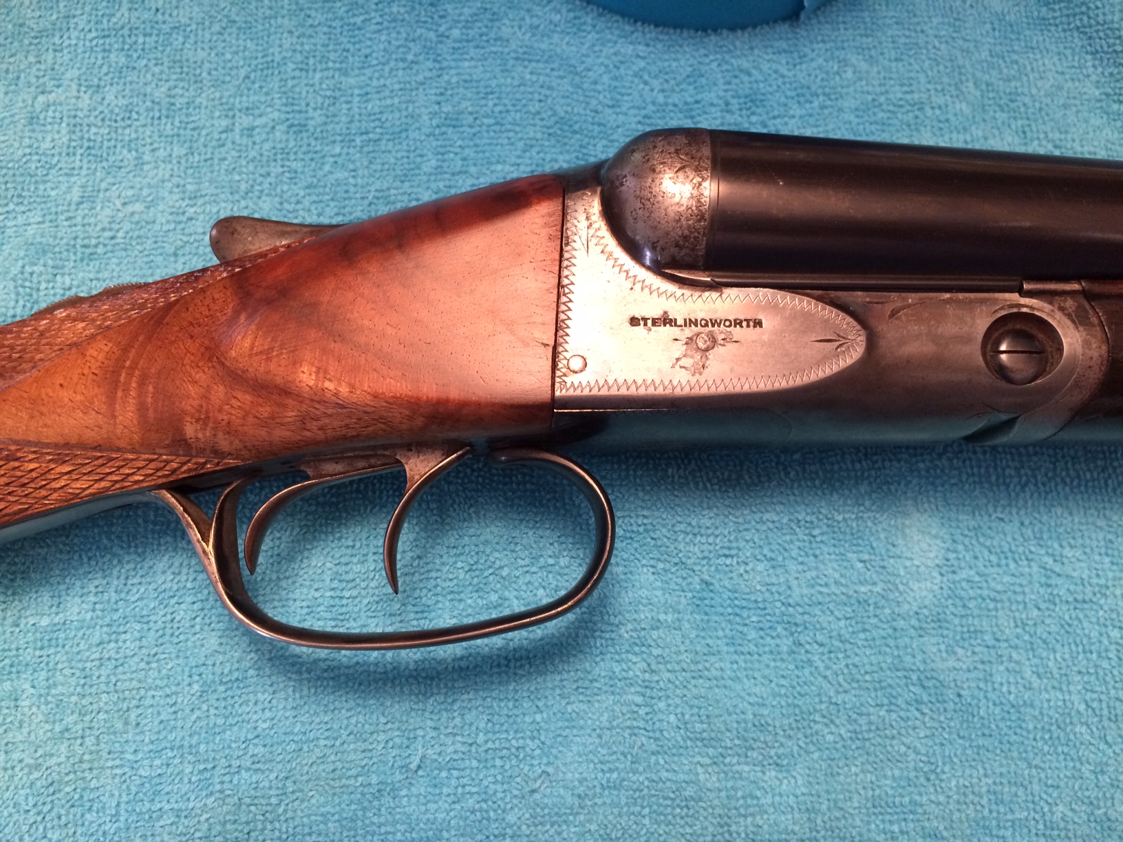

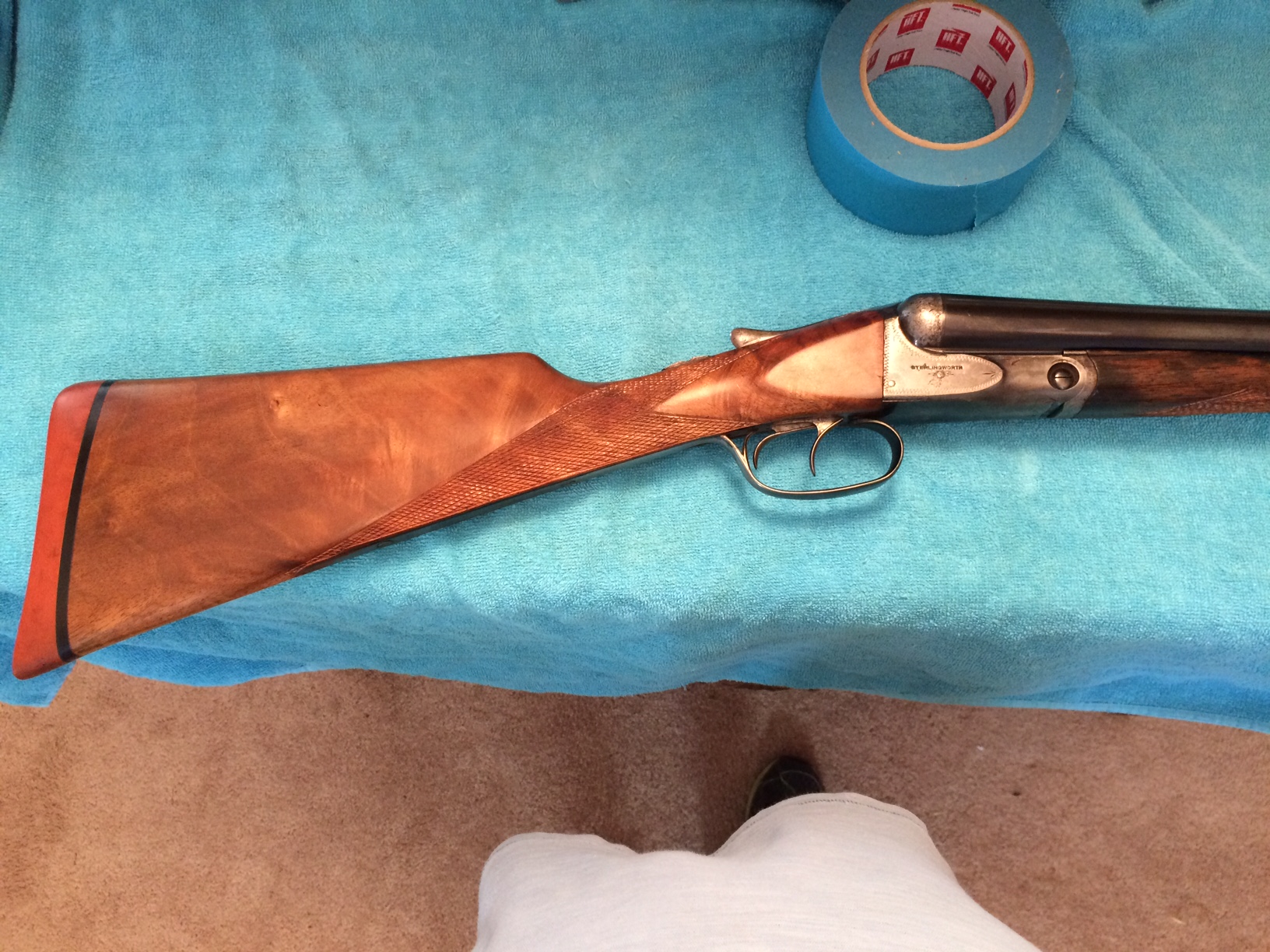

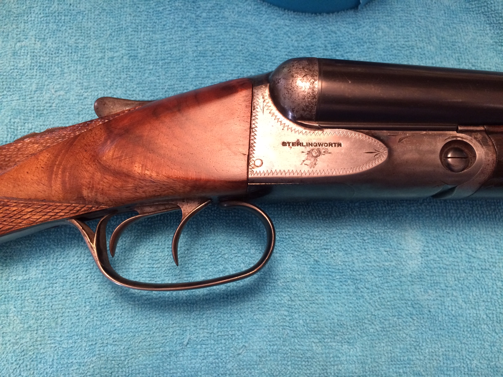

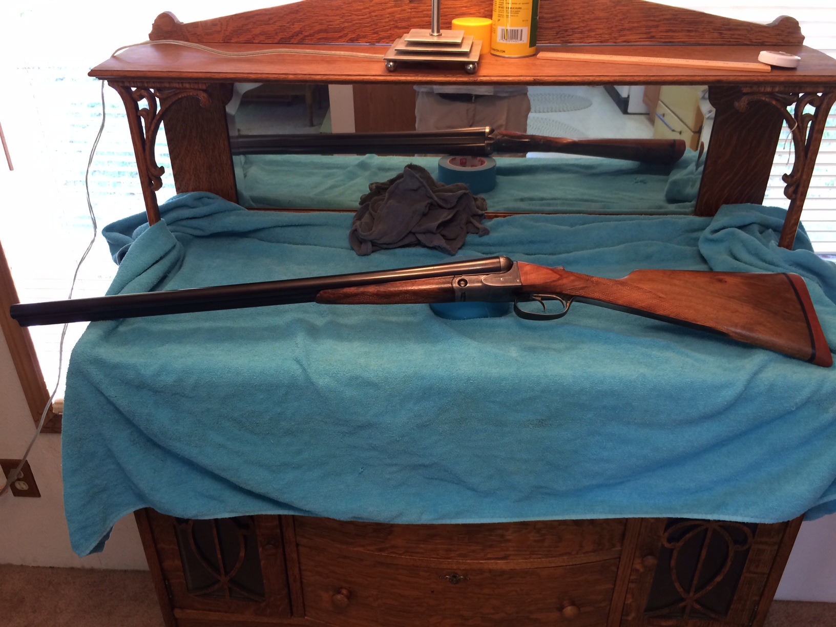

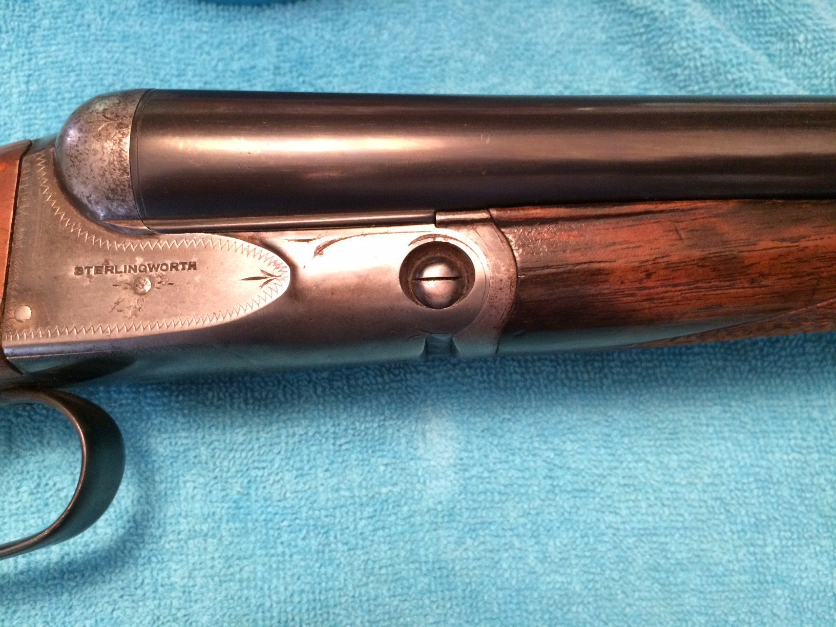

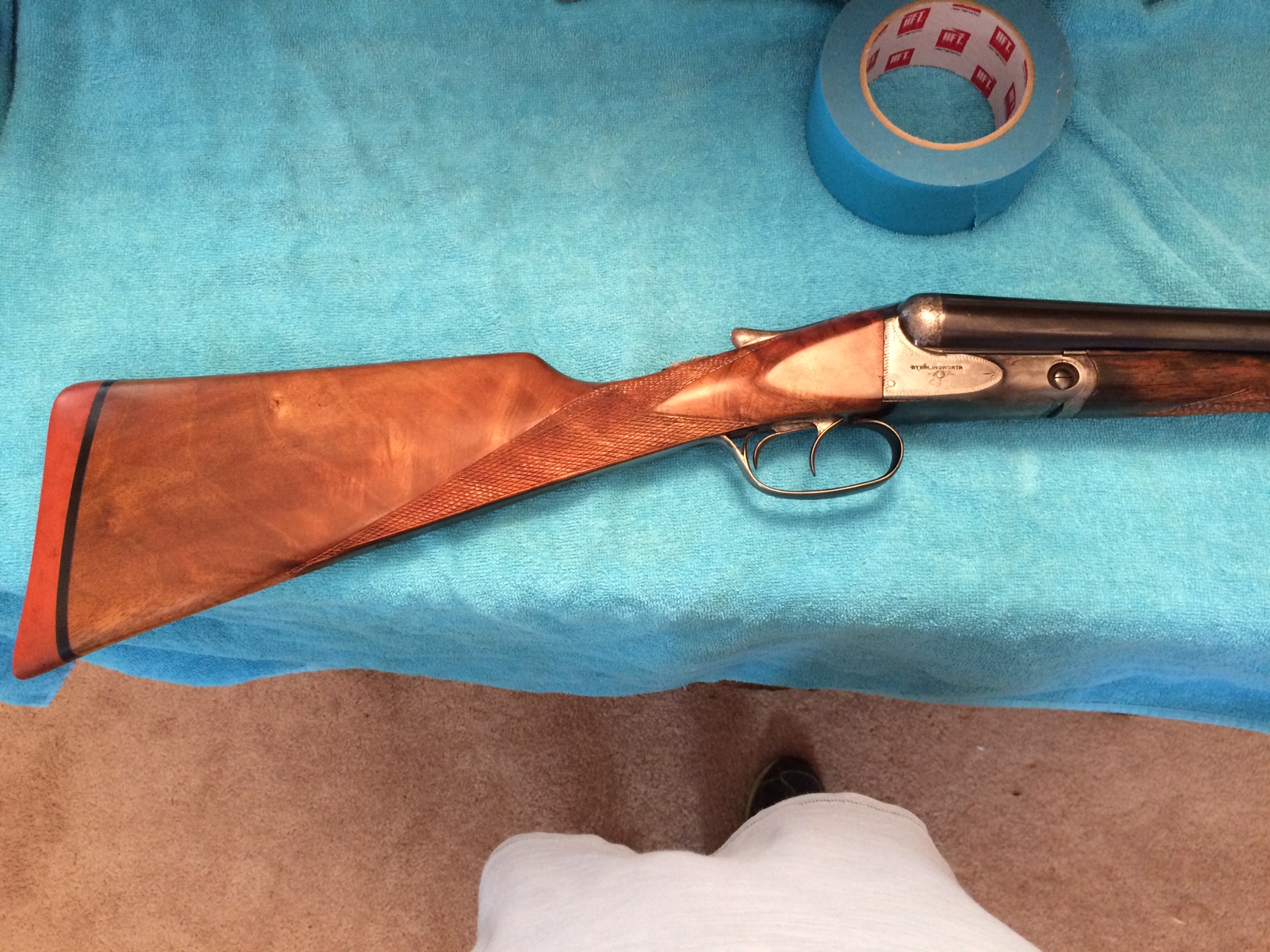

Thanks guys for all the info. My eyes were opened by you all and I tried to apply it as I took measurements and a bunch of pics. It definitely has been worked on as you'll see. I'm told the stock was redone by Bill Ferguson, but not sure what else has been modified or they finished. The drop at heel is 2 and 1/4 inches and the drop at comb is an inch and a quarter. I'm still not sure if the barrels were cut down. The foregrip has a small crack running approximately 4 inches from the front right side back and there is a small pin that's been placed in it. Please take a look at the pics and give me some feedback. Again the serial number is 57108. I sure do appreciate the information and I enjoy learning and going through this process.

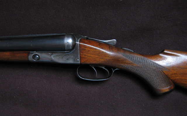

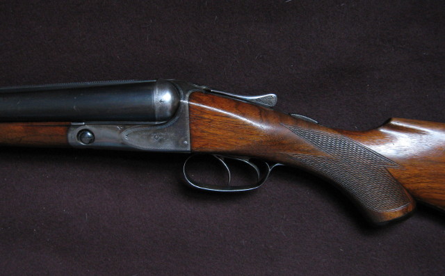

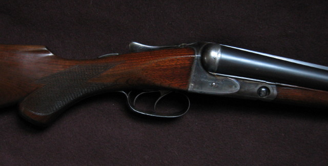

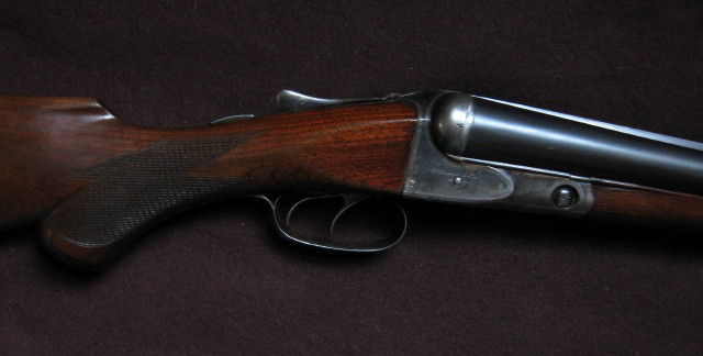

That is definitely a restock, and 98% sure the barrels have been cut. A Sterlingworth stock of that era looked like this --
The Sterlingworth was only supplied with a capped pistol grip until 1935 when Savage introduced their Fox-Sterlingworth Skeet & Upland Game Gun with a straight grip --

Thanks for the information researcher. That makes sense with what I'm being told about it. I'm not sure what it does to the value. I imagine they had a good reason for doing what they did. Given that the barrels we're likely also cut down how does one go about determining what the chokes are? Being that I'm looking for a fox side-by-side to hunt birds with maybe I should take the advice of others and look for something more solid and original to its time. I know that I would like the barrels to be open and modified.
Re: Seeking Advice on a Fox Gun For Me & My Dogs
You have been given great advice. Being cut down the chokes need to be measured because they have been cut back to a more open place in the barrel. If you can get it at a deal the shoot it and love it. They are all cool guns but the ones that still get the game are the coolest

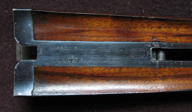

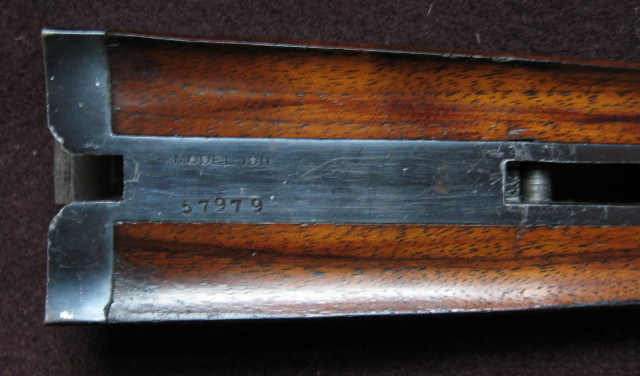

As Researcher/Dave pointed out above, it looks like the stock is not original. Those early Model 1911 Sterlingworth's (also known as the Pin Gun because of the exposed hinge pin head on the receiver) had full pistol grip stocks with a grip cap.
Dave mentioned the possibility of it being the Brush model with 26" barrels and knew of one righteous lettered Brush model in the other end of of SN 57108.
That would be my gun, SN 57979.

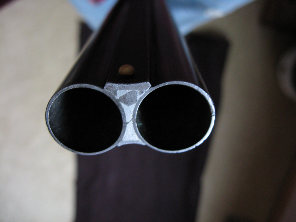

Below is a picture of the muzzle for comparison plus one or two more. Note the presence of a key or keel just below the top rib. Those are not always visible.
I suppose if the gun is really priced right and it fits you and you'd be happy with an open choked gun, it just might be an OK purchase. The problem in buying a non original gun is when you go to sell it. What is the asking price for the gun?
