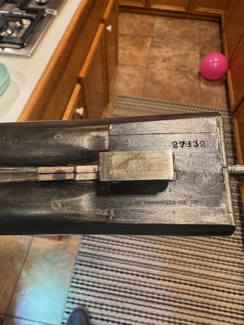

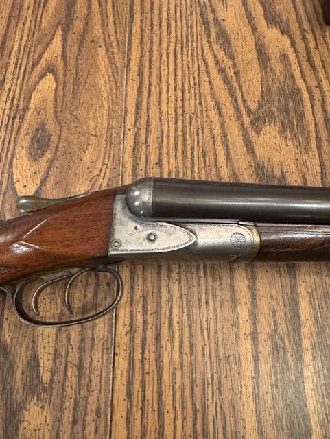

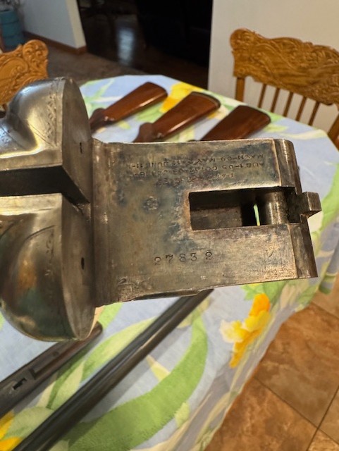

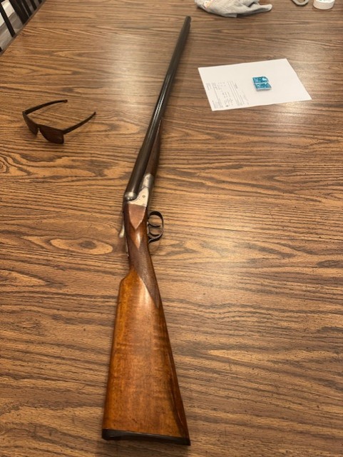

Hello everyone. My dream gun has always been a Super Fox. I came across one recently, but I am curious because it doesn't have the "H" stamp on the barrel flats. Instead it has an "I" stamp. Everything else looks good. 32" O weight barrels, all matching serial numbers, the right engraving. They also have the stamp on the flats that says the barrels aren't guaranteed. I even measured the receiver at the breech balls and it is considerably larger than a normal 12 frame. Or larger than my A grade anyway. It is also a philly gun. Has anyone ever seen anything like this? I need to get a letter on it for sure. I'll attach some pics. Thanks!

Looks like a Super-Fox to me. Why it doesn't have an H stamp is anyone's guess. They were made by human beings. Order the card from the AHFCA and/or get a letter on it from Cody --

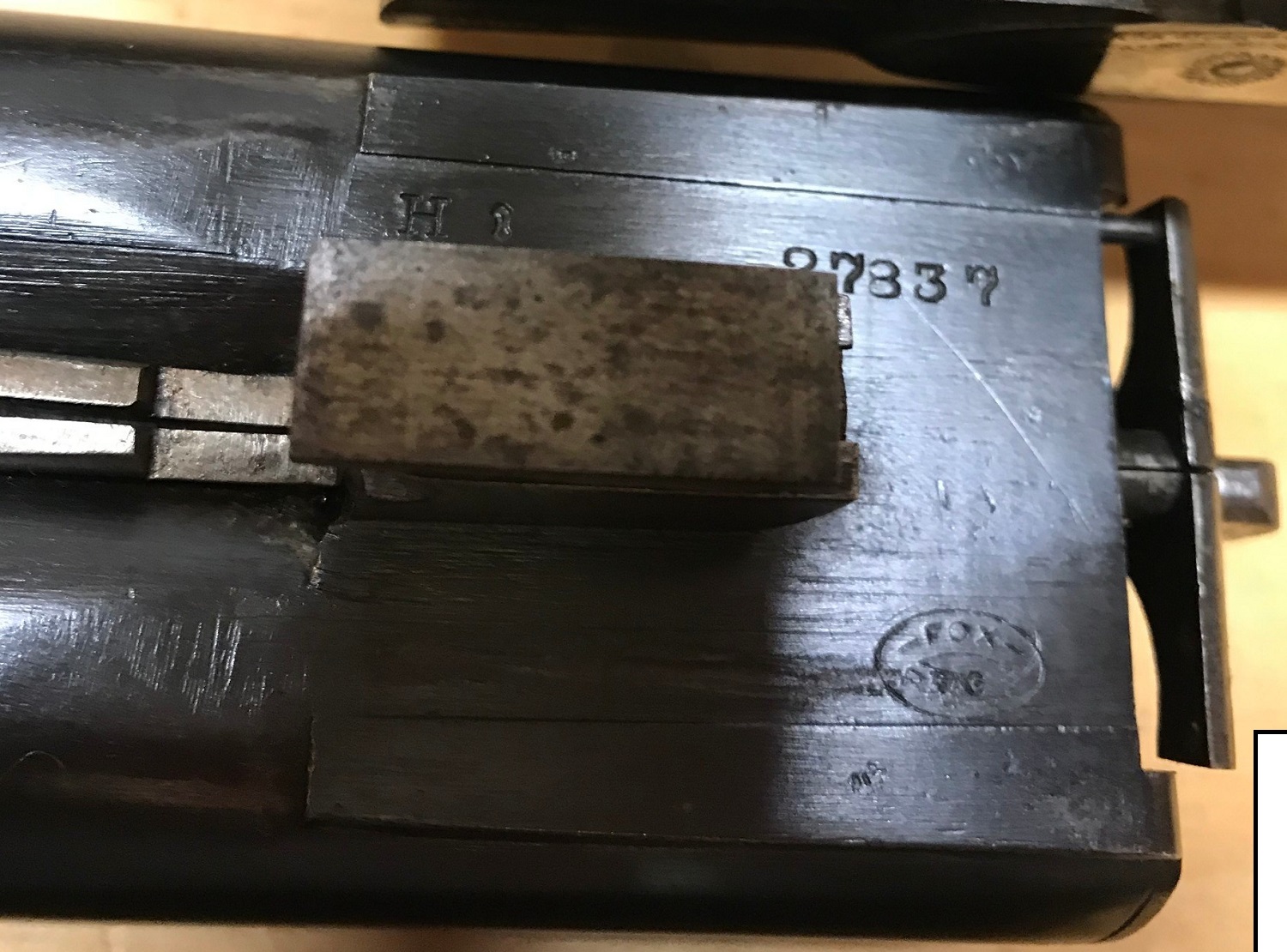

Checking my files I see 27837 has the H to the left of the dog-bone symbol --

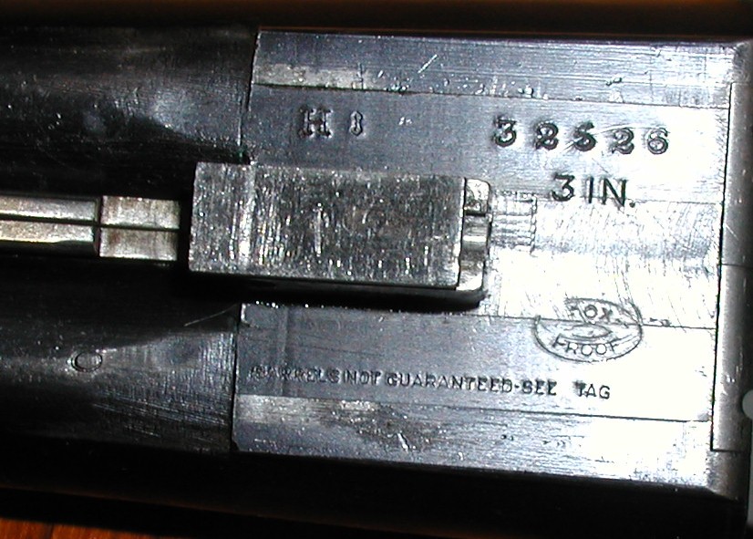

as does my 3 IN. Super-Fox --

Very interesting. 27837 is only 5 away from my serial number, pretty cool!

Now that you are a member request the card. It sure looks and sounds like a Super based upon your description and pics.

Definitely a Super. Like others I suggest you order a Record Card copy and see if it matches up insofar as stocking. And since it's not stamped 3 IN. I also suggest you measure the chambers to verify if original 2-3/4" or properly lengthened.
FYI, it looks like the right barrel ejector guide pin is broken off. Hopefully the broken pin isn't stuck in the barrel breech which greatly complicates its replacement.

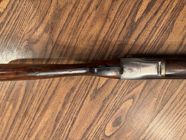

Also if you get a chance can you post some pics of the long tang trigger guard? Straight grip Supers are relatively rare. frank

Sure Silvers, here is a pic of the trigger guard.
Has thanked: 1228 times
Re: Is this a Super Fox?
Thanks for the additional pic. That long strap trigger guard looks proper to me. frank

Well I got the card back and thankfully it is a Super. From Sep of '23 looks like. And it is a 3". The card does say half pistol grip though which is surprising to me because I would have swore this was the original stock. The long strap trigger guard and the amount of wear on the stock is the same as the forearm. Even the checkering is the same and equally smooth. O well, I'm tickled pink with it either way.

Caleb, I’m a former Fox BOD member and have access to the Record Card copies. I’ve also been a student of Supers for many years. I looked at the Card for 27832 when you first posted and saw the gun was made with a Half Pistol grip stock, and that resulted in my reply to look at the shape and length of its trigger guard.
Then I read your newest reply and didn’t remember any 3-inch notation, and just now revisited the Card copy. The “3” you see in the upper right corner of the Card copy refers to 3” drop at heel, not the chamber length. And in the absence of a 3-inch shell notation it can be assumed that your Super was made with regular tight 2-3/4” chambers intended for 2-3/4”/1-1/4 ounce period progressive shells. frank
