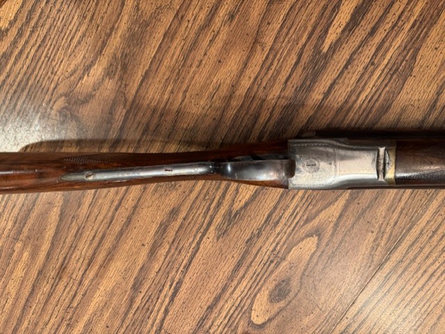

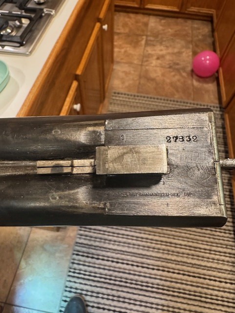

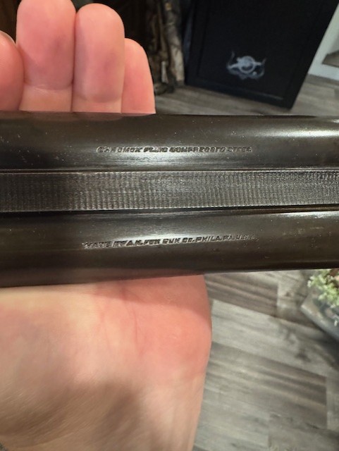

Hello everyone. My dream gun has always been a Super Fox. I came across one recently, but I am curious because it doesn't have the "H" stamp on the barrel flats. Instead it has an "I" stamp. Everything else looks good. 32" O weight barrels, all matching serial numbers, the right engraving. They also have the stamp on the flats that says the barrels aren't guaranteed. I even measured the receiver at the breech balls and it is considerably larger than a normal 12 frame. Or larger than my A grade anyway. It is also a philly gun. Has anyone ever seen anything like this? I need to get a letter on it for sure. I'll attach some pics. Thanks!

Looks like a Super-Fox to me. Why it doesn't have an H stamp is anyone's guess. They were made by human beings. Order the card from the AHFCA and/or get a letter on it from Cody --

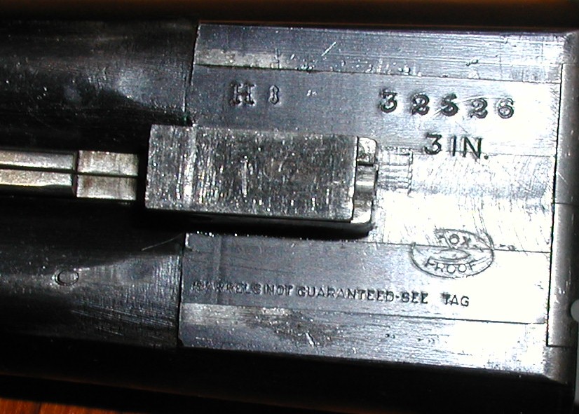

Checking my files I see 27837 has the H to the left of the dog-bone symbol --
as does my 3 IN. Super-Fox --
