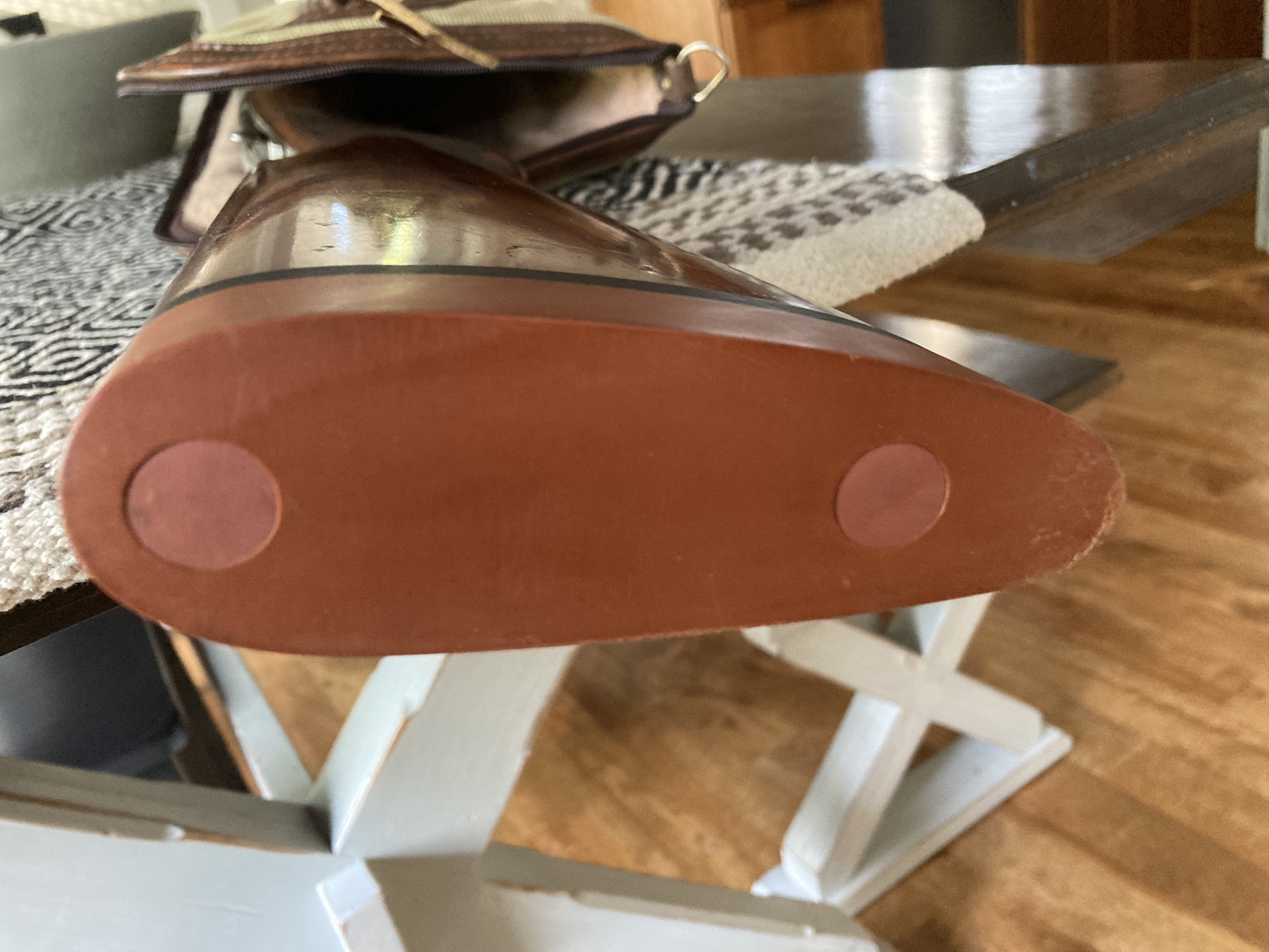

I have a Fox gun w/a Silvers type pad on it. One of the screw hole plugs is loose and wants to slip out while in use. Were these plugs simply friction fitted or were they glued/attached by some other means. What the best way to assure fitment without making a mess of the pad and making it accessible for future removal. Thanks Brett

The screw plugs on repro Silver's type pads typically don't fit as tightly as in original S W Silver & Co pads, and besides yours seem to be a different color shade and may have been changed out with plugs from a different repro pad. There’s a small variation in diameters between makers. I've seen where people have put a wrap or two of Scotch tape around the circumference of ill fitting plugs to increase their diameter for a tighter fit, and actually painter's tape might be better owing to a better friction coefficient. Personally I wouldn't use any sort of glue that might cause me to gouge into the plug-pad interface when trying to remove if/when the pad shifts due to shooting and I need to tighten the screws or otherwise secure it from shifting positions. I say that because tyro pad fitters often use screws with shanks that are significantly undersized for the holes in the pad base. frank

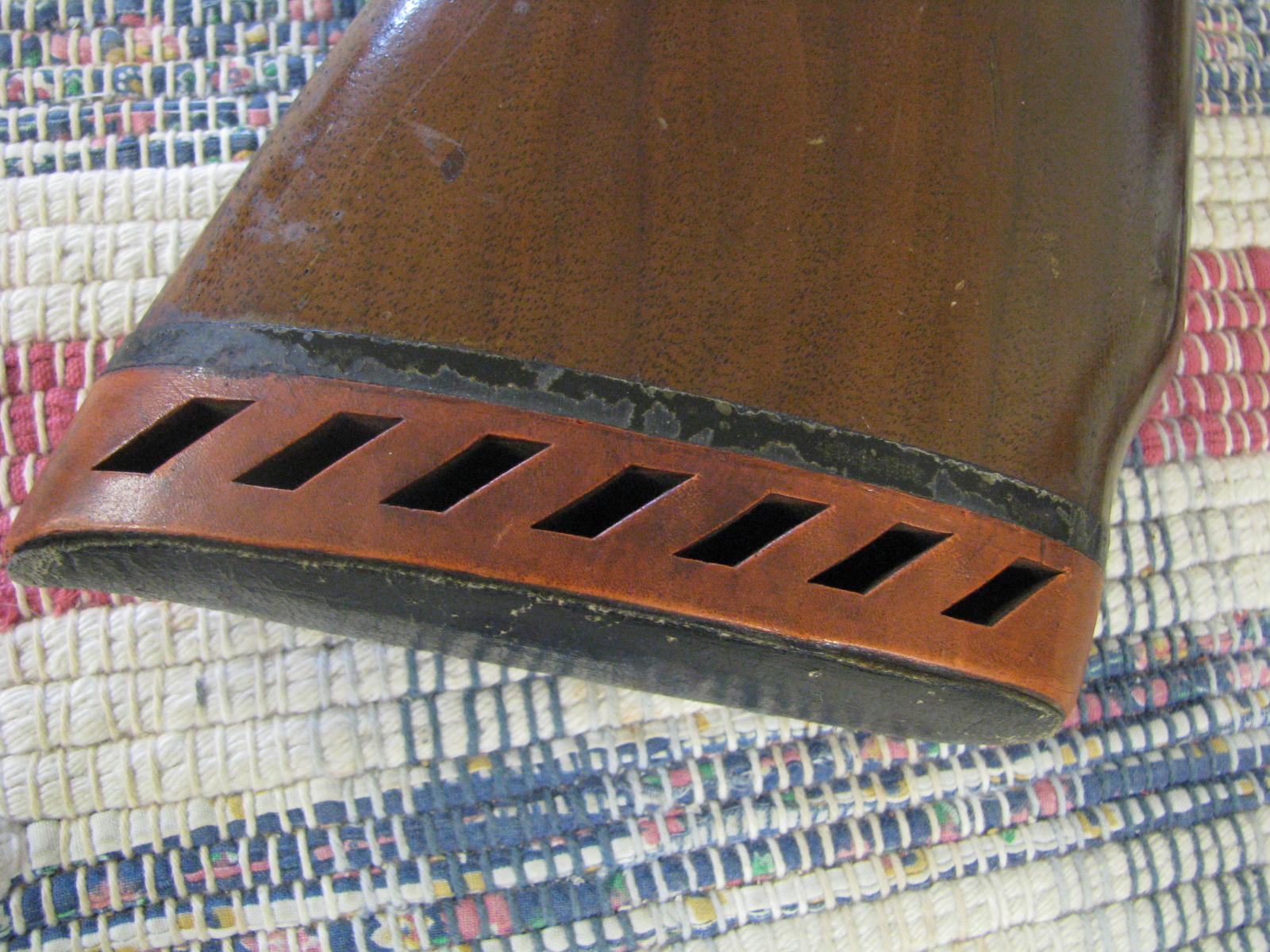

I like leather facings for Foxes and Stan's suggestion is excellent as long as the pad doesn't shift to and fro when shooting, which it shouldn't do if properly mounted. Even a few thou proud on one side and undercut on the opposite looks bad and will keep you having to reposition and tighten the screws. Just for show, I'm reminded of the Jostam 7-slot pad and its leather facing that was on my CE Fox "Matilda" when I got her 17 years ago. She was once owned by Harry Overbaugh the Fox factory Tournament shooter and principal who ran the company's display at the 1915 Worlds Fair/Panama Pacific Exposition in SF in 1915. frank

Silvers wrote: ↑Sun May 12, 2024 1:23 pm The screw plugs on repro Silver's type pads typically don't fit as tightly as in original S W Silver & Co pads, and besides yours seem to be a different color shade and may have been changed out with plugs from a different repro pad. There’s a small variation in diameters between makers. I've seen where people have put a wrap or two of Scotch tape around the circumference of ill fitting plugs to increase their diameter for a tighter fit, and actually painter's tape might be better owing to a better friction coefficient. Personally I wouldn't use any sort of glue that might cause me to gouge into the plug-pad interface when trying to remove if/when the pad shifts due to shooting and I need to tighten the screws or otherwise secure it from shifting positions. I say that because tyro pad fitters often use screws with shanks that are significantly undersized for the holes in the pad base. frank
Frank,
Thanks for feedback. You are correct the plugs are a lighter color and have probably been replaced. To your point on using a glue that was my concern. How would I remove if ever needed to. I do like the idea of a tape to tighten the plug fitting. The pad is securely and properly attached to the butt.

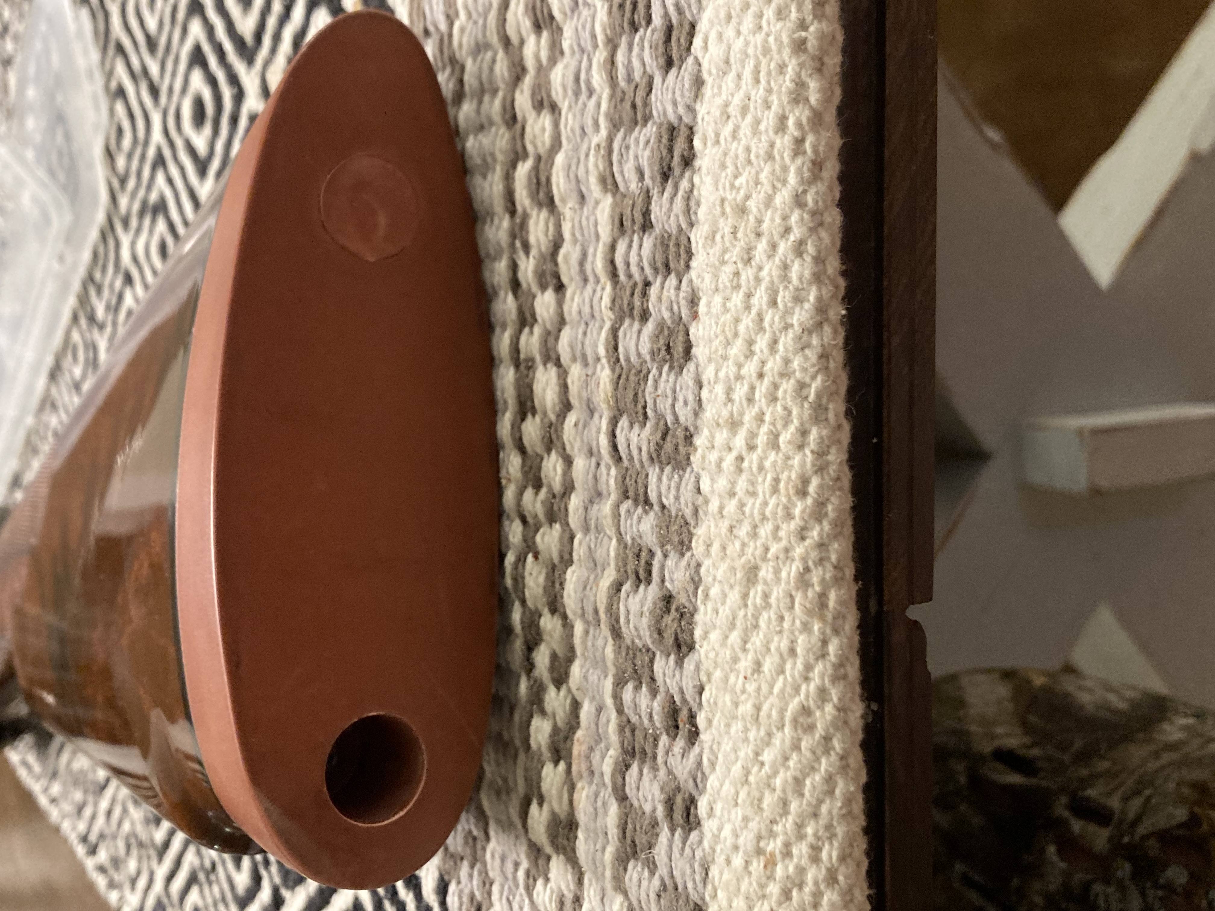

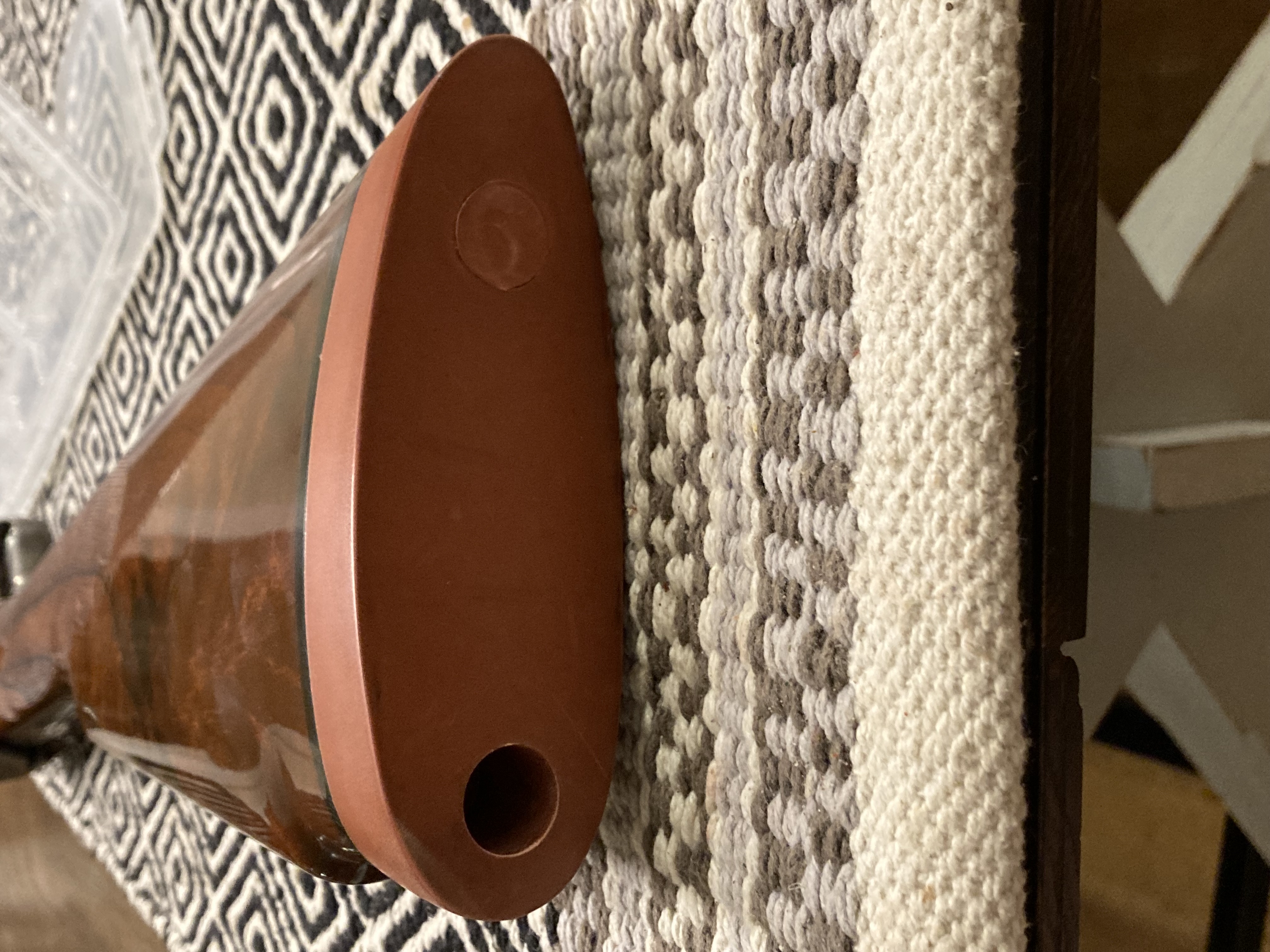

Brett, if you post a pic of the back end of the L Grade pad along with diameter of the hole, I'll look in my box of pad plugs and if I have one or better yet two matching plugs I'll be happy to give it/them to you at Hausmann's. frank

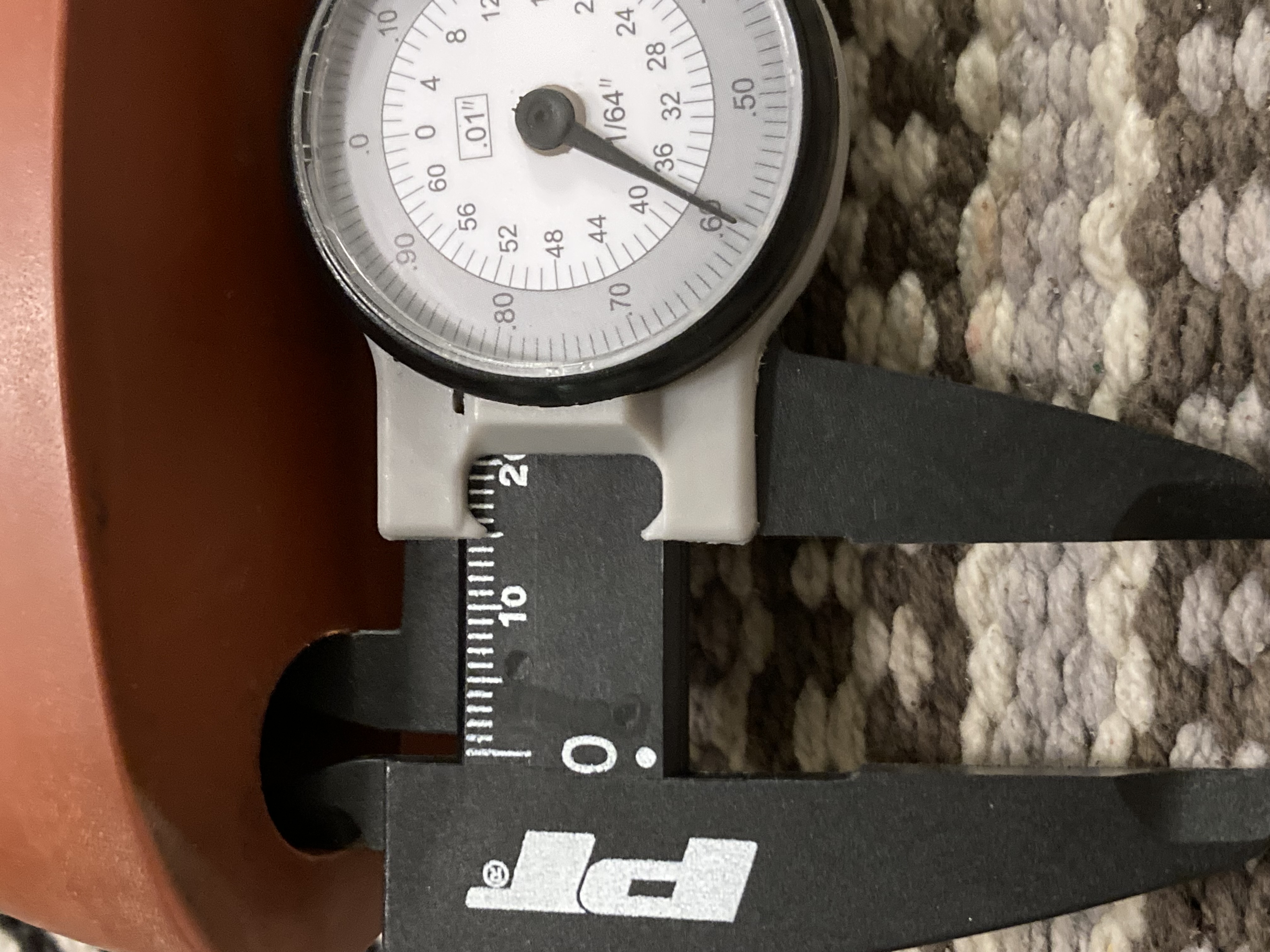

Here is pic of SBT gun w/Silvers (or Silvers type) pad. Diameter of hole is 19/32’s (15 mm).
