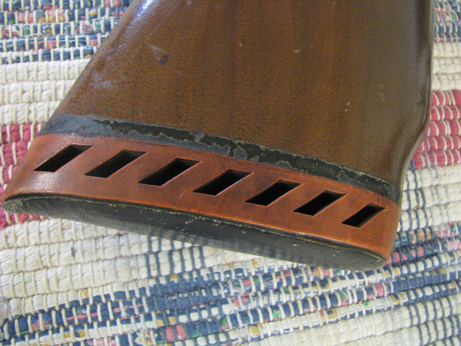

Re: Not so technical question - butt pad screw plugs
Here is pic of SBT gun w/Silvers (or Silvers type) pad. Diameter of hole is 19/32’s (15 mm).
