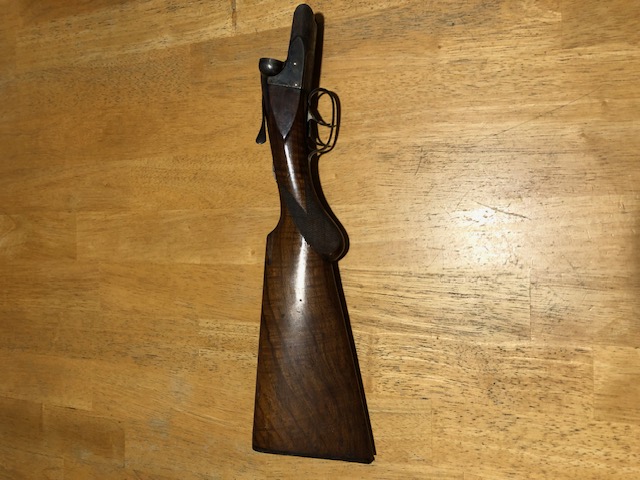

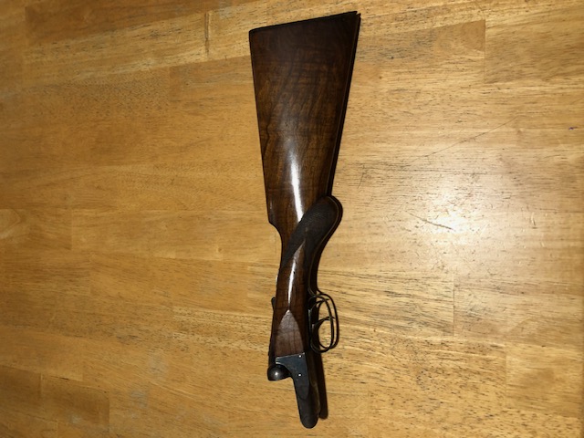

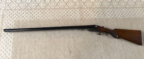

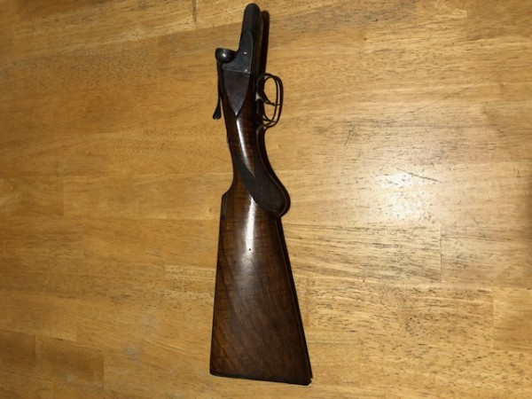

Good morning. My son was given this gun. It is in nice condition but is missing the forend. We took some pictures of it today. He has sent for the factory paperwork on the model. The serial number is 18602 A. He found someone who could sell him a forend, but a good gunsmith to work on it. We live outside of Baltimore. We are unsure if it is worth the time and effort.

I uploaded some of the pictures.
I have two questions. Is it worth getting it restored? Do you know of a good gunsmith near Baltimore?

Good afternoon, Ken. I was able to open your pictures and take a look at your son's Fox. The pictures are not terribly clear, but to my eyes it looks like a reasonably nice, "1st generation" AE. These guns were produced from 1906 thru 1913. This one was produced towards the tail end of that era. In the pictures, the frame looks rather dark, but I think that's just the lighting and the case colors. I hope that no one "blued" the frame. Based solely on your pictures (without handling the gun) I would say that there is no reason to restore the gun. What I mean is, it looks nice right now (love the half pistol grip). Plus, the cost of restoring this gun would exceed its finished value. It doesn't need restoring, it just needs a forearm. Now, regarding purchasing a forearm. Your gun left the factory as an AE, meaning that it has ejectors. If you buy a forearm, PLEASE make sure that it has ejectors. If you can find a forearm, we would all like to see your son out on the clays course sometime. Jeff

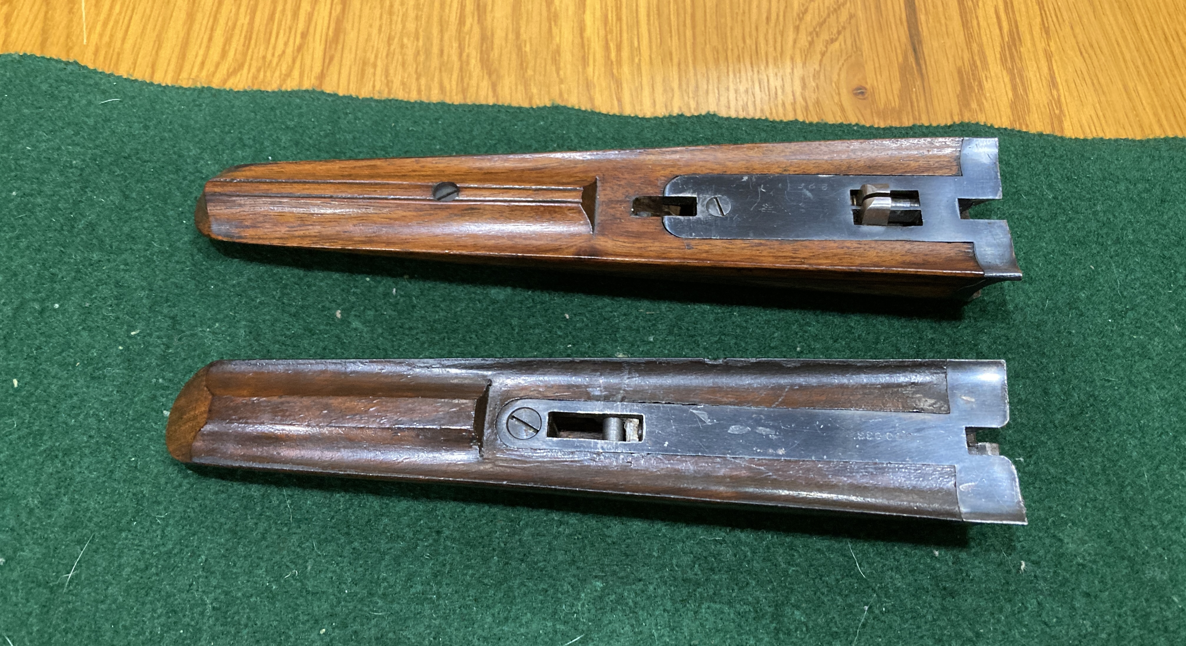

The forearm on the top is from an ejector gun. The forearm on the bottom is from an extractor gun. Big difference!!!

Thanks very much!. The stock is nice, and the pictures are not the best. The stock is not blued. It has some nicks and scratches, but it's not bad considering its age. My son found a forearm for the gun (yes, it is an ejector). We would need to find a gunsmith to marry the forearm to the gun. Not sure It is something he or I would be comfortable doing.

Here are 3 of the pictures
