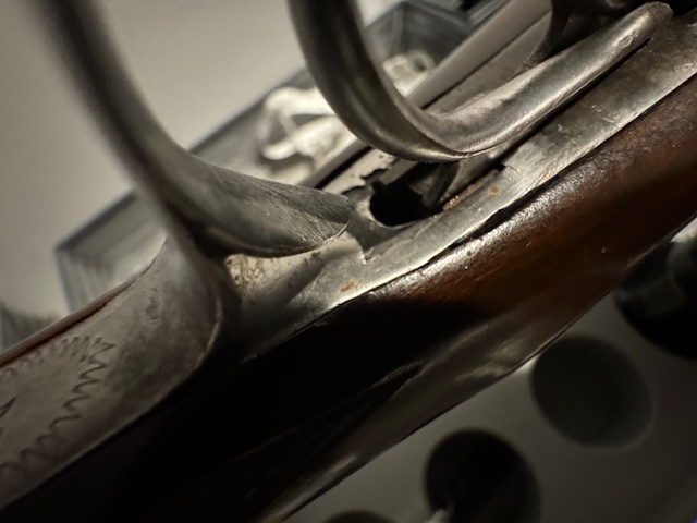

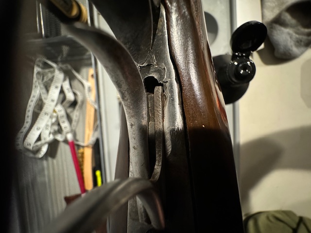

Thank you for the response. It looks like mine has been tampered with. Could a smith fit one from another gun, is there any companies out there that would be able to fabricate the same piece ? Just asking so I know how I should proceed with this project. Thanks again for any info or advice.

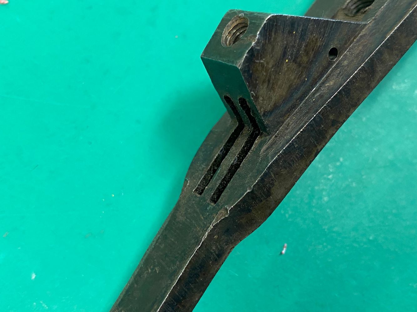

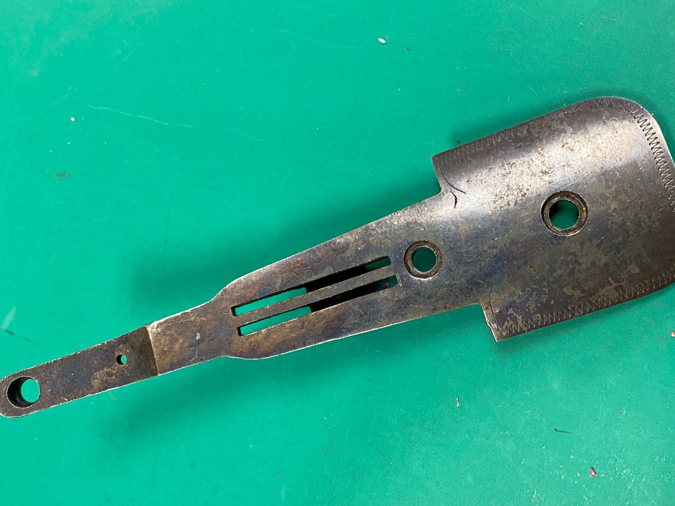

Re: 16 gauge trigger plate question
Wow it sure looks like someone had to work at bending that plate and gouging/drilling (?) a hole through it! I wonder what the plate and mechanism look like inside? Assuming no major internal damages and from what I can see ..... the plate can be straightened somewhat, that hole filled and microwelded, re-machined, and surfaces dressed to form and then faux colored. Anyway, that's what I'd do if it were my A grade 16 Fox but sorry I don't do work on commission. And because of doing my own Fox mechanical work I don't have any experience with good Fox 'smiths or even Sorcerer's apprentice type 'smiths. Possibly one or more of our members will step up with a gunsmith recommendation from personal experience.
Just for info here's what an unmolested AH Fox trigger plate looks like. In the second pic check out the thickness of about 1/4" where that hole shows behind the trigger blade slots. It took some force to bend the plate in your pics. frank

Wonder if at one time the OP"s gun had an after-market single trigger, such as an Infallible or an E.D. Fulford, both of which have a screw in that area, and at some point in time was restored to double triggers?

Researcher wrote: Sat May 04, 2024 5:17 pm Wonder if at one time the OP"s gun had an after-market single trigger, such as an Infallible or an E.D. Fulford, both of which have a screw in that area, and at some point in time was restored to double triggers?
I just recently found out this is exactly the case.
