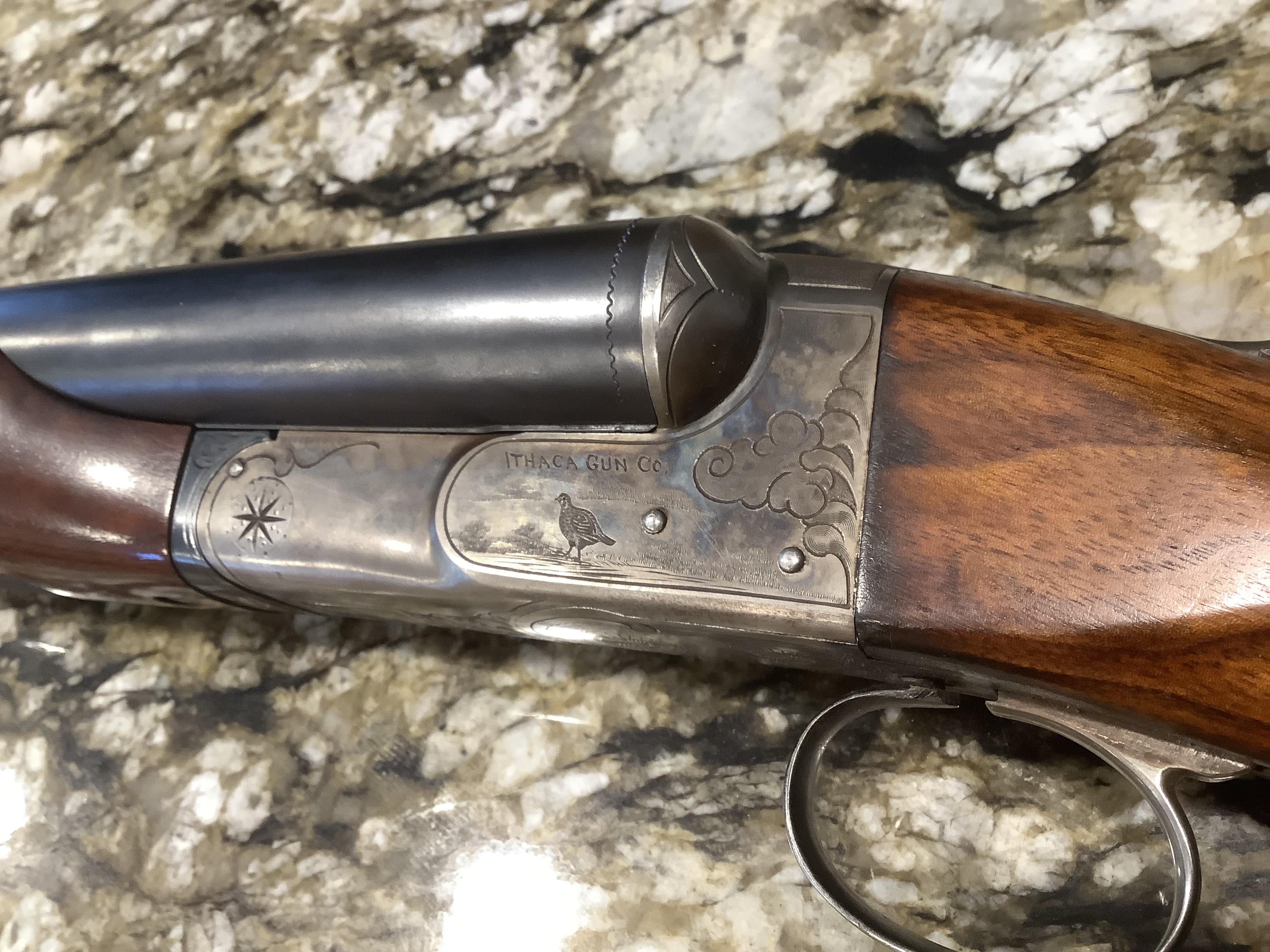

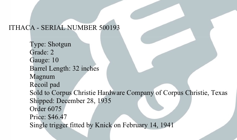

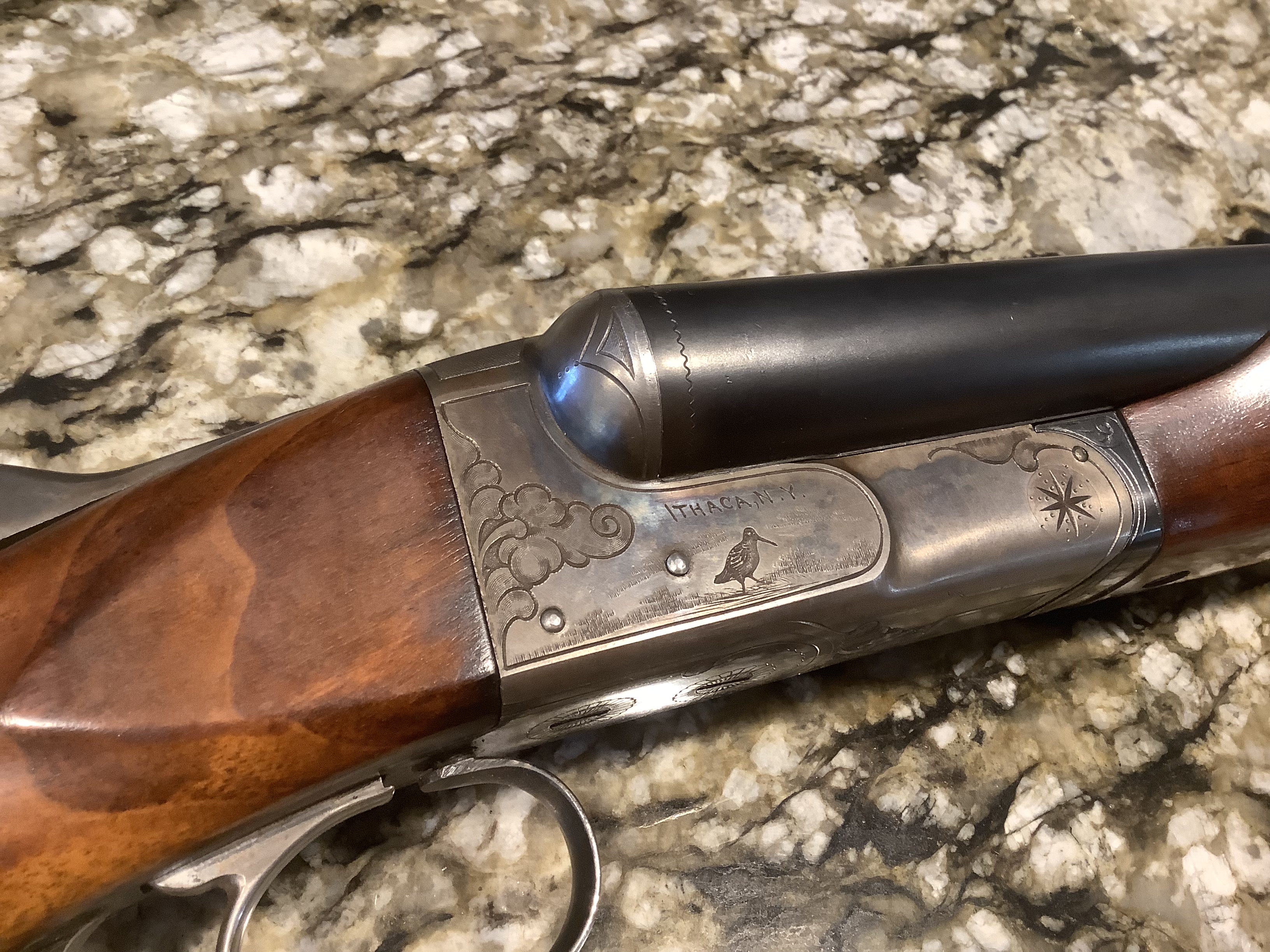

Thanks guys for the great feedback. Mr May thank you especially for chiming in. The 4 guns were with modifications to a single trigger 2 were Parker’s one was a Fox, and the most recent one an Ithaca. 3 of these were 32” guns so there may have been a reason why they had the trigger set in the rear position possibly providing additional clearance for the trigger finger.
I have 7 guns from a variety of manufactures that I want to pull out of the safes and look at their positions. I can honestly say I never had given much thought to these single trigger gun an the position of the trigger until most recently. Now that I think about it I actually order an RBL and an A-10 American with a single trigger and don't recall if I had a choice in position.
My hats off the Dan for running a company that has been in business and turning out Professional work for over 100 years. Offering customers a choice in how they want their trigger set up.
I have attached a picture of the Ithaca 10 gauge Magnum with the single trigger installed at the factory.
