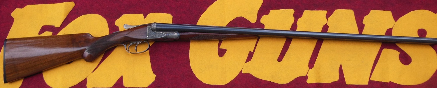

If it came from the factory intended for 2 3/4-inch shells the chamber would be 2 5/8-inch. I have an AE-Grade 20-gauge from 1920 that was ordered for 2 3/4-inch shells and it has 2 5/8-inch chambers.
