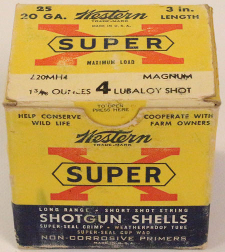

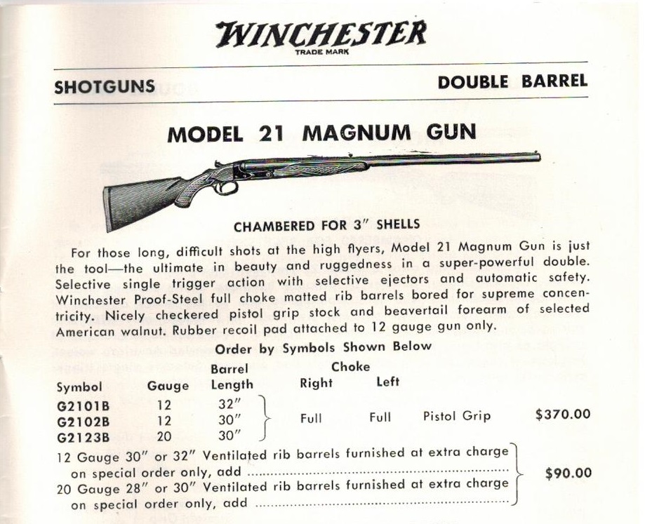

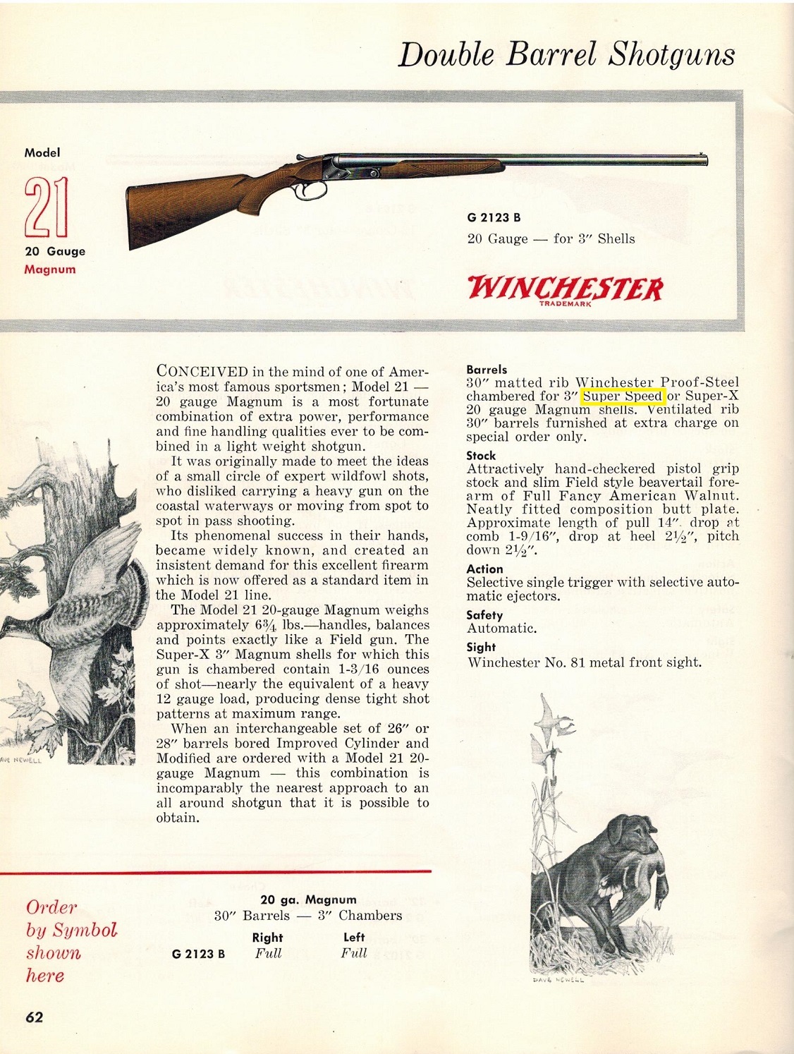

Yet it was the Olins of Western Cartridge Co. that introduced the 20-gauge 3-inch Magnum in 1954.
When introduced, the only brand of ammunition cataloging the 3-inch 20-gauge Magnum loads was Western Cartridge Co. and they only offered two loads, both with Lubaloy shot -- L20M6 with 1 1/8-ounce of shot --
Super-X 20-gauge, 3-inch, L20M6.png (562.03 KiB) Viewed 5193 times
and L20MH4 with 1 3/16-ounce of shot --
Super-X 20-gauge, 3-inch Magnum, #4 Lubaloy.jpg (89.97 KiB) Viewed 5193 times

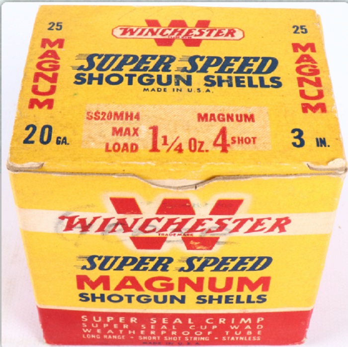

Even though the big 1955 Winchester gun catalog lists Super-Speed no Winchester ammo catalog from 1954 to 59 I've seen lists such a load.

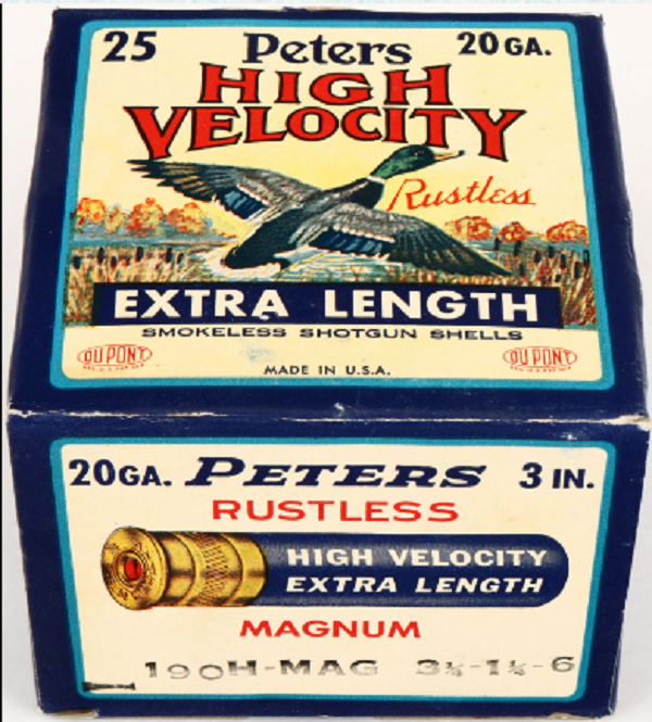

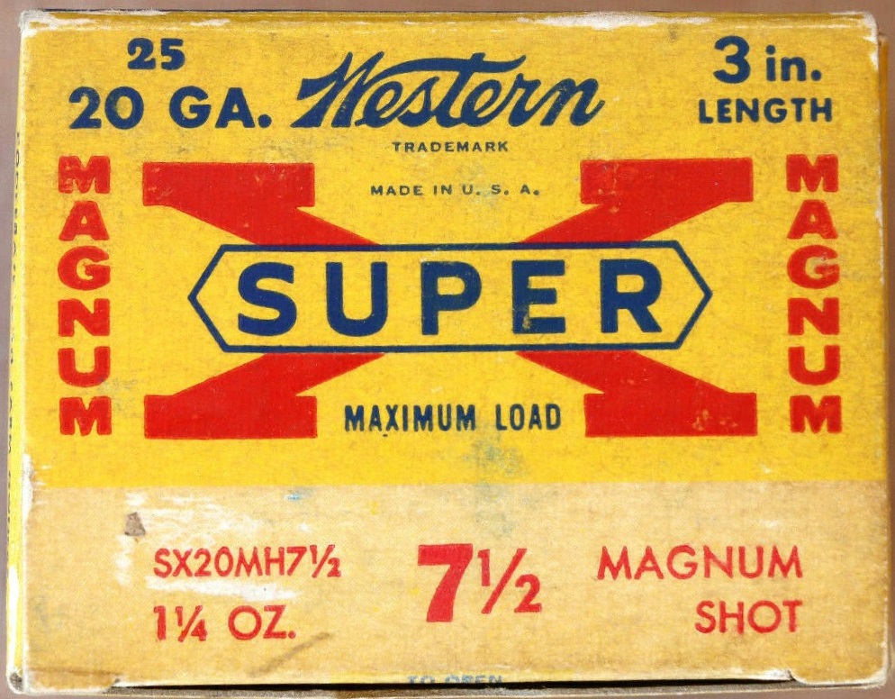

For 1960 all four big ammunition companies cataloged the 3-inch 20-gauge magnum with 1 1/4 ounce of chilled shot.
REMINGTON EXPRESS 20-gauge, 3-inch Magnum, #4.png (405.81 KiB) Viewed 5193 times

My 20 gauge M21 was made in 1953, 1 year too early to be chambered for 3 inch. Jim
Posts: 6253
Has thanked: 483 times
Been thanked: 2498 times
Re: Ammo question
From the introduction of the Model 21 through at least 1946, one could order the option of 3-inch chambers for any gauge. The 3-inch chambering option in the 1950 through January 1955 Winchester catalogs states 12-gauge only. From September 1955 through 1959 the listing again states Chambering for 3-inch shells with no gauges mentioned.
The January 1954 Winchester catalog is just when the Model 21 Magnum Gun in 20-gauge became a catalog symbol item.
