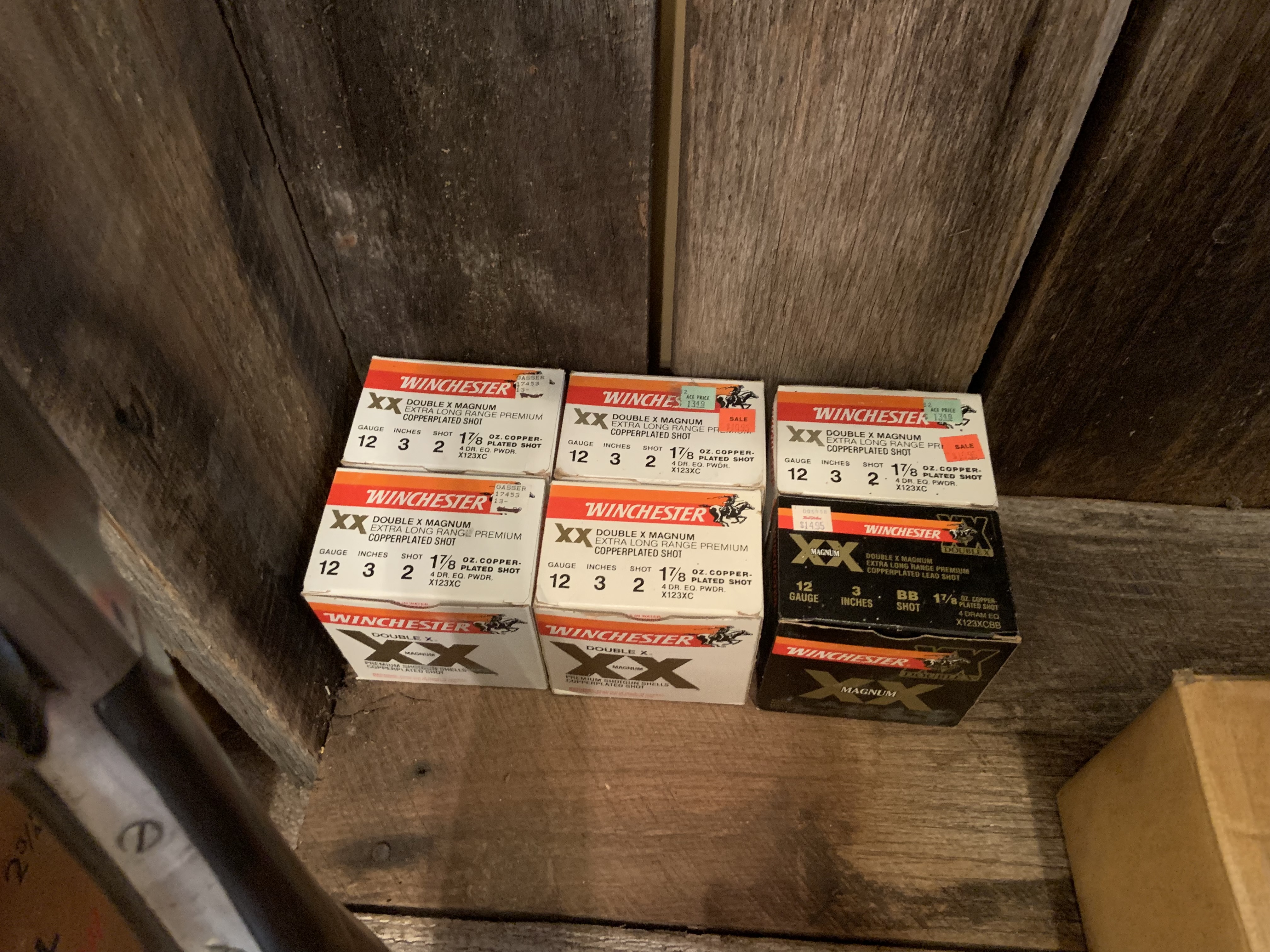

Frank, slight change of subject, but a subject that you may find interest in and have knowledge of. OK, I have two boxes of 3" 1 7/8 ounce lead loads from just before the steel shot panic. I would like to pattern these in some Super Foxes with 3" chambers for research purposes. Are these 1 7/8 ounce loads too much for the Super Fox?

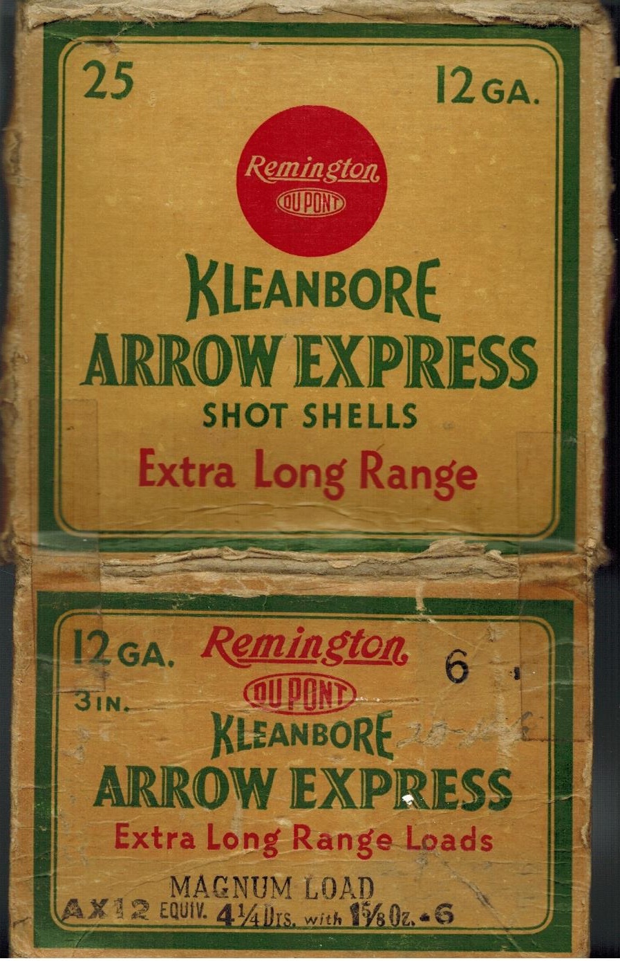

When I got my Super-Fox back in 1963, it came with three boxes of post WW-II Remington ARROW EXPRESS 12-gauge 3-inch Magnum shells #4, #5 and #6. I still have the #6 box and half the shells.
Shot the rest of them up.
With youthful enthusiasm, after I found Nash Buckingham's September 1955, Outdoor Life article "Magnum Opus" the summer of 1966 while working for the Forest Service and realized what I had, I shot a lot of patterns with new WW Mark-5 1 5/8-ounce loads. Got beautiful patterns, some #5 went 85%. When I tried some of the 1 7/8-ounce loads they were quite patchy.

Dr. Drew and Dave Noreen, thank you for all the early research, but none of it answers my question. I still have the question in my quiver. Maybe Frank will help. Thanks.

Bill, I’m familiar with the 12 ga/3-inch factory load with 1-7/8 ounces of lead shot, and have fired a ton of them in earlier years through a variety of guns to include a Browning Auto 5 Magnum, several Remington 1100 Magnums and two Benelli Super Black Eagles. As you know the shell is a boomer. I’ve never fired any of them through a Super-Fox and wouldn’t do that. Reason being that I limit my vintage guns to period equivalent loads, and the heaviest period 3-inch load during the era of the Super-Fox (late 1922 to about 1940) was the 3-inch/1-5/8 ounce load that was intro’d in 1935 along with the Winchester Model 12 Heavy Duck pump gun. With that said I often load my Supers with the current Federal 1-5/8 ounce load for turkeys and predators, and they fire and pattern well. Recoil is heavy in my heaviest Super weighing just shy of 9 pounds. Again I don’t have any personal experience with 1-7/8 ouncers in Supers and would caution against firing that load as it was developed well after the last Super-Fox was shipped from Utica. frank

Bill,
What vintage are the ounce and 7 eighths? The White boxes were what was current production in 1985-89, the Brown are newer.
I can tell you from experience that the Super Double X's of the day (pre final lead ban) were more than I could stand fresh out of college in a break action gun.
Nearly broke a finger and a collarbone at the same time through a Citori!
In fact I believe it was this day!!
I would be ashamed to tell you the short mag load we had with 571 or Blue Dot, nothing compared to that punishment even through an 870.

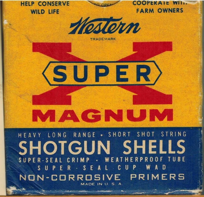

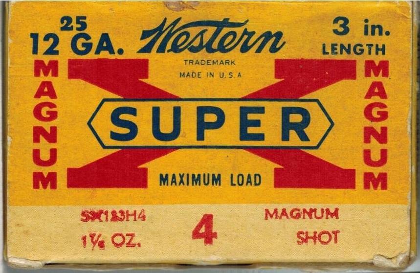

The Western Cartridge Co. December 22, 1956, ammunition catalog only has the 1 3/8-ounce and 1 5/8-ounce 12-gauge, 3-inch, Super-X. The January 2, 1958, Western Cartridge Co. ammunition catalog includes the 1 7/8-ounce load in both chilled and Lubaloy shot. So, the 1 7/8-ounce loads first appeared in the blue & yellow boxes --
Same with both Remington and Peters. Not in the December 31, 1956, ammo catalog, but in the January 8, 1958, ammo catalog.
