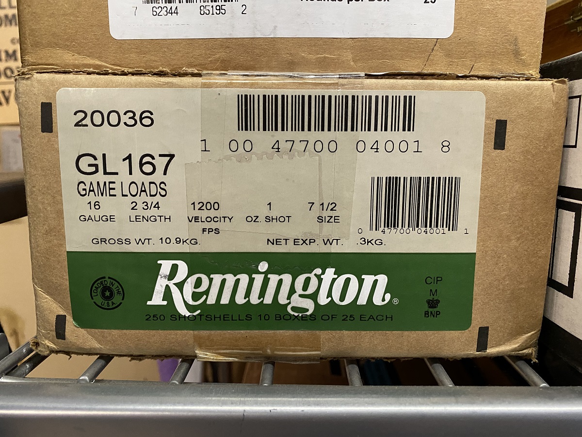

For years I shot the 16-gauge Remington Game Loads when they were marked 2 1/2 drams equiv., 1 ounce, and was quite satisfied. Then I got two flats that were marked 1200 fps and they seemed pretty harsh even in fairly heavy guns. I then came into a bunch of purple Federals and those are the hulls I've been reloading with the 7/8 ounce in the Down Range wads.
https://www.gunsinternational.com/guns- ... =101596400
I originally misspoke above by saying 2 3/4 dram equiv. I went to the old Remington catalogs and the 16-gauge Game Loads were 2 1/2 dram equiv. through the 2002 Remington catalog. They started listing them at 1200 fps in the 2003 Remington catalog.

Them shells are a tad expensive for sure. Just looked and many are labeled 2 1/2 dram 1 oz 16 gauge. Seems to be pretty light load. These are more like 20 years old.Researcher wrote:For years I shot the 16-gauge Remington Game Loads when they were marked 2 3/4 drams equiv., 1 ounce, and was quite satisfied. Then I got two flats that were marked 1200 fps and they seemed pretty harsh even in fairly heavy guns. I then came into a bunch of purple Federals and those are the hulls I've been reloading with the 7/8 ounce in the Down Range wads.

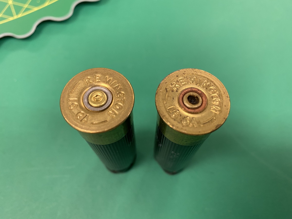

I've used and have been happy with these Remmy 16-gauge Game Load shells for many years. Incidentally 1-ounce at 1200 speed in 16-gauge is almost but not quite a 2-3/4 DE shell.
Then about 2 years ago was running low and bought 3 flats from an on-line company for something like $75. per, plus a small flat rate shipping fee. Several months later I got into a new flat and started getting lots of pierced primers while clays practice shooting with two Foxes and a Model 12 pump gun. I saw that Remington had switched primers (see last pic). I called to Remington Cust Service in Lonoke and talked with a gal who asked me to send some pics, and several days later she emailed back, she was sending three Fedex call tags and to return all the shells for replacement. I due course I got three replacement flats but some of the boxes had regular Remington primers and others had the replacement that was prone to piercing. I called back and the contact gal said she'd investigate and get back to me. She replied and said that's all they had, no more in inventory and the new production run is "seasonal" and wasn't scheduled until the next year in anticipation of dove season. So much for modern just in time production.
Since then I've sorted out the shells with Remington primers and use them in my double-guns. And I had a spare firing pin for that Model 12 Winchester and shortened it so I could use the alternate primers with the copper colored outer ring without them piercing. As i recall I shortened that firing pin tip by about 20 thou.
Long story and I suppose it macht nichts as old stock 16 ga Game Loads are just about dried up and as posted by Dave the scalpers are out there for those desperate for 16 shells. Also, Federal the new owner of Remington is just now trying to start up the Lonoke ammo plant and who knows what they'll be making in 16-gauge? Hopefully it will be in a compression formed unibody hull and not with a separate base wad. Anyway I'm happy I kept all those black colored empties. And now you know one more reason why I'm getting into reloading for 16's.
newer primer on the right
