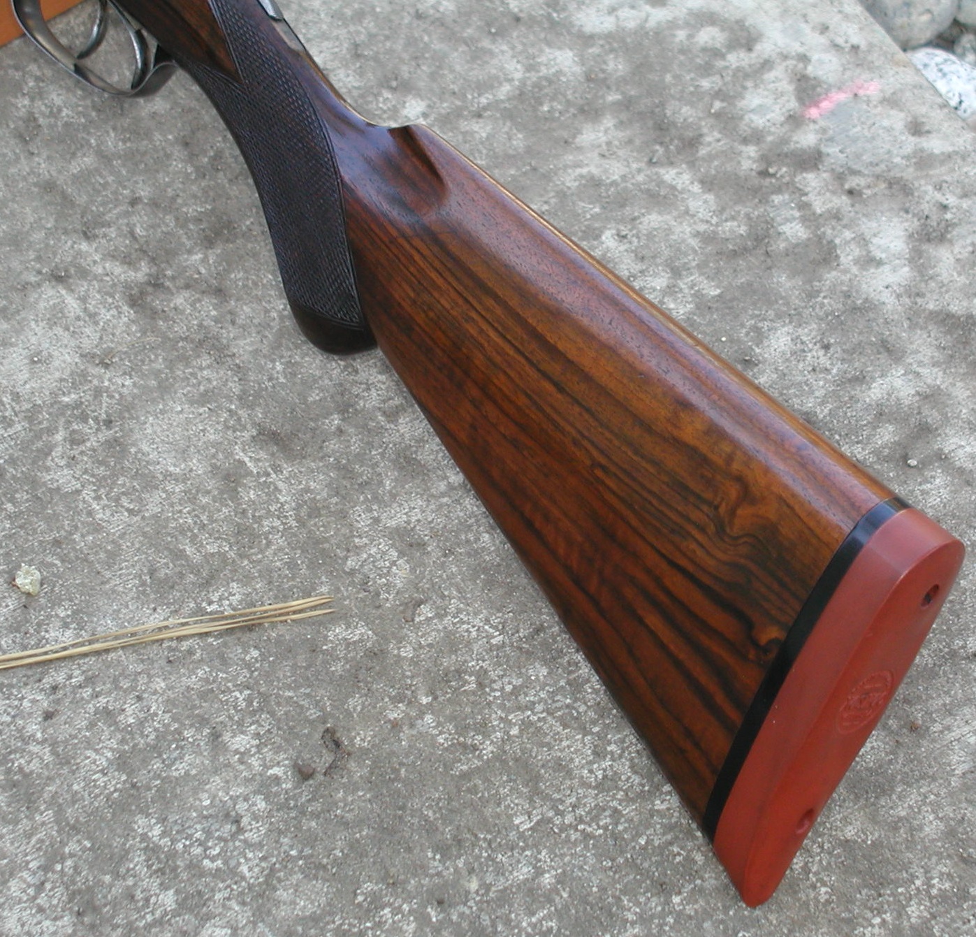

I agree with Craig on both accounts, and ended up with this one on my AE 16 several years ago. It's a great little pad that I bought from Mark Beasland, if I am not mistaken. As you can see the face is not perfectly flat like a regular Silvers pad, but is exceptionally comfortable and effective in usage.

Beautiful AE and the pad certainly compliments it. I had seen this curved type, but glad to know about it. Your help is much appreciated, Stan.

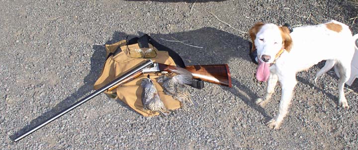

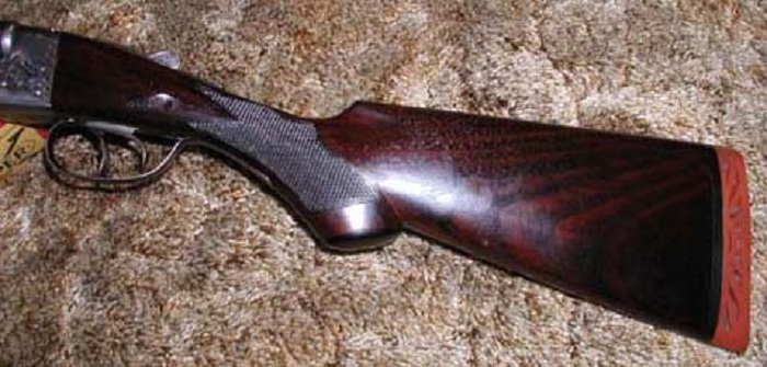

I like the look of the No-Shoc on a smallbore Fox. I replaced the Ithaca "bridge trestle" pad that came on my favorite Ansley H. Fox A-Grade 20-gauge with a NOS No-Shoc pad --
Then refit the Ithaca pad to an NID No. 2 28-gauge --
