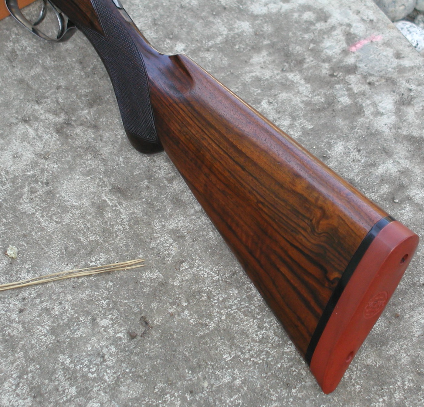

I agree with Craig on both accounts, and ended up with this one on my AE 16 several years ago. It's a great little pad that I bought from Mark Beasland, if I am not mistaken. As you can see the face is not perfectly flat like a regular Silvers pad, but is exceptionally comfortable and effective in usage.

Stan Hillis wrote: Sun Sep 03, 2023 7:31 am I agree with Craig on both accounts, and ended up with this one on my AE 16 several years ago. It's a great little pad that I bought from Mark Beasland, if I am not mistaken. As you can see the face is not perfectly flat like a regular Silvers pad, but is exceptionally comfortable and effective in usage.
Beautiful AE and the pad certainly compliments it. I had seen this curved type, but glad to know about it. Your help is much appreciated, Stan.
