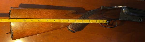

I requested and got some pics of the Sterlingworth in question. Can anyone identify what kind of pad (?) was on this gun? It seems to have worn away. I was wrong about the LOP...looks like it is exactly 14" from front trigger. So, if a Silvers pad is appropriate, I would be OK with a LOP of 14-1/2" if that's how it works out. I see some cheap "Sterlingworth" butt plates for sale on eBay but it's unclear how correct these are, and if they are made of metal, wood, or plastic.
Anything is OK for me (compared to how the butt is now), but If possible, I'd like a correct style pad if I go with this gun.
Thanks again for your help!

That is a replacement stock on that gun. The checkering pattern and the grip cap are not correct.

Really?! Well, I guess that is going to lower the asking price, isn't it? Thanks for the observation!
I suppose then, it doesn't much matter what the "correct" pad would be, and if I go with this, just choose whatever fits.
Curious... historically, was it common for owners (or sellers) to fit a new stock (which must entail some work) to a low-priced gun? From the look of it, as best I can tell, this re-stocking must have been done long ago.
