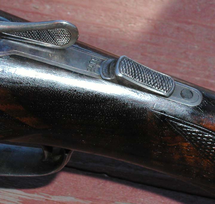

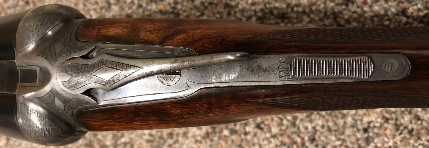

Re: Ansley H Fox safety operation
Send us pictures of the safety button in both positions. We may answer some of your questions. No markings at all may indicate that it was a safetyless gun with a safety installed later than its manufacture date.
Posts: 6257
Has thanked: 488 times
Been thanked: 2500 times
no ''safe'' marking on the tang,,
Perhaps this gun was originally built as a no safety gun, and has had an after-market safety added. Join the A.H. Fox Collectors Association, Inc. and get a card look-up for the gun and see how it originally left the factory.
