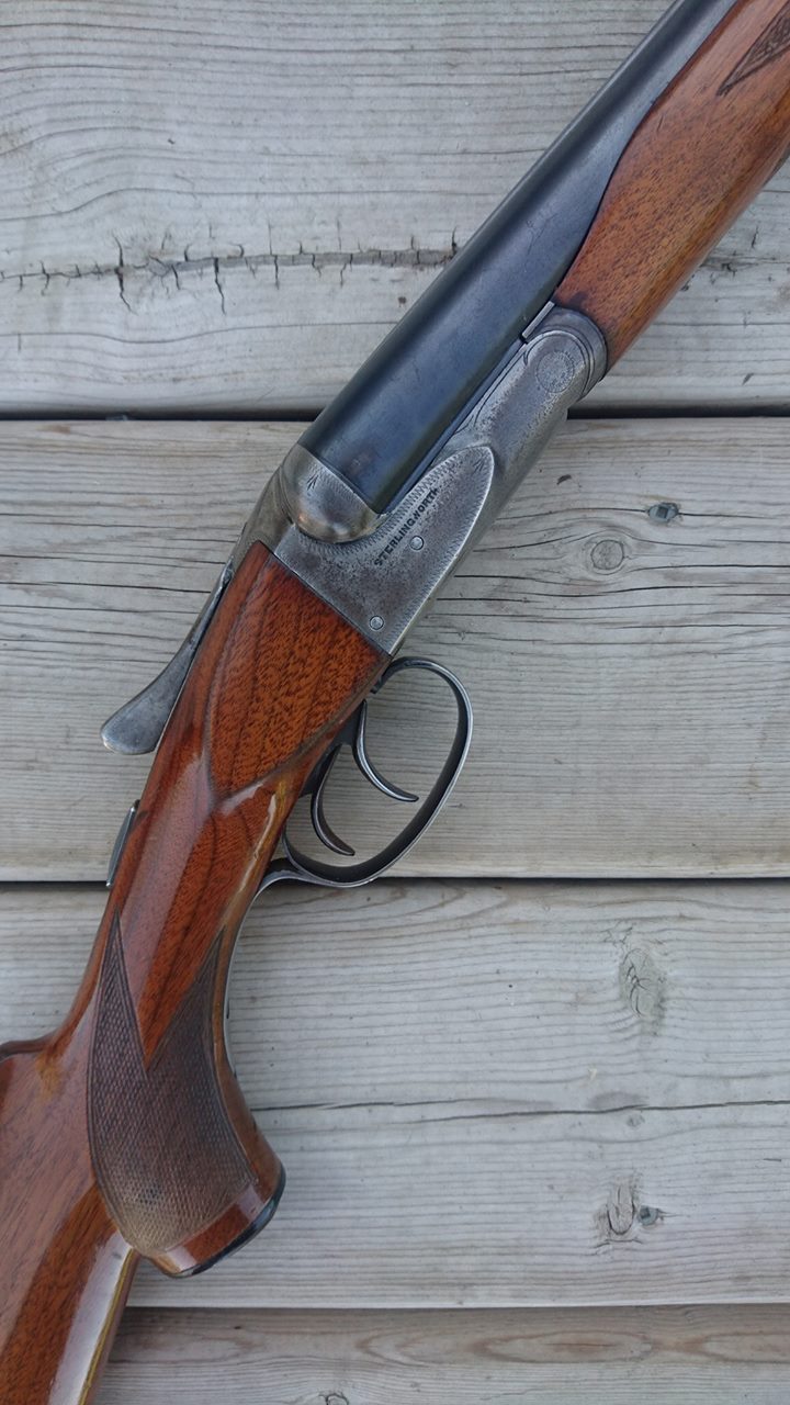

New to me... Late Philly 16 gauge Ejector Sterlingworth with 28" barrels and BTFE. Chambered 2 3/4". Choked M/F. Reblued but excellent bores. The bonus was a nice pair of snap caps. ;)

Do you think it's been restocked? Maybe it's just me but the pistol grip looks bigger and more pronounced than I'm used to.

To these eyes the gun in question looks like a total restock.

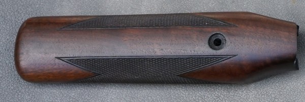

I believe this is a Philly gun but with a Utica BTFE. The barrels are stamped 2 3/4" CHAMBER so this gun was returned to the factory in the Savage era and perhaps then also fitted for the BTFE. The forend metal includes the factory "yoke" side wing extensions, and the wood is stamped with the matching serial number.
Yet another issue is why the checkering is off center from the escutcheon. Perhaps non-factory checkering?

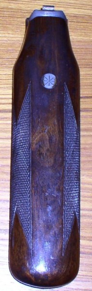

FWIW this is a beavertail on a 16-gauge Fox-Sterlingworth Deluxe Ejector Field that letters.
372747 original card
372747 Fox-Special card
372747 Beavertail inside
372747 Beavertail exterior
The interior of this forearm is more then a bit chewed, probably by whoever repaired the crack in the thin wood, long before I owned it.

Well my guess was confirmed after removing the stock. The head is stamped with the serial number and an "R" suffix. Which I assume stands for factory "restock". First time I've seen this.
