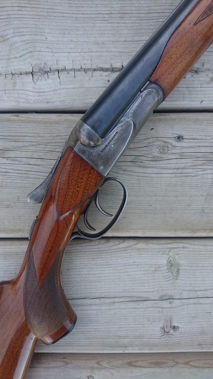

New to me... Late Philly 16 gauge Ejector Sterlingworth with 28" barrels and BTFE. Chambered 2 3/4". Choked M/F. Reblued but excellent bores. The bonus was a nice pair of snap caps.

How many of these did A.H. Fox build... Factory SW with BTF, I would think not many as they seldom/never come up for sale.....SXS Ohio

I owned a 20 gauge just like this one. I believe the BTFE was a Savage addition to the line. I understand they are hard to come by.

Do you think it's been restocked? Maybe it's just me but the pistol grip looks bigger and more pronounced than I'm used to.

From the 1931 catalog and price lists onward a beavertail forearm was an option on graded guns. The first mention of a beavertail for a Fox-Sterlingworth was in the 1935 catalog for the newly introduced Fox-Sterlingworth Skeet & Upland Game Gun. A beavertail was finally catalogued for a regular Fox-Sterlingworth beginning with the 1937 catalog.
Philadelphia era graded guns with beavertail forearms do exist. I'd been playing in the Ansley H. Fox game for over forty years before I saw a righteous Philadelphia era beavertail. I really doubt the A.H. Fox Gun Co. ever built a Sterlingworth with a beavertail forearm.
To these eyes the gun in question looks like a total restock.

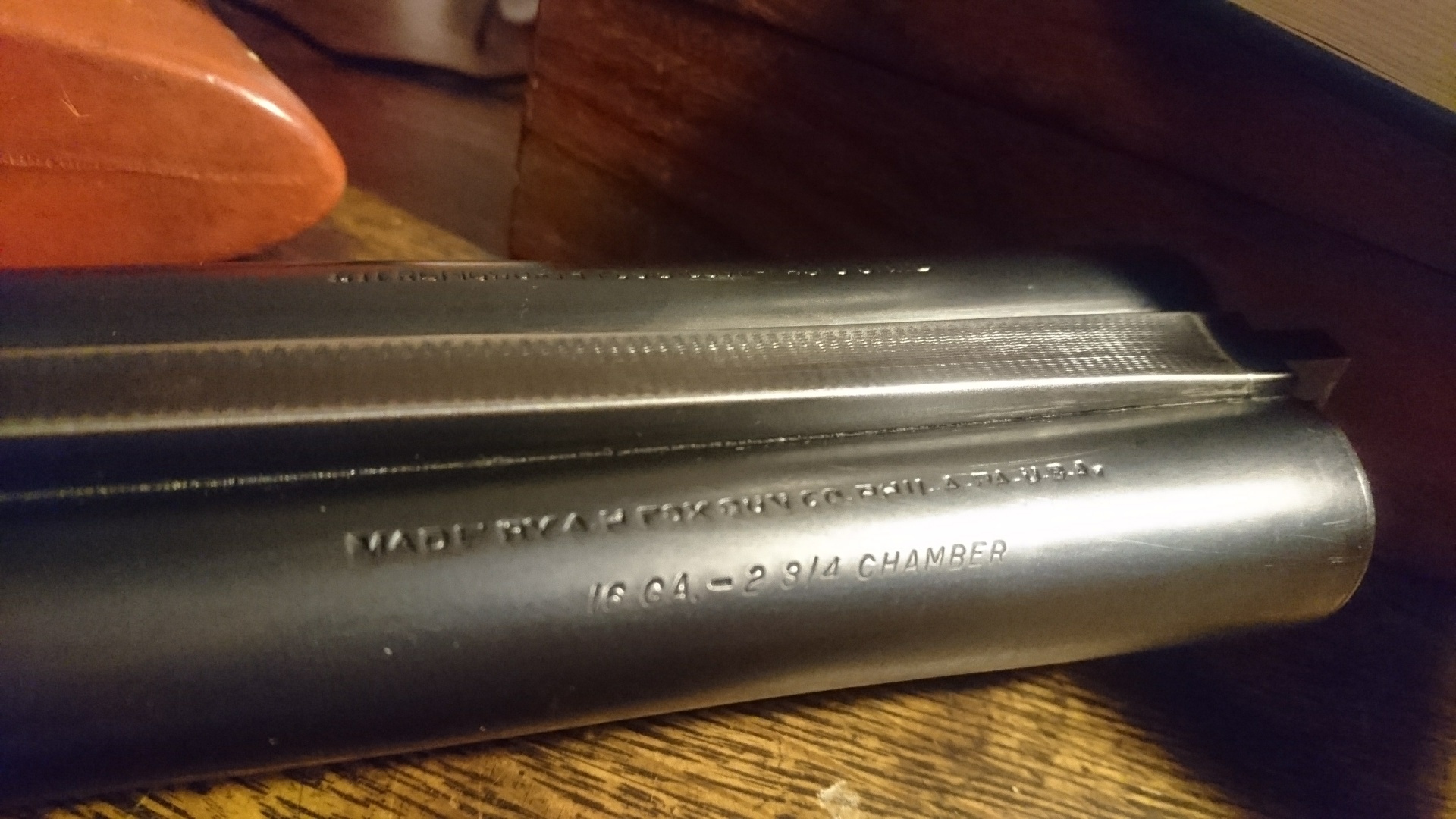

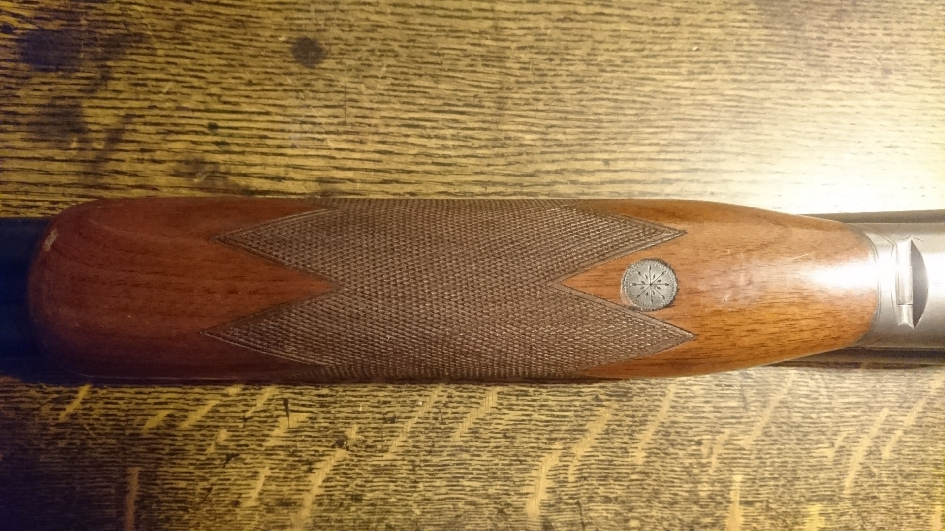

Re: Late Philly 16 Ejector Sterlingworth w/BTFE
I believe this is a Philly gun but with a Utica BTFE. The barrels are stamped 2 3/4" CHAMBER so this gun was returned to the factory in the Savage era and perhaps then also fitted for the BTFE. The forend metal includes the factory "yoke" side wing extensions, and the wood is stamped with the matching serial number.
Yet another issue is why the checkering is off center from the escutcheon. Perhaps non-factory checkering?

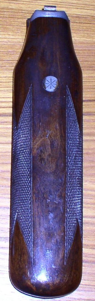

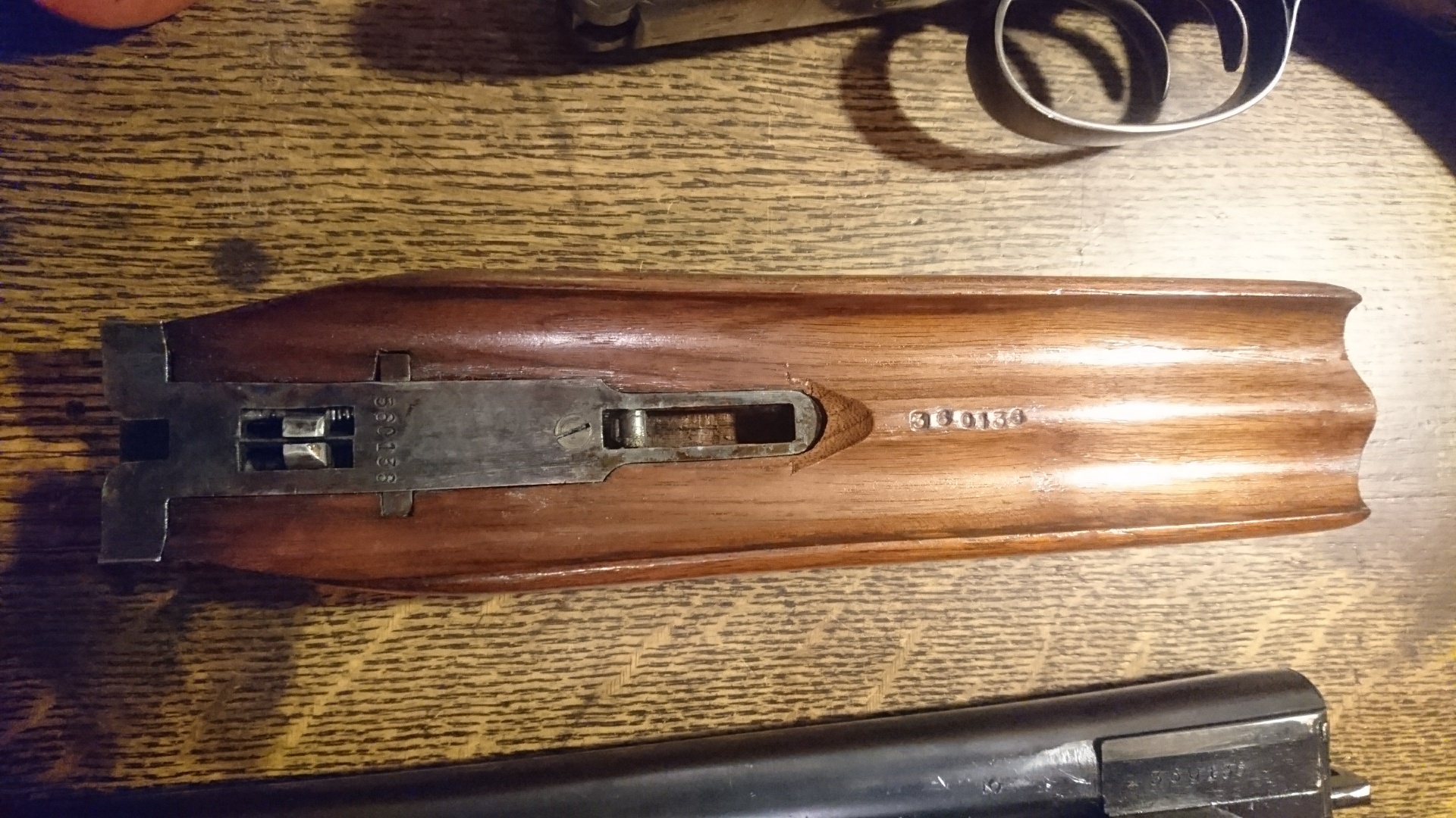

FWIW this is a beavertail on a 16-gauge Fox-Sterlingworth Deluxe Ejector Field that letters.
The interior of this forearm is more then a bit chewed, probably by whoever repaired the crack in the thin wood, long before I owned it.

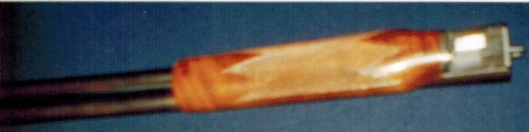

Finding pictures of documented beavertails is tough. Here is a scan of a very poor photo of an extra set of barrels with beavertail forearm fitted to a Sterlingworth by Savage in 1969.

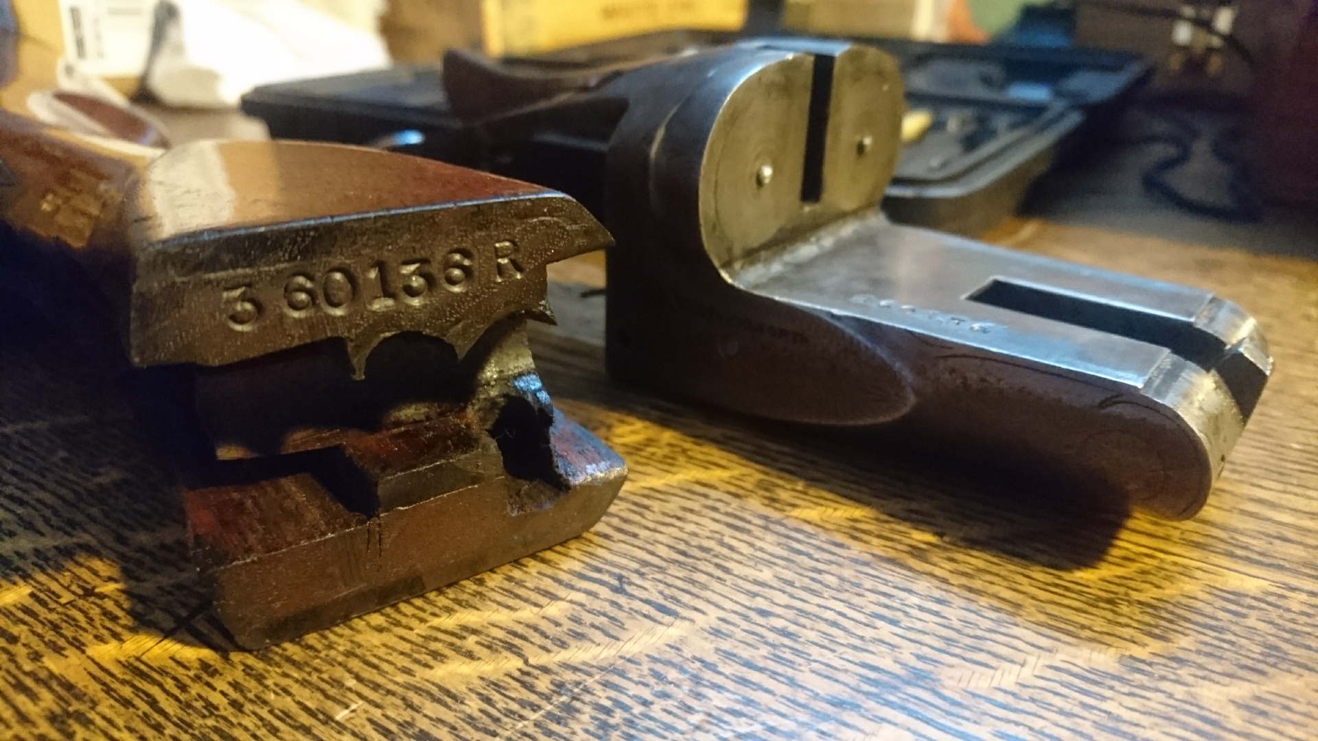

Well my guess was confirmed after removing the stock. The head is stamped with the serial number and an "R" suffix. Which I assume stands for factory "restock". First time I've seen this.
