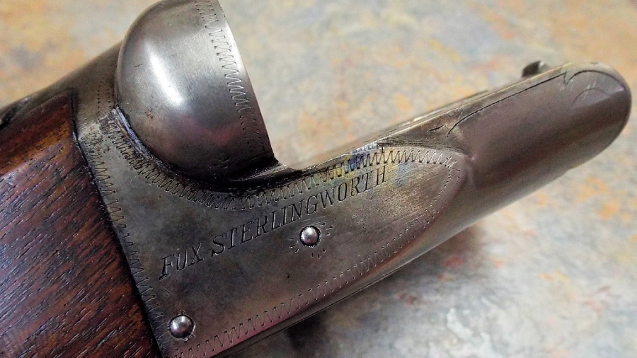

Looks different from my Savage Sterlingworth 20 gauge. Has anyone seen guns with this type of lettering before? I think it looks nicer. Looks like it has all the Philadelphia features,could this have been made shortly after the Savage take-over?

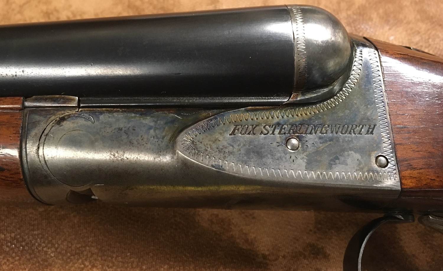

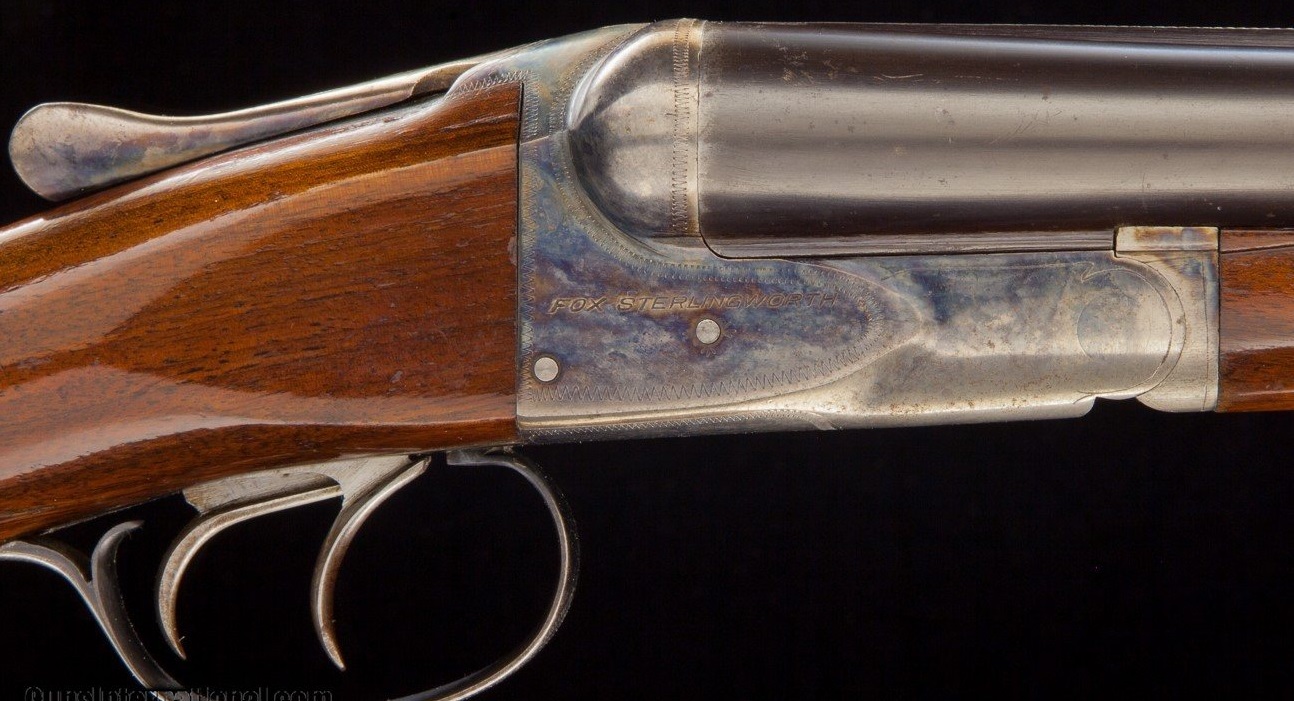

The guns with the large FOX STERLINGWORTH lettering seem to be in the 128xxx --
and 129xxx range --
By the 130xxx range we are back to smaller letters --
However, there are regular Philadelphia STERLINGWORTHs still in the 128xxx and 129xxx range. Also, I've recorded a nest of small letter FOX STERLINGWORTH Traps in the 1220xx range.

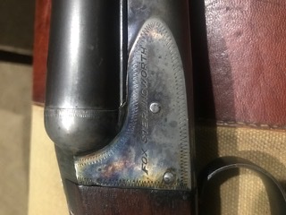

Here is a pic of Savage era 16 Ga. #367469 that appears to have larger stamping, although it is not the same script as the 12 pictured above.
