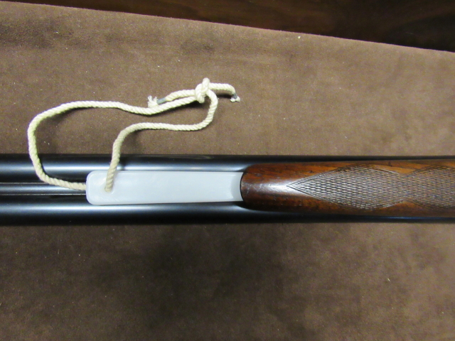

And you mentioned: "This gun has the early for end latch that is a bit hard to dismount, just like is reported in the Mackintosh book on Fox. "
You, and others with those tight fore ends, might want to consider The Dean Romig Fore End Removal Tool.
I have an early Model 1911 Sterligworth Pin gun with that difficulty. I bought one of Dean's tools and recommend it very highly. He has a pictorial presentation on the members side of the PGCA forum to see how slick it works.
I have mine pictured below. (You might wonder what that cotton line is with the metal ferrule at each end. For those that went thru the U. S. Navy boot camp you will recognize it. For those that don't, that is a USN cloths pin. In boot camp you tied your laundry to the clothes line with these. Just in case you wanted to know.)
And here is Dean's explanation:
"This tool is made of flexible nylon and should not mar the wood if used properly. It will easily and smoothly remove the forend from Parker Trojans, Fox Sterlingworth, L.C. Smith Field Grade, Ithaca Nitro Special, Ithaca Flues and probably any other SXS shotgun with the snap on forend.
No prying necessary - Simply slide the tool flat along the barrels directing tip under forend and the forend will easily pop off.
Best of all, no more chipped or cracked fore end tips."
Send me a PM and I can give you more info.
I hope I'm not violating any rules by promoting Dean's Tool. (Fore end tool that is!)

I'll second the recommendation of Dean's tool
I got one right after I got my 1911 pin gun

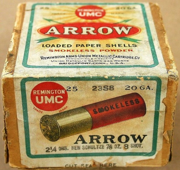

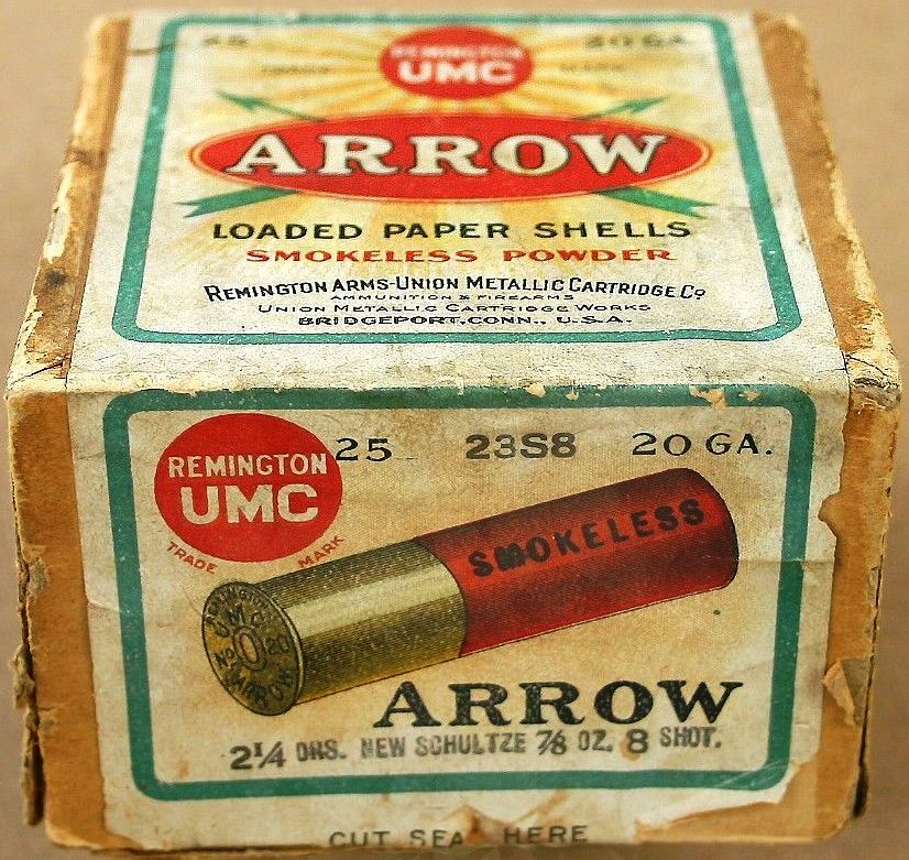

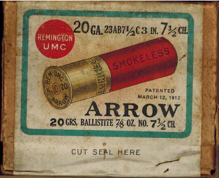

Paper Shot Shell Lengths
In reviewing old Union Metallic Cartridge Co. catalogues and price lists, the first time I see mention of extra length paper shot shell cases is in the 1880 catalogue, before they were even offering loaded shot shells. Smokeless powder loaded shot shells begin appearing in the 1891 catalogue. While the “standard” 12-gauge shells were in 2 5/8 or 2 3/4 inch lengths, the “standard” 16-gauge was 2 9/16 inch and the “standard” 20-gauge was 2 1/2 inch, paper 12-gauge shells were offered in 2 5/8, 2 3/4, 2 7/8, 3 and 3 1/4 inch lengths; 16-gauge shells in 2 9/16, 2 3/4, 2 7/8 and 3-inch lengths; and 20-gauge shells in 2 1/2, 2 3/4, 2 7/8 and 3-inch lengths.
From the 1890s into the early 1920s, these longer shot shells didn't carry a heavier payload than one could get in a 2 3/4 inch 12-gauge shell, just more/better wadding, which many serious Pigeon shooters believed to be an advantage. The maximum smokeless powder loads offered in the 2 5/8 inch 12-gauge shell and the 2 1/2 inch 20-gauge shell were a bit lighter than those offered in 2 ¾ inch and longer shells. Early on, one could get smokeless powder 12-gauge loads as heavy as 3 1/4 drams pushing 1 1/4 ounce of shot in a 2 5/8 inch paper shell. Between 1906 and 1910 our manufacturers phased out the 1 1/4 ounce loads in the 2 5/8 inch shell. By 1910 the 2 5/8 inch paper shell was only being offered with 1 1/8 or lighter payloads, and one needed to go to the 2 3/4 inch or longer shells for 1 1/4 ounce loads. In the 2 ¾ inch or longer 12-gauge cases one could get 3 ½ drams of bulk smokeless powder or 28-grains of dense smokeless powder such as Infallible or Ballistite pushing 1 ¼ ounce of shot. According to some DuPont powder booklets in my collection, these loads are a bit higher pressure then modern SAAMI specs for 2 ¾ and 3-inch 12-gauge shells!!
In the 20-gauge, the heaviest loads offered in the 2 ½ inch shell were 2 ¼ drams of bulk smokeless powder or 18 grains of dense smokeless powder such as Infallible or Ballistite pushing 7/8 ounce of shot.
In the longer 2 ¾, 2 7/8 and 3-inch shells one could get 2 ½ drams of bulk smokeless powder or 20 grains of dense smokeless powder such as Infallible or Ballistite pushing that same 7/8 ounce of shot.
