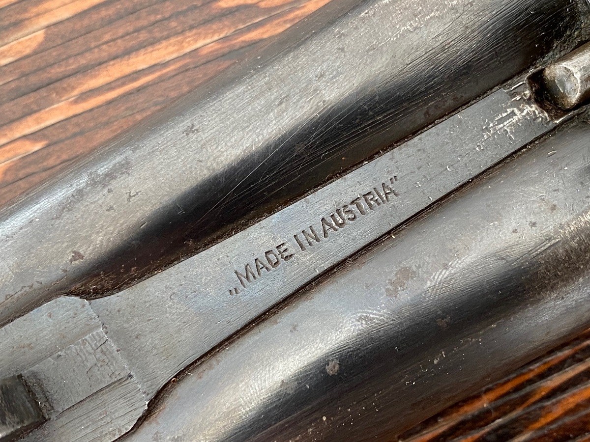

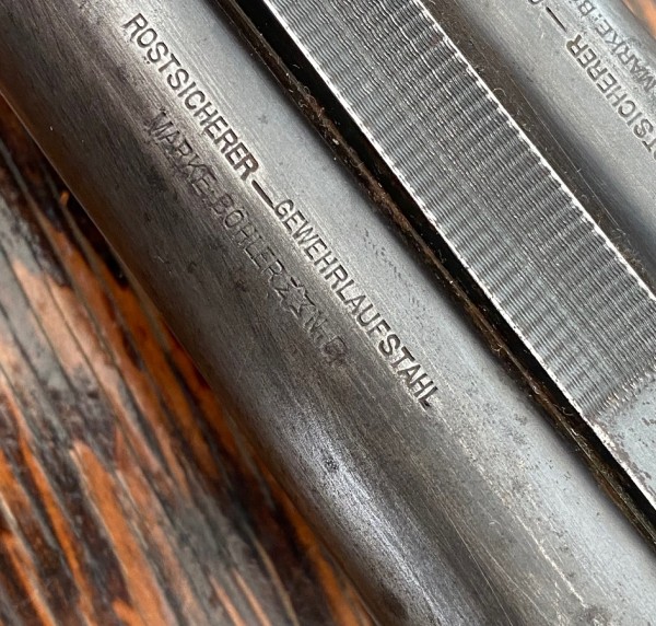

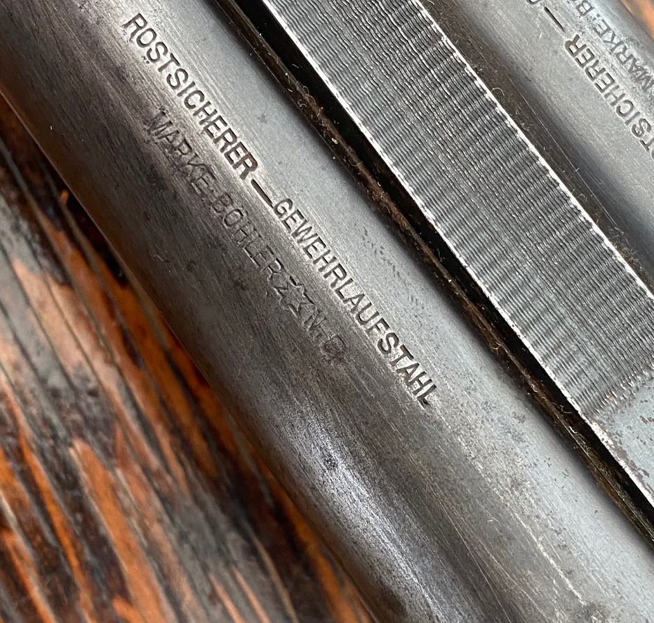

Several of us looked at the 34" A Grade today, and with the owner's permission I took some extensive macro pics. It has some hunting wear but is basically honest. I’ll post some pics when I have more time; tough posting anything while involved in an event and busy afterwards. The gun points like a dream to this guy. Barrels have no weight stamps but aren't that heavy. Most interesting to me is that the barrel legends in German read rustproof steel (English translation) and "Bohler", also is stamped “Made in Austria” in English on the long reinforced forend lug, but it has a regular Phila Fox Proof/oval mark and is absent a plethora of the typical Euro water table and lower barrel breech stamps. Seems to me that Fox assembled the barrels using imported Bohler tubes, but why not put the Bohler markings on the bottom as Fox did with Krupp steel markings? Incidentally on close inspection the word Bohler as written here actually has the German umlaut above the “o”.

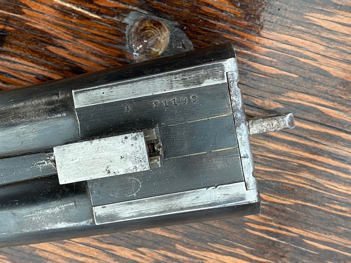

In many ways this year's Northeast SxS was one of the very best Fox Events I can remember! Many thanks to our leaders and members who stepped up to make that happen.
Here I want to report on my tech inspection of the 34" Fox serial # 21193.
