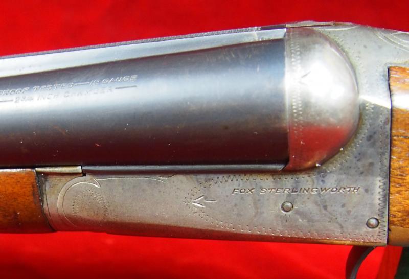

The guns I've recorded in the 132xxx range are regular frame guns up to 132589. All the guns I've recorded from 132649 to 132927 are 30-inch guns built on the flat-sided SP-frame.
