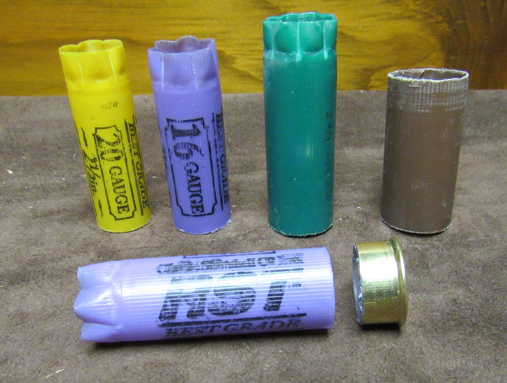

Here's another one that I use quite reliably.
I cut an empty, fired plastic hull off right at the beginning of the metal base. As square as you can cut it is helpful.
Clean up the burrs and square it off if necessary. Just slide the cut off end into the chamber until it stops at the beginning of the forcing cone and measure how deep in the chamber your "gauge" is. Then just add that number to the length of your "gauge" and you have the chamber length.
Handy if you make your gauge a nice even number like 2.0 inches.
Make them for 10, 12, 16, 20 and 28 if you have such a need.
Like these . . . .
