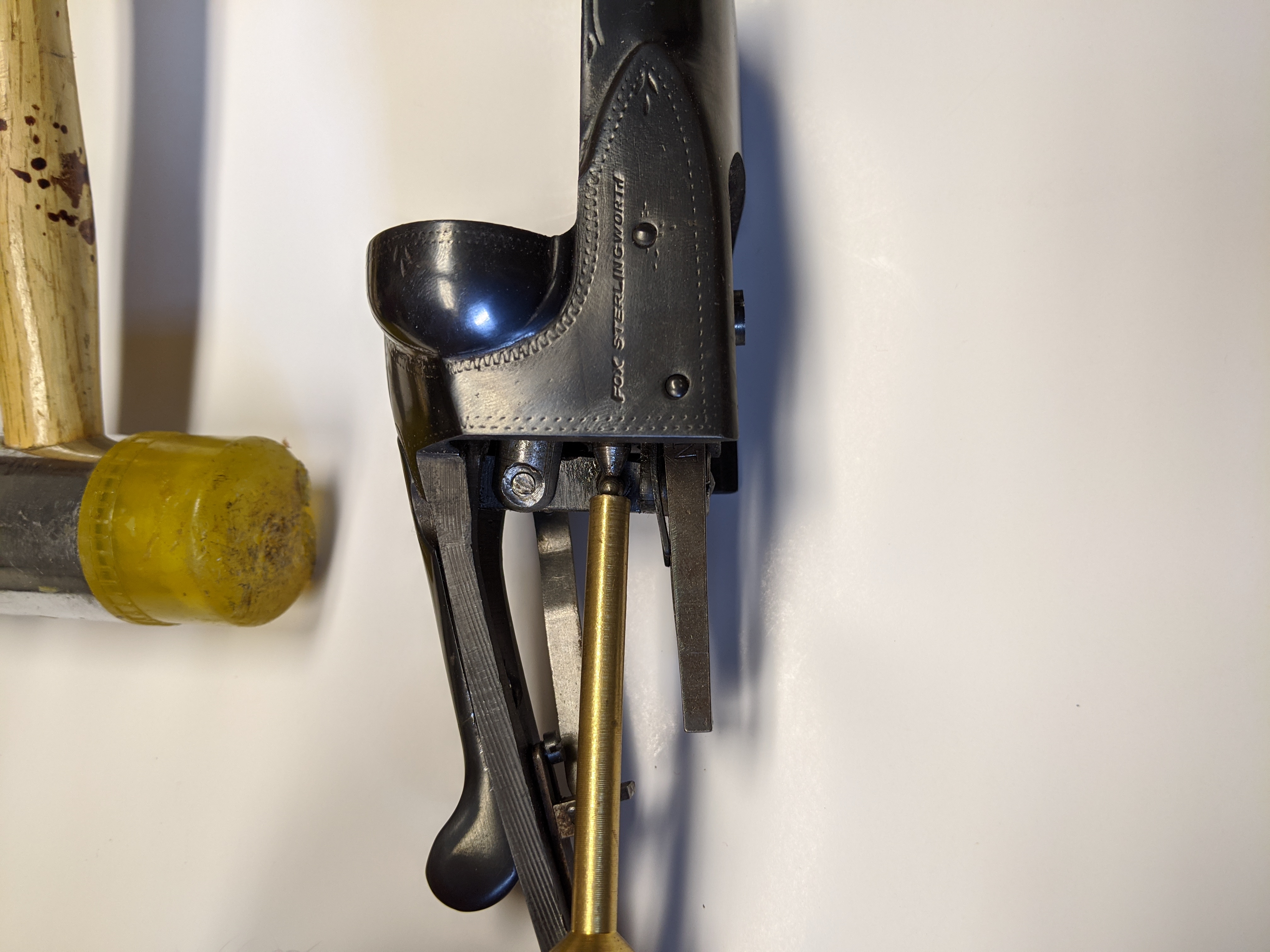

Gentlemen, I've solved the puzzle! Of I can post a picture, it shows a brass punch resting on the ball-headed screw that pushes against a detent when the lever is turned. I did tap on that, after lots of penetrating oil was applied. And what do you know - it worked once. Then it didn't... But this time I applied some pressure into the bolt, from the breech face. I think it was pressing against the conical projection inside the bolt, from the front, that freed it this time. Not certain.
In any event, this time I got the trip inserted back in to hold the bolt open.
Luckily the F-S is a later one with a stock bolt, allowing me to completely reassemble the action and adjust alignment of triggers, safety, tang screws, etc. before sliding the stock on from the rear. Sterly #143463 lives again!
Thanks Fox20Obsessed for the advice to tap on it. I was going to say something clever about a drumstick solo but ... No. Anyway, thank you Fox folks for some pretty essential help!
