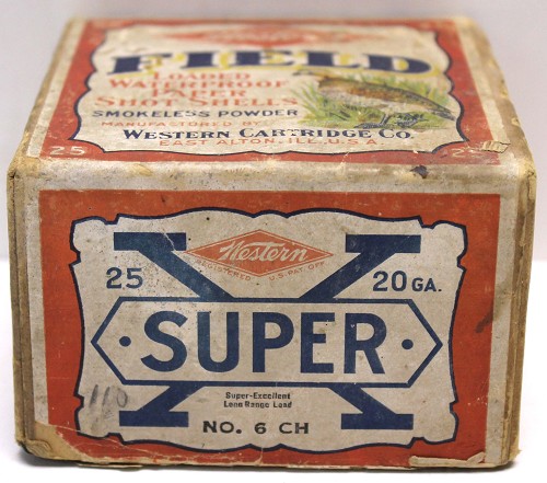

When your Sterlingworth was nine years old, our ammunition companies changed all of this, introducing progressive burning smokeless powders which could move out a heavier, one ounce payload from the 20-gauge, at higher velocity then previously possible and at lower pressures.
Early Super-X 20-gauge box, Super Excellant.jpg (74.27 KiB) Viewed 12795 times
A steady diet of such loads may well be the reason for the pins in the wrist of your stock.
Then to add even more recoil forces to the slender wrists of old 20-gauge doubles, when your Sterlingworth was 41 years old, the 20-gauge 2 3/4 inch Magnum was introduced with 1 1/8 ounce of shot.
