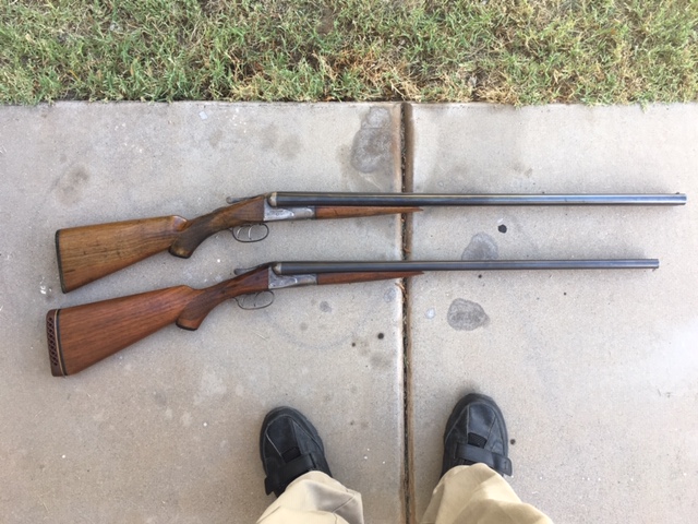

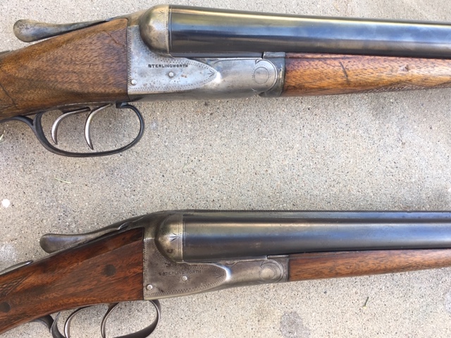

So, I picked up a 20 Gauge Sterlingworth this weekend. It was made in late 1913 or early 1914 and has 26" Barrels choked Cylinder/Modified. Barrel weight markings are not present but the assumptions are that they are very light barrels based on the overall feel of the shotgun. The chambers measure 2 3/4" (actually plus a fraction) on my chamber gauge. So I assume they were lengthened sometime in their 115 year history. First fire will be this Friday and I will start with the standard 7/8 oz target load. But I have to ask, what are the thoughts on shooting a 1 oz load through this shotgun. I'll know on Friday if I shoot it as well as the 12 gauge with a 1 oz payload.

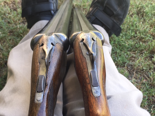

I take terrible pictures, but here are some comparison photos next to my 28" 12 Gauge. I'll try to take some more over the next few days.

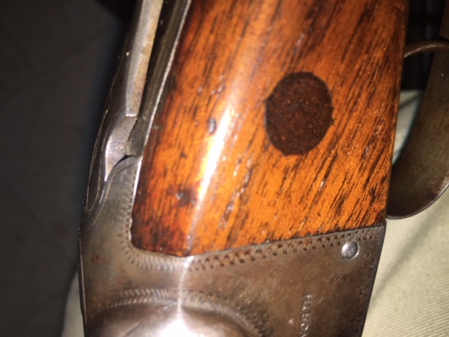

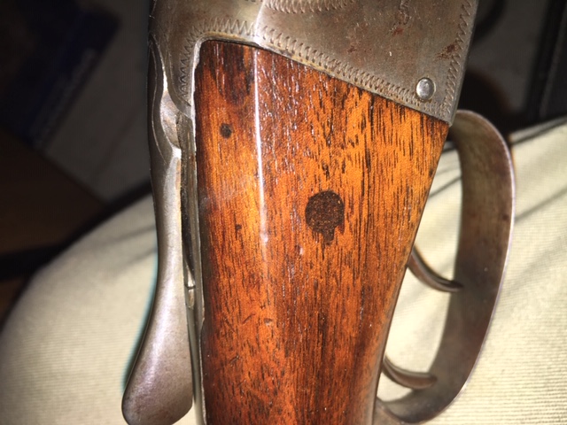

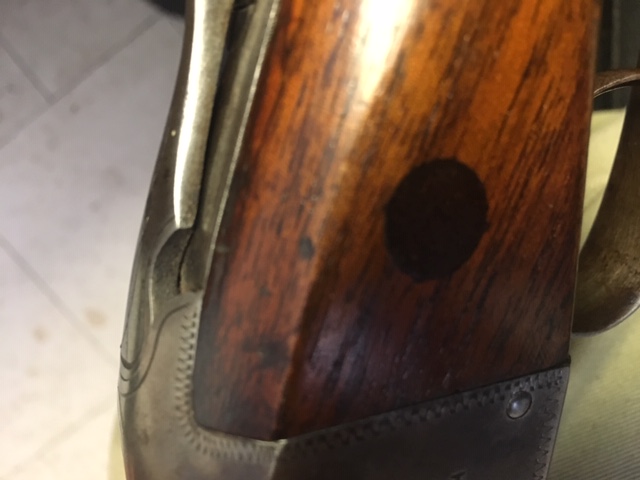

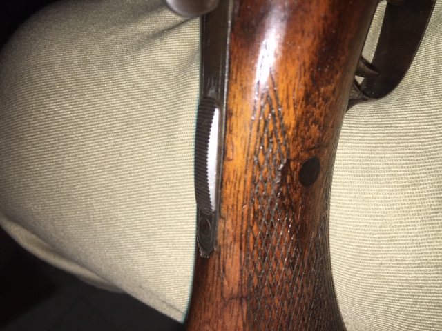

Appears to me based on the pics that your 20 gauge may have been pinned with wooden dowels to most likely repair a crack in the cheeks. If that is indeed the case I'd recommend you shoot quite lite loads and stay away from 1 oz loads. Also based on the picture taken from the top showing the lever, that a screw under the lever might not be tight. Could be wrong, but worth checking before you fire the gun.

Astute observation Vaturkey,
I was actually going to bring those plugs into this discussion. I have looked at those plugs with 10x magnification looking for any sign of cracking and can't see any. That doesn't mean that they aren't there but I can't see them. But that leaves the question of why they are there in the first place.

John, that is a nice gun and you'll have a lot of fun with it. I own a 1918 Sterlingworth 20 ga. with 26" barrels and it is a delight to shoot. Like Tom (Vaturkey), I noticed the two plugs and concluded that the stock has been repaired. Regarding your question as to whether you should use 1 oz. load, I'm betting that a few people will say "why". A lot of the members like, and recommend, using light loads. After all, we're shooting these old guns for fun.

It is a 99% certainty your 20-gauge Sterlingworth left North 18th Street and Windrim Avenue with 2 3/8 inch chambers, intended for 2 1/2 inch shells, which at that time carried a maximum load of 2 1/4 drams of bulk smokeless powder or 18-grains of dense smokeless powder such as Infallible or Ballistite pushing 7/8 ounce of shot.
But there were plenty of lighter 20-gauge loads as well --
When your Sterlingworth was nine years old, our ammunition companies changed all of this, introducing progressive burning smokeless powders which could move out a heavier, one ounce payload from the 20-gauge, at higher velocity then previously possible and at lower pressures.

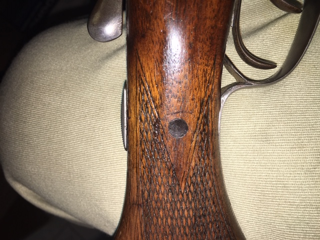

A steady diet of such loads may well be the reason for the pins in the wrist of your stock.

I'll spend some time tonight with a magnifier to see if i can find any signs of a crack repari. FYI - there is another plug on the other side. Here are some close up pictures of the areas around the plugs.
