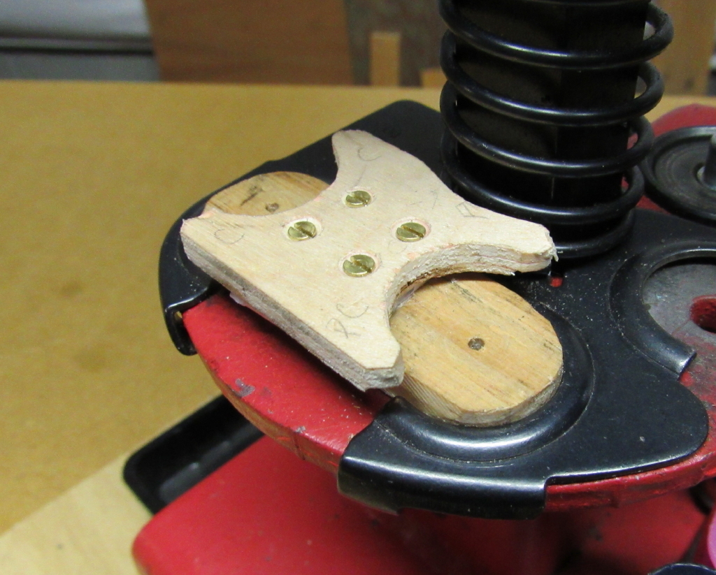

I use a MEC Sizemaster reloader using that recipe above for the 2 1/2" RST hulls that Woody suggests.
On the Sizemaster that I use for 2 3/4" hulls, the first 3 stations can easily accommodate the 2 1/2" hulls with no changes: #1 - deprime and size; #2 - prime and #3 for powder drop, wad insertion and shot drop. You may have to adjust the drop tube a little lower tho to seat the wad.
For station #4 - crimp start and 5 - final crimp, I use a 1/4" thick spacer at those stations to raise the hull for those operations as pictured below.
Works good for me. If you want any more detail, send me a PM and we can work it out there.
