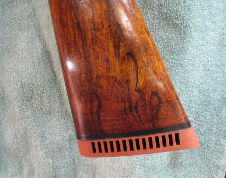

Here's a Fox with a > 1" extension that was glued and screwed into place, then sanded and with faux mineral streaking to match up with the buttstock. Afterwards it was spot refinished/blended into the original varnish. This Fox had been owned by a somewhat noted gent and I wanted to retain its original stock which had been cut. The spacer is a scrap piece of thinshell walnut. Just shows what can be done.

Wow that's pretty impressive work!

Mark Larson can make the splice totally disappear.

Both are great examples of what can be done. Some great wood craftsmanship!

Just a short comment here and I'll be quiet. Over the past few years I've looked at a high grade Syracuse Lefever that's on display and For Sale ongoing at one of the larger SxS events. The stock has an extension, attributed to a gent who's recognized for that type work, and while the wood grain matching is excellent the transition area looks odd and it's obvious when you handle the gun that a spacer had been added, and it detracts greatly imo. I don't know when the spacer work had been done and maybe it's an age thing. The Lefever doesn't look like it was hunted since that work.
Net, when getting a spacer added "your mileage may vary".
