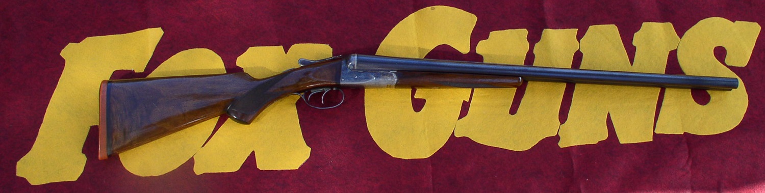

And here is Fox #2
Posted: Sun Jul 15, 2018 7:20 pm
by Dave Erickson
:D
Re: And here is Fox #2
Posted: Mon Jul 16, 2018 6:35 am
by vaturkey
Good solid Fox Sterly that seems to have twin ivories as well. Looks like the gun has never been apart. You did well Dave. :)
Posted: Mon Jul 16, 2018 7:13 am
by Dave Erickson
I can't thank you enough for your help, Tom. I so appreciate well made guns that allow me to shoot to the best of my abilities, and what a bargain! This old Fox has found a home.

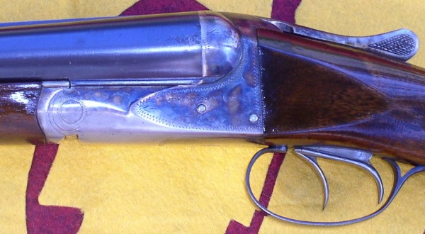

Dave, I was a little suspect about the barrels on this gun when you sent me the specs and now that I see your picture #3 I'm even more so. The right barrel appears to have a greater diameter then the right breechball. The barrels certainly appear to be perfectly tight and on-face for a lifetime of shooting, but I don't believe the gun originally left Utica with those barrels. Here is a picture of my Fox-Sterlingworth Ejector Brush with a serial number less then 60 higher then the serial number you provided me for your gun.

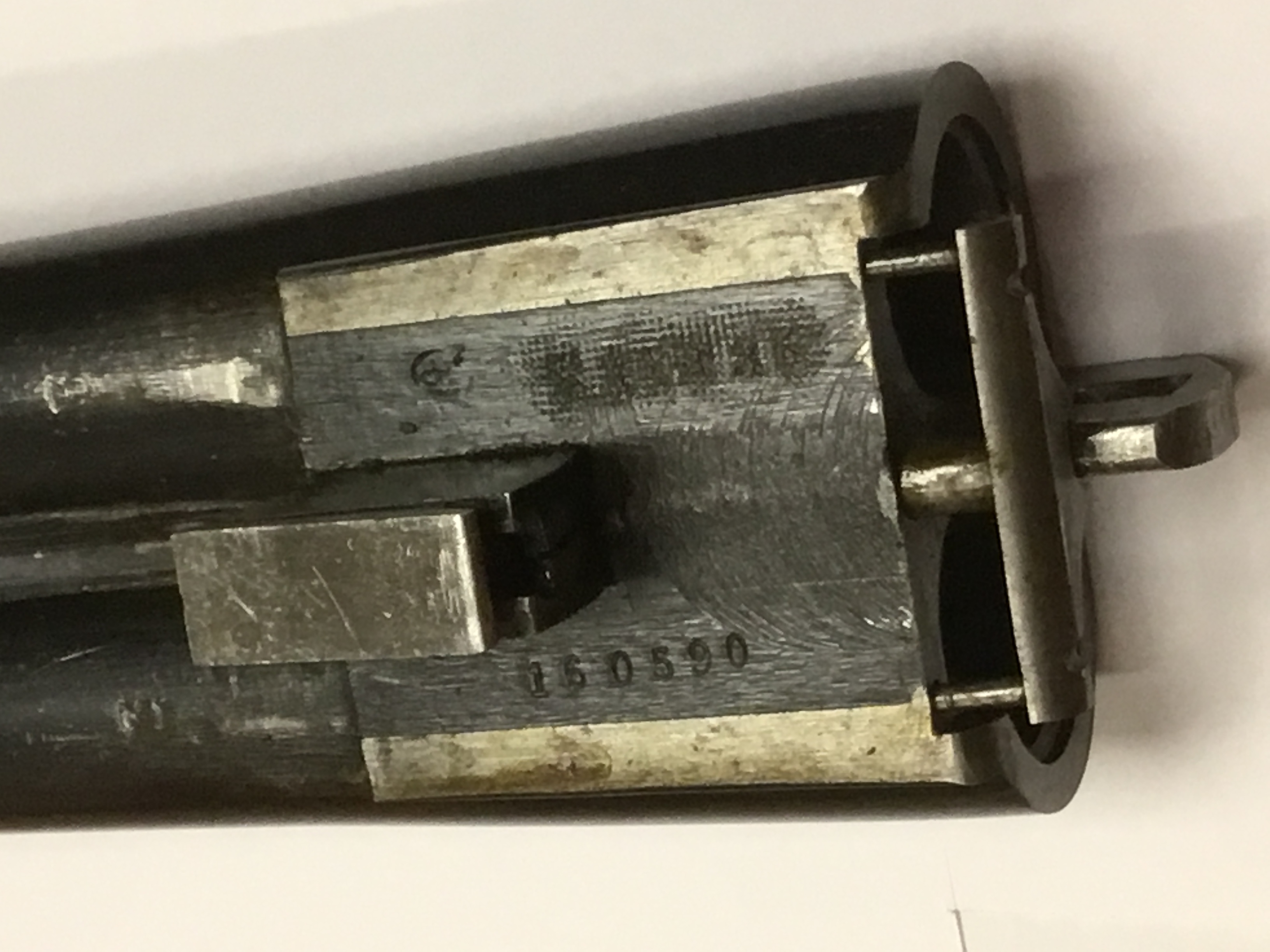

Would be nice to see some good pictures of the barrel flats of your gun. A letter on the gun would be great, but with the experiences folks have reported about getting a letter from Savage, I can't recommend that.

Good eye. I didn’t even notice it.
Let me know if you need any different views. Not sure how those became upside down.
Posted: Tue Jul 17, 2018 1:58 pm
by Dave Erickson
The right barrel is indeed a little proud.

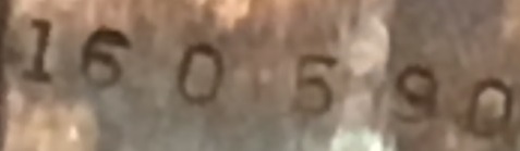

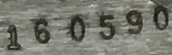

Guess we'll never know for sure who did the work, but the new serial number stamped on the barrel flats looks to my eyes to be in the same style font that Savage was using for barrel flat serial numbers from 133xxx range onwards.
Barrel Flat Serial Number
160590 10.jpg (15.08 KiB) Viewed 12390 times
Watertable Serial Number
160590 11.jpg (15.19 KiB) Viewed 12390 times
Don't know why Savage used the squarish one on the watertable serial number and the sloping one on the barrel flats serial number, but they did, except for Fox-Sterlingworth Wildfowls which exhibit the squarish 1 in both places?!?
I certainly couldn't read the original serial number of the barrels through that crosshatching. Is there a serial number stamped on the back of the extractor? If so can you read it?
