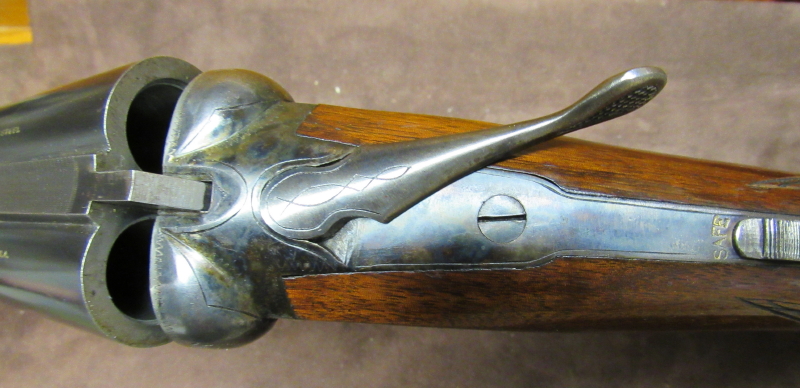

Larry, I'm a Fox dummy, but always wanting to learn. What are the Philly features?

Capped pistol grip, shape of both the safety and the top lever on your gun are the earlier style.

Thanks, fullchoke16. I was thinking the toplever and cap because they are like my Philly 16, but I'm not up to speed on the safeties.

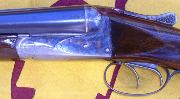

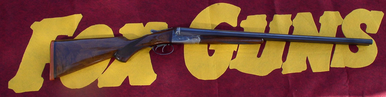

Dave Erickson wrote:Larry, I'm a Fox dummy, but always wanting to learn. What are the Philly features?
Dave,

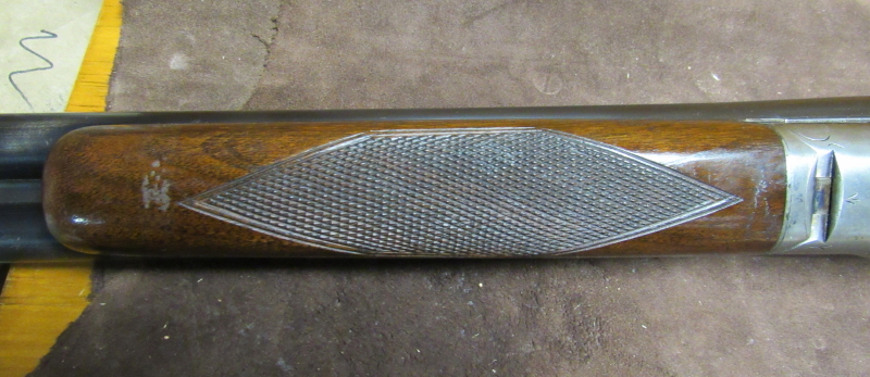

Also, the fore end wood on the Utica guns is usually somewhat wider than the more tapered Philly Sterlingworth's.
Also on the 12 gauge Utica Sterlingworth's, the inletting of the stock at the top tang right and left side are squared. The Philly Sterlingworth 12's are rounded where the stock inlets to the top of the receiver.
16 and 20 gauge Philly Sterlingworth's are squared off at the top tang, as are the Utica guns.
12 gauge Utica Sterlingworth SN 136307 pictured below showing the top tang inletting and the wider fore end wood.
Top tang inletting
Top tang inletting
Fore end wood
Fore end wood

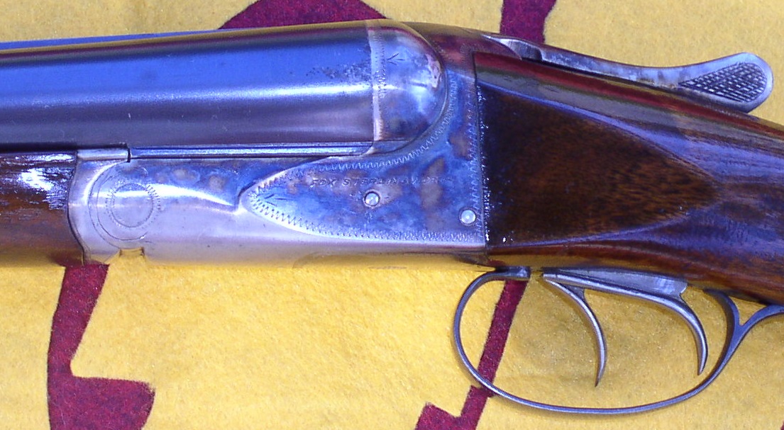

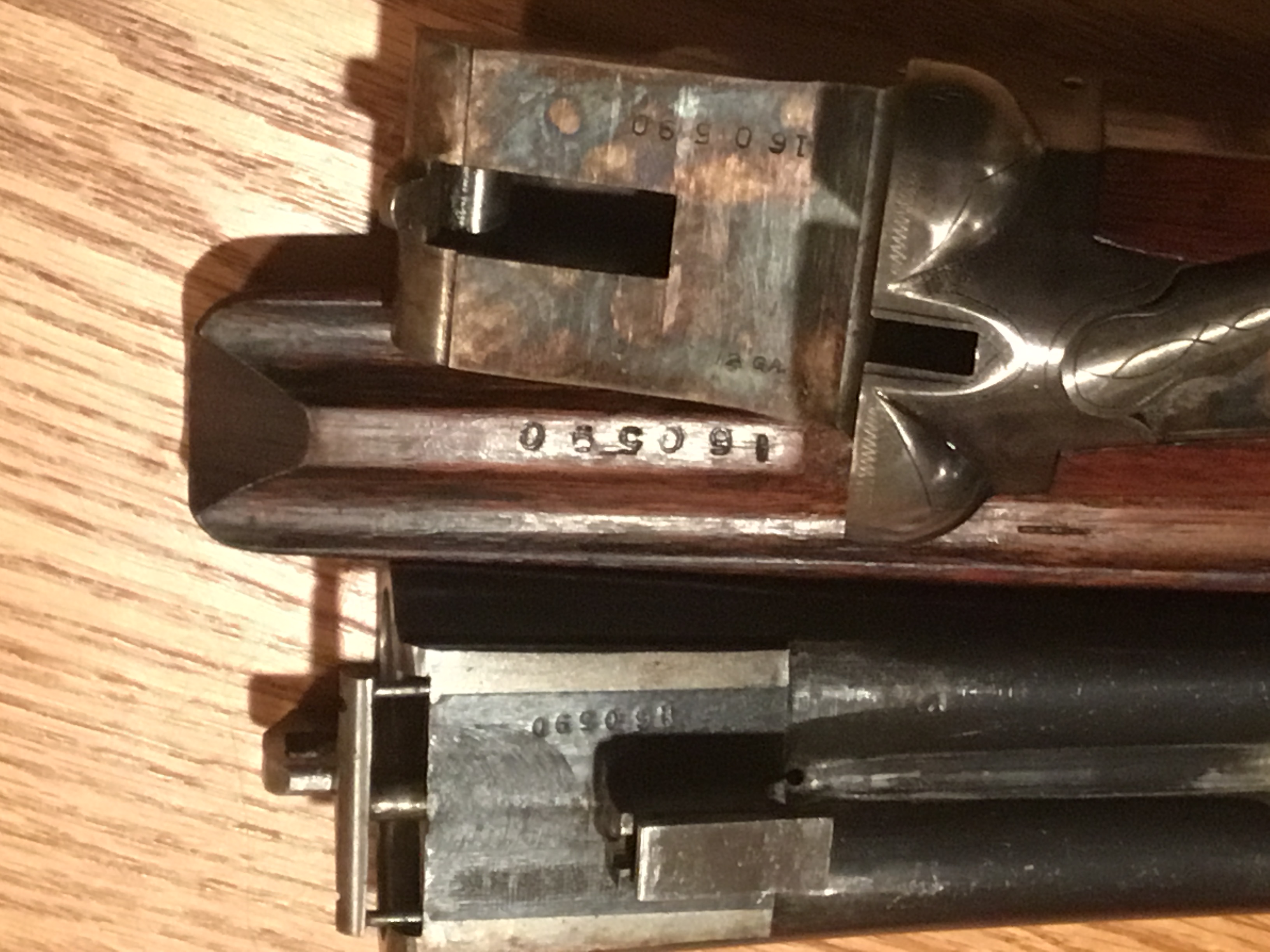

Dave, I was a little suspect about the barrels on this gun when you sent me the specs and now that I see your picture #3 I'm even more so. The right barrel appears to have a greater diameter then the right breechball. The barrels certainly appear to be perfectly tight and on-face for a lifetime of shooting, but I don't believe the gun originally left Utica with those barrels. Here is a picture of my Fox-Sterlingworth Ejector Brush with a serial number less then 60 higher then the serial number you provided me for your gun.
How a barrel and breechball should mesh

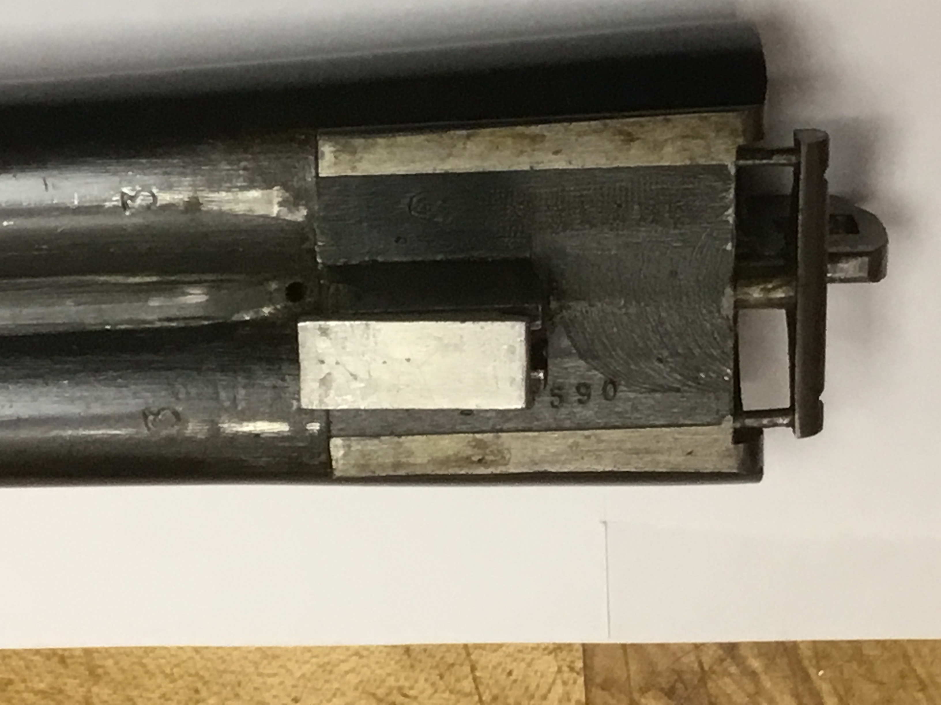

Would be nice to see some good pictures of the barrel flats of your gun. A letter on the gun would be great, but with the experiences folks have reported about getting a letter from Savage, I can't recommend that.

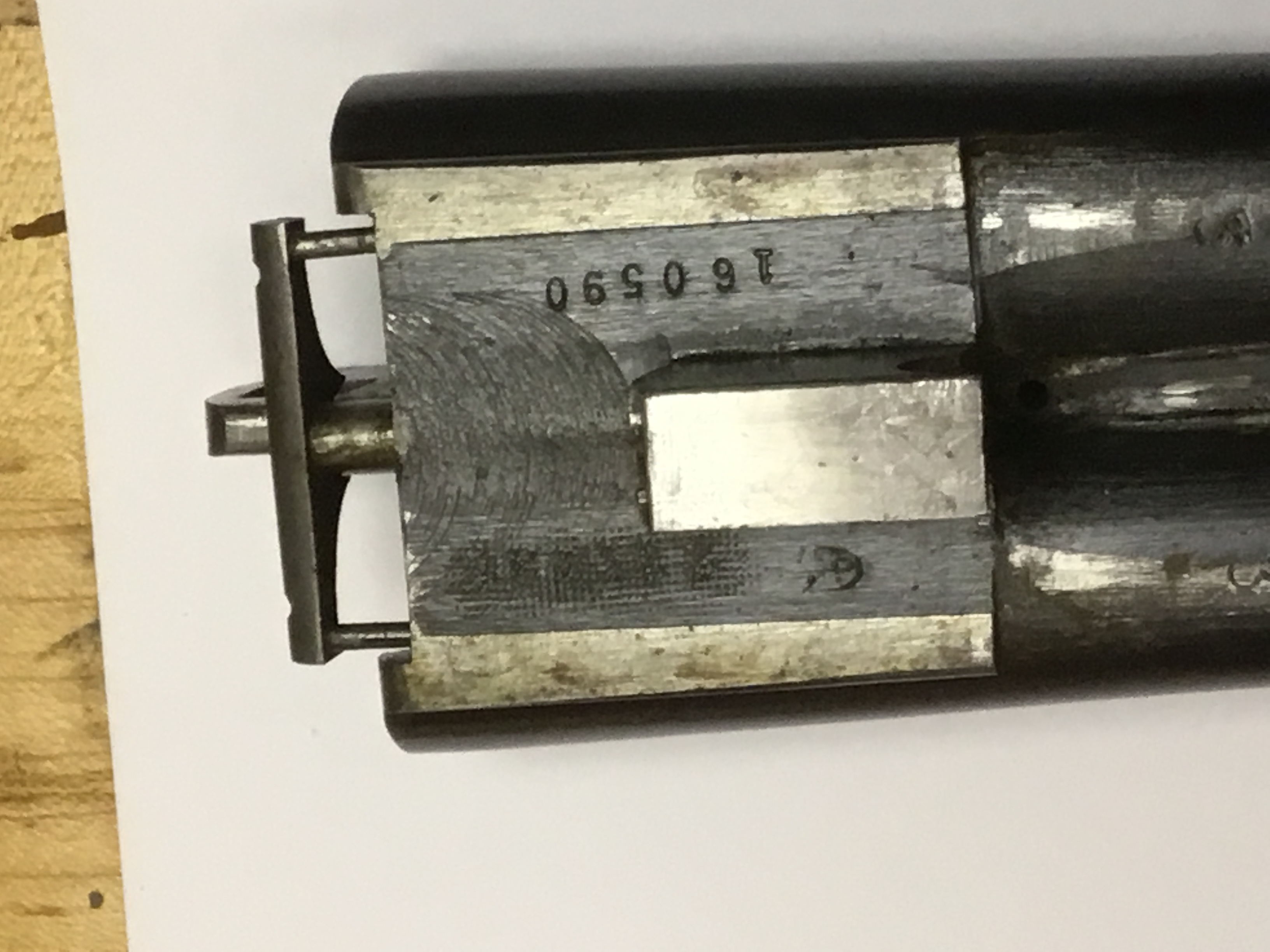

Good eye. I didn’t even notice it.
Let me know if you need any different views. Not sure how those became upside down.

The right barrel is indeed a little proud.

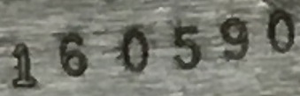

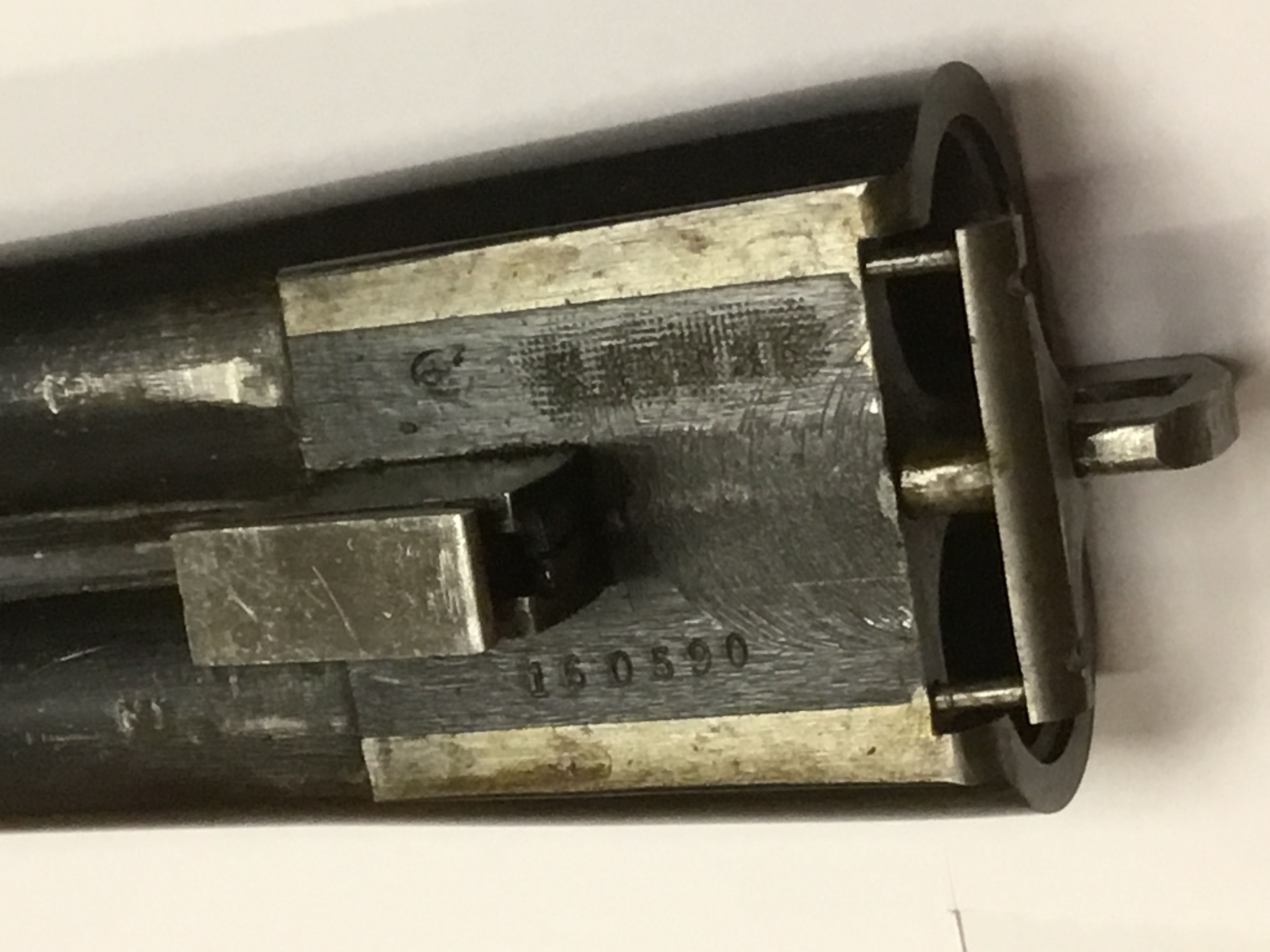

Guess we'll never know for sure who did the work, but the new serial number stamped on the barrel flats looks to my eyes to be in the same style font that Savage was using for barrel flat serial numbers from 133xxx range onwards.
Barrel Flat Serial Number
160590 10.jpg (15.08 KiB) Viewed 13231 times

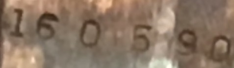

Watertable Serial Number
160590 11.jpg (15.19 KiB) Viewed 13231 times
Don't know why Savage used the squarish one on the watertable serial number and the sloping one on the barrel flats serial number, but they did, except for Fox-Sterlingworth Wildfowls which exhibit the squarish 1 in both places?!?
I certainly couldn't read the original serial number of the barrels through that crosshatching. Is there a serial number stamped on the back of the extractor? If so can you read it?
