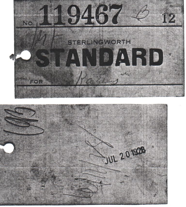

You can get a letter from Cody, but they are rather spendy for the very limited amount of information on a Sterlingworth production card. Here is a photocopy of card for a 1928 Sterlingworth --
To order a letter from Cody --
