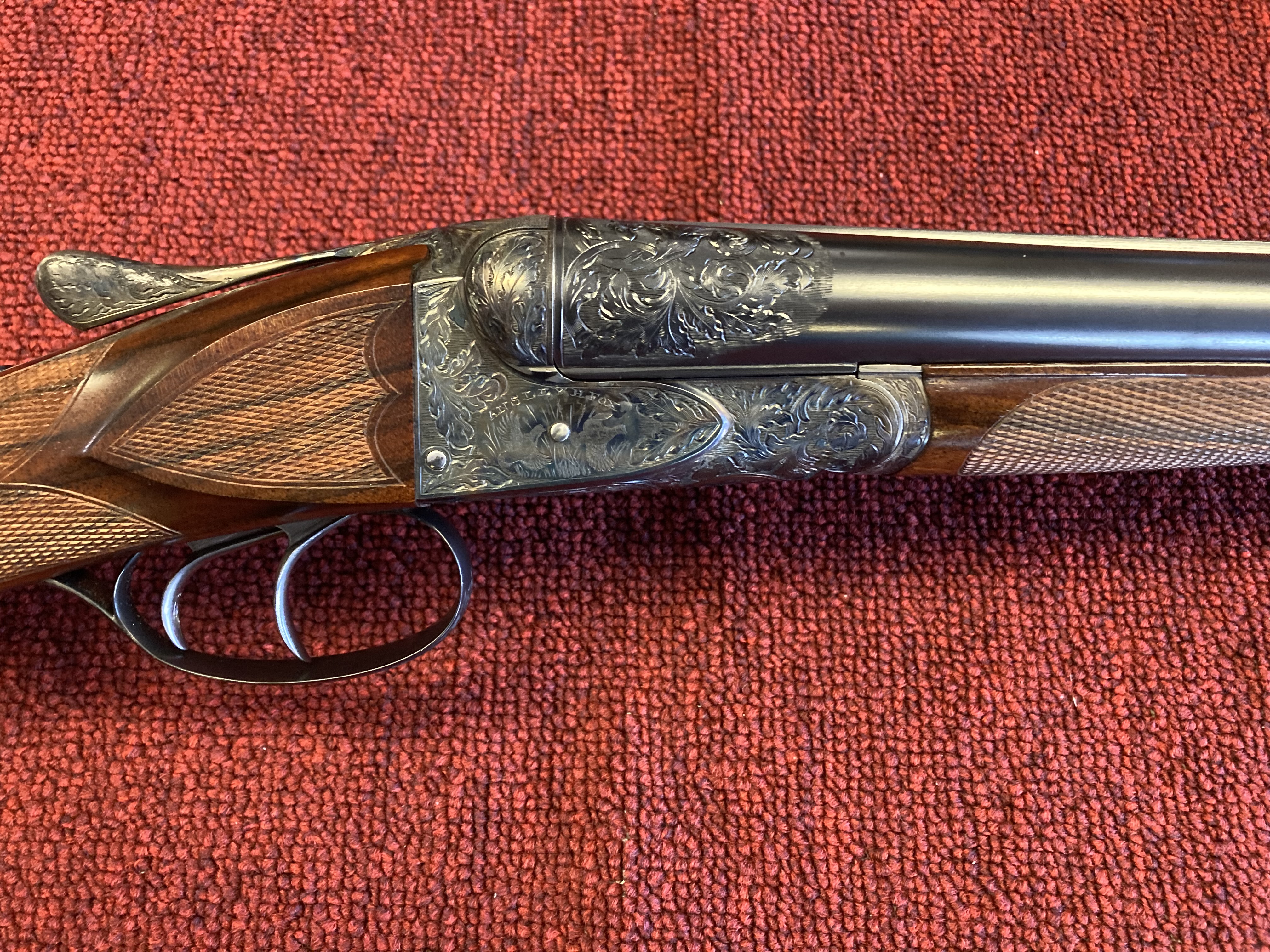

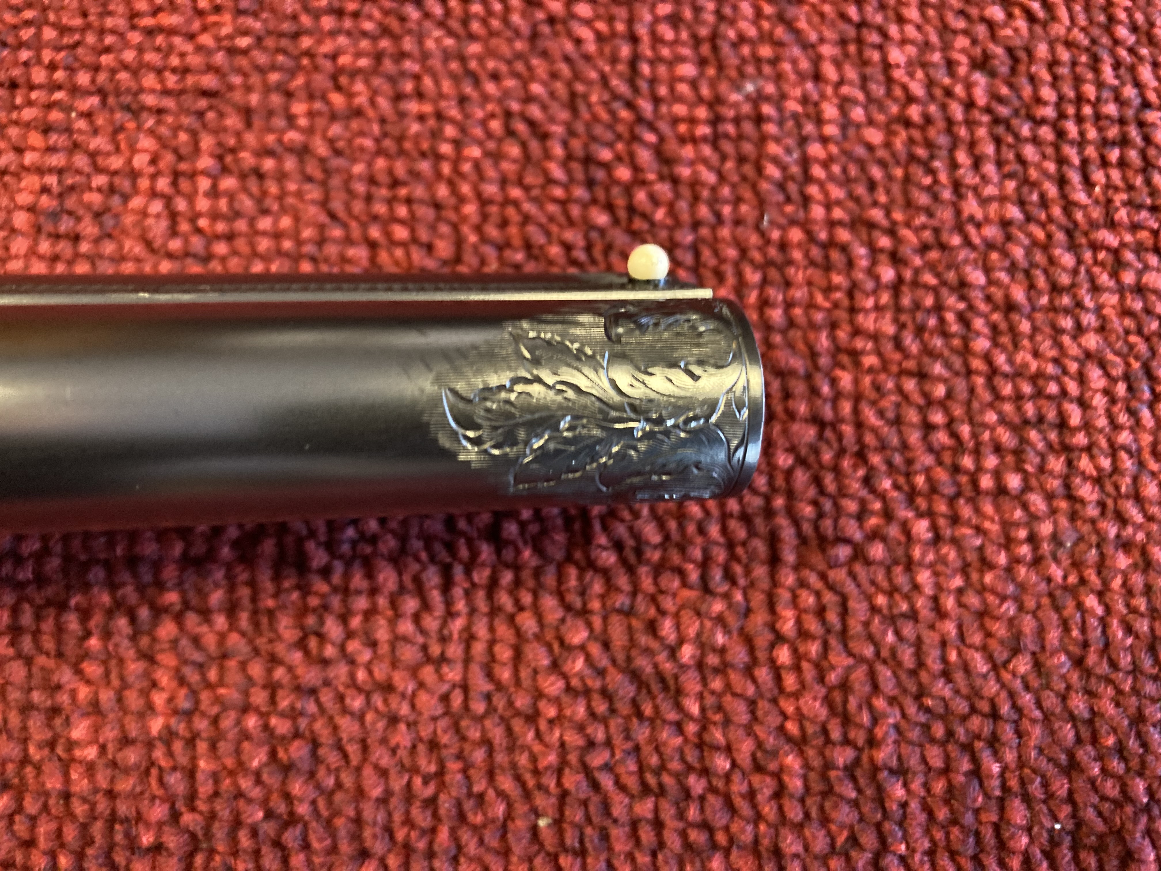

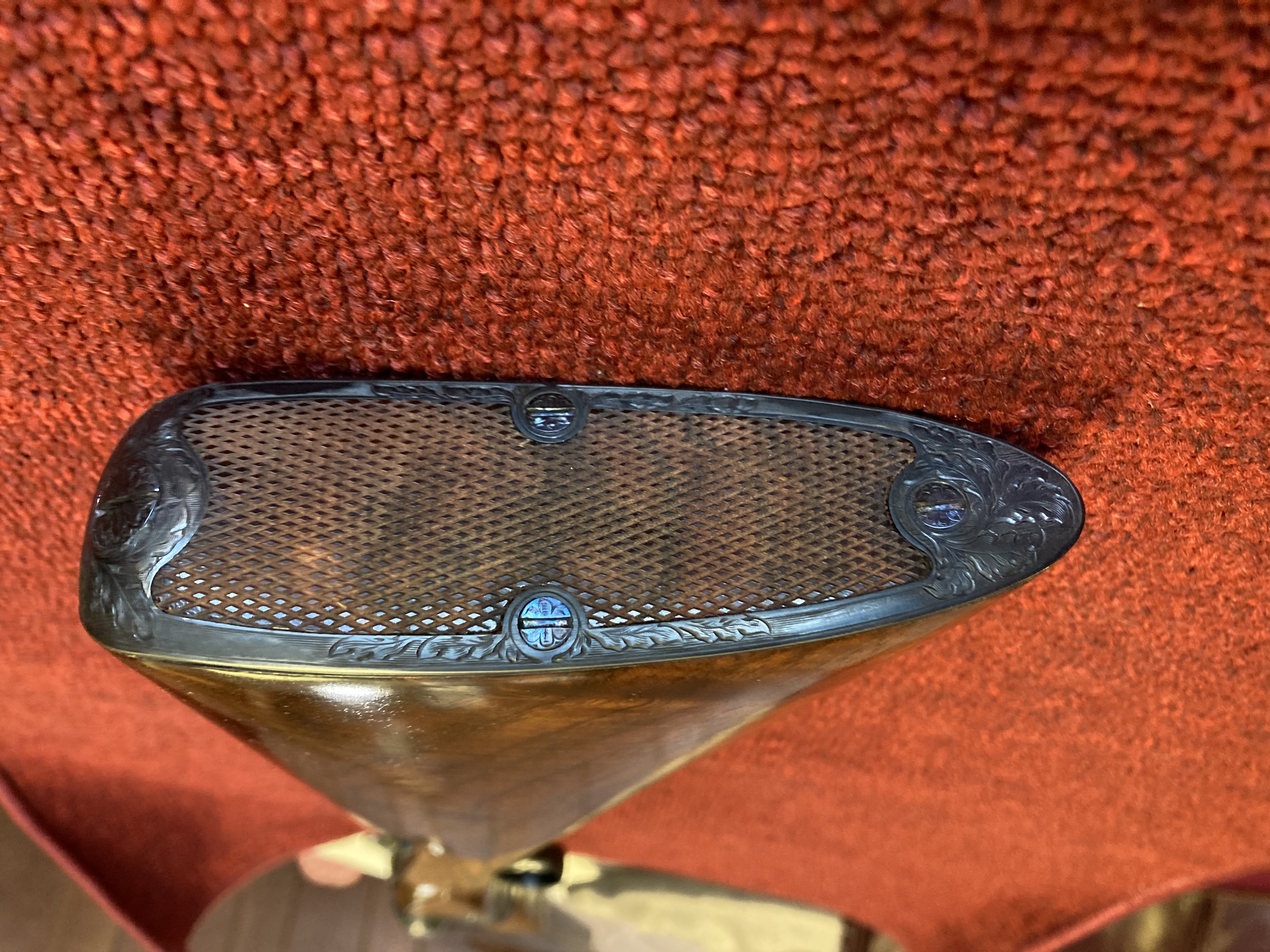

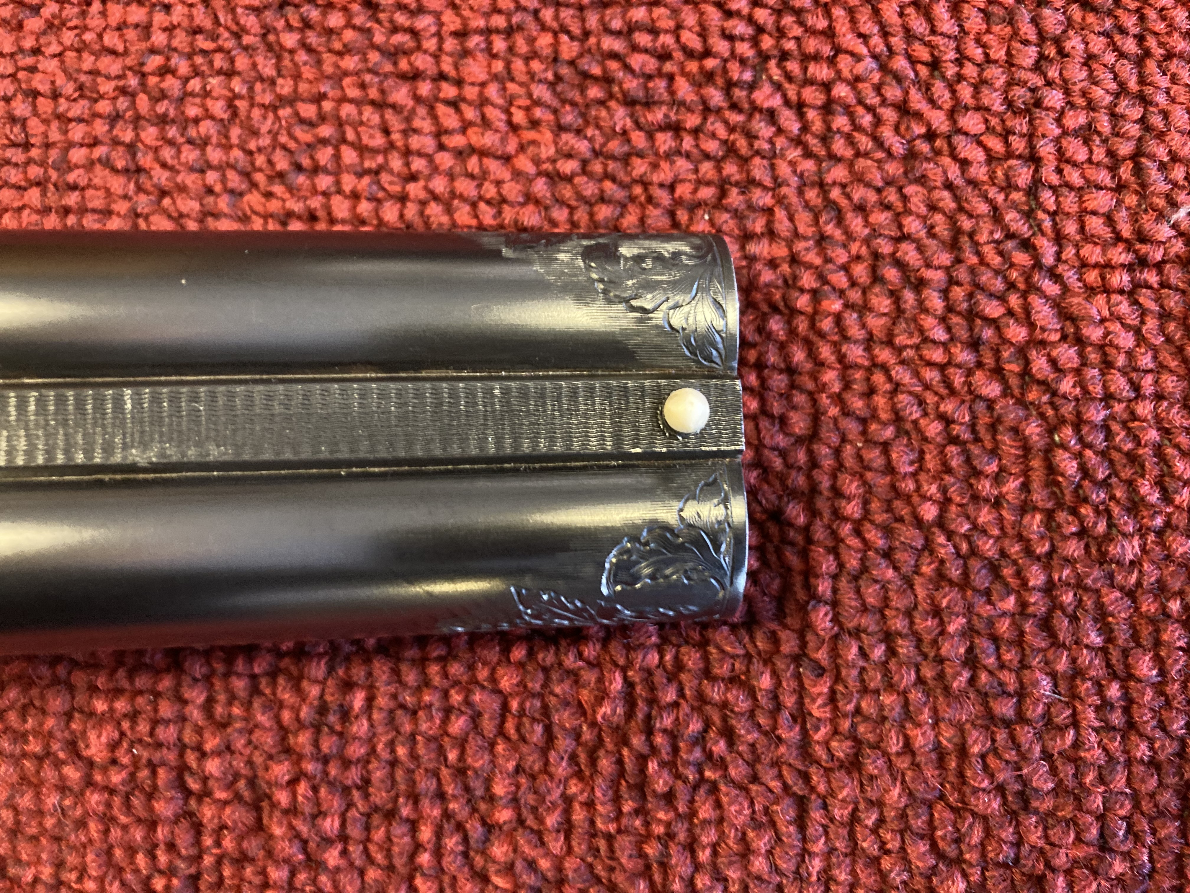

The previous thread and pics of Jolly Bill’s guns done by Jim Demunck got me thinking and really appreciating Mr. Demunck’s work. Here are some pics of an XE upgrade that was done by Jim Demunck and Walter Koulach. Jim did the metal work/engraving and Walter did the furniture. The original owner kept all the documentation, receipts and info between the craftsman and himself for documentation. This gun was completed many years ago and hasn’t left the safe since completion. One interesting aspect of the project is the donor Sterlingworth ejector gun had the traditional friction/snap on forearm. It still retains the snap on forend iron and lug but Mr. Demunck and Mr. Kolouch
cleverly inletted an A&D style forend latch per the owner’s request. The owner also requested an engraving of his setter on the floor plate instead of the traditional Fox. The fit, finish, stock work, checkering, metal work and engraving is superbly done. It’s a beautiful gun!!! This is not my gun but so enjoyed getting to handle/photograph the gun.

Re: An XE 16 Ga. Collaboration by Jim Demunck & Walter Koulach
Beautiful gun.
Does the Deeley latch serve any purpose other than looks?One interesting aspect of the project is the donor Sterlingworth ejector gun had the traditional friction/snap on forearm. It still retains the snap on forend iron and lug but Mr. Demunck and Mr. Koulach cleverly inletted an A&D style forend latch per the owner’s request.
- Posts: 2276
- Has thanked: 1447 times
- Been thanked: 1533 times
Strictly cosmetic!!Researcher wrote: ↑Sun Feb 15, 2026 12:49 pm Beautiful gun.
Very impressive workmanship.
That’s a beautiful gun. It appears that the barrels may have been re-stamped.Or could one have ordered Chromox barrels on a Sterlingworth for an additional charge?
- Posts: 2276
Joe, that’s a good question that I don’t have an answer for. I’d assume that they have been re-stamped as I don’t believe you could get Chromox barrels with a Sterlingworth. If I get a chance I’ll ask the owner if he knows.
I suspect restamped. Jon Hosford has the original roll stamps. He roll stamped a Sterlingworth for me about 4 years ago to make it appear as a graded gun. That gun is currently with a stocker (long sad story) and I hope to get it back in time for next bird season.
