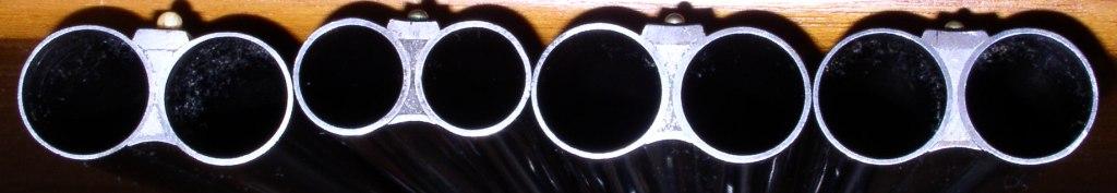

On the longer barrel guns the tubes normally are touching or very nearly touching at the muzzle. A 30-inch 20-gauge --

The muzzles of four guns that letter as 26-inch showing a bit of a gap --

Good info, and I appreciate the pictures for comparison, I had been looking for an image like that so I could get an idea of what an uncut muzzle looks like.
