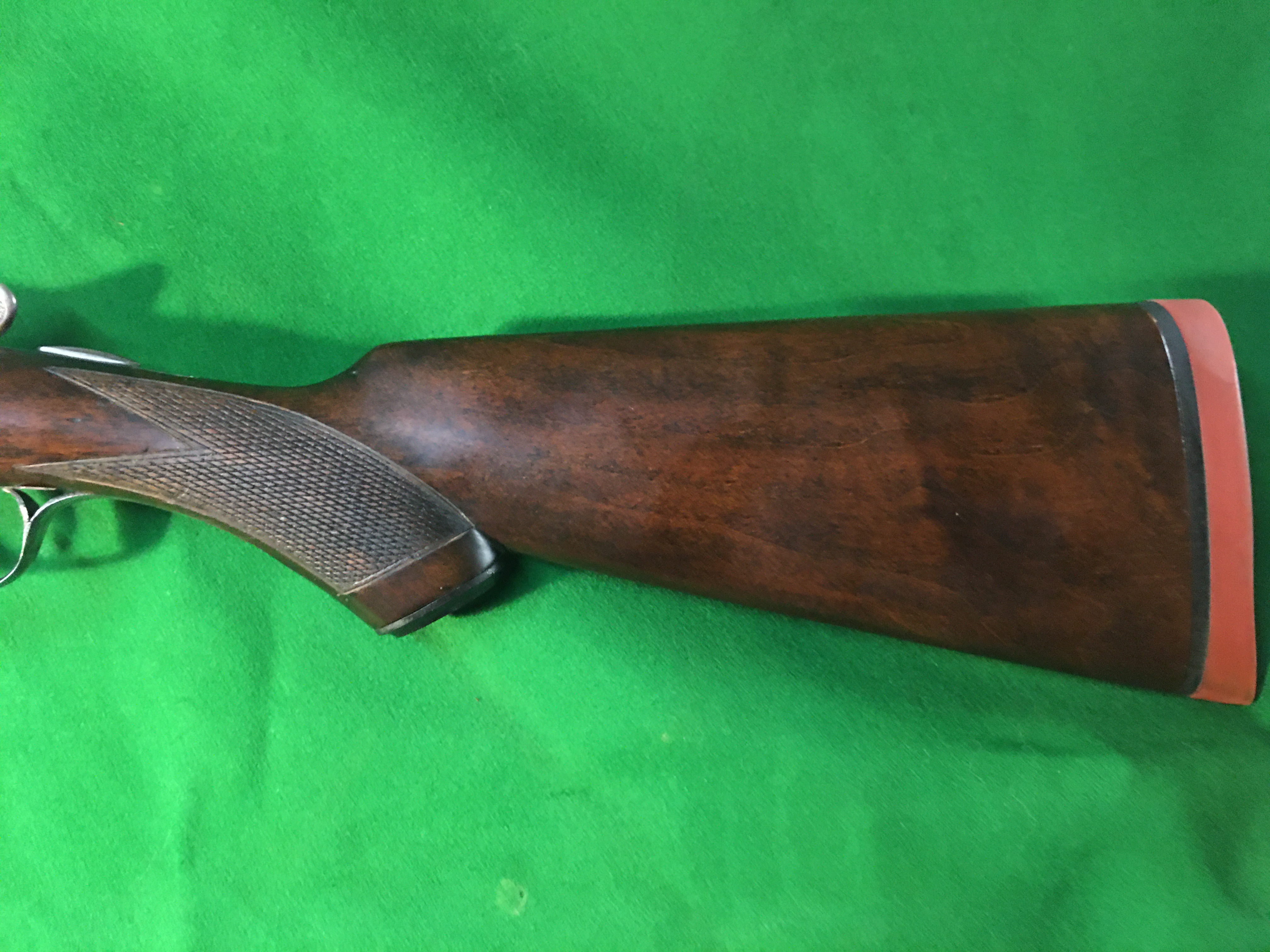

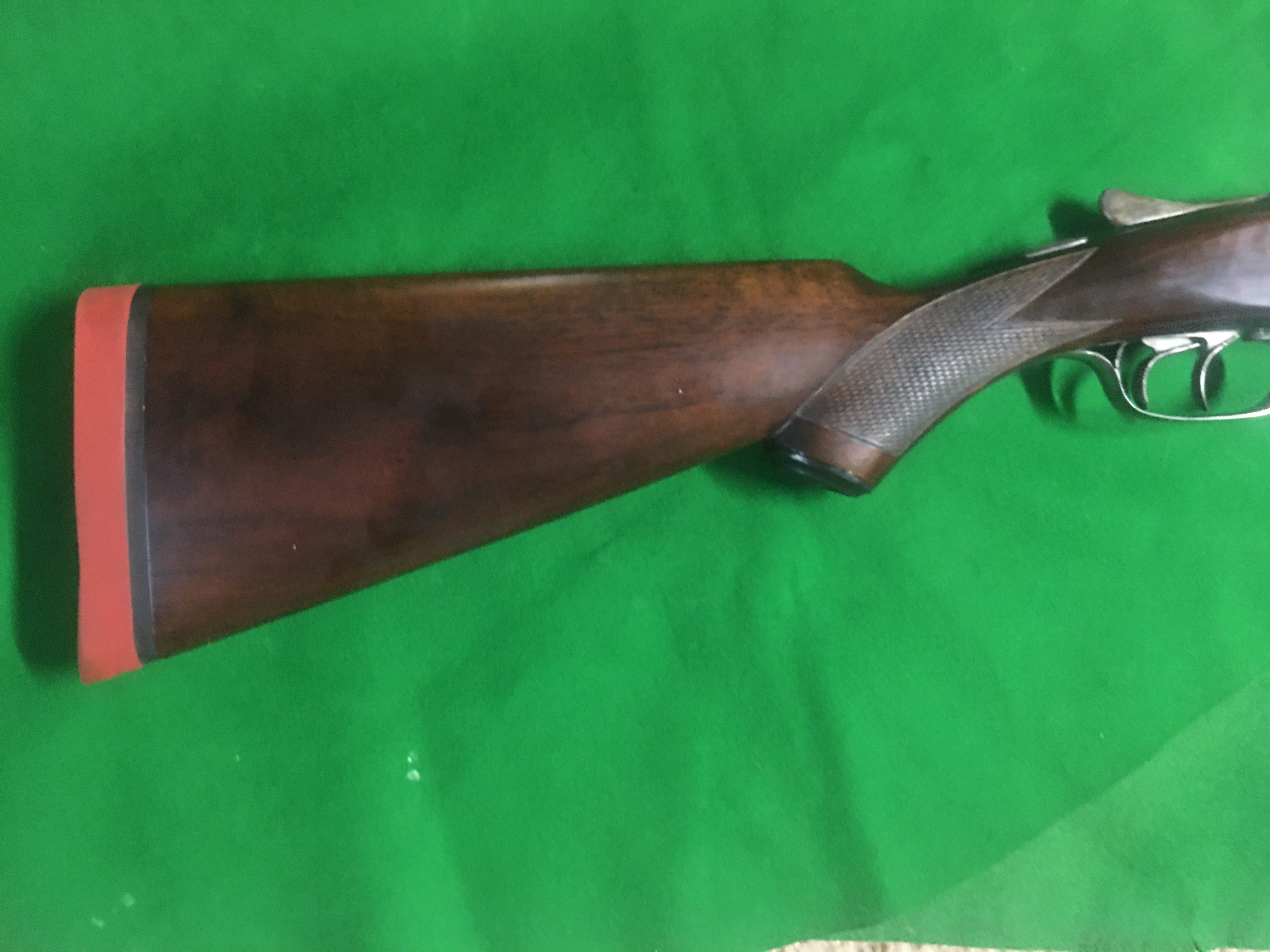

I bought this 16. ga. 30" Sterly from a walk-in 'gent' the opening hour of the NE SxS at Hausmann's this June. It had a bad stock; someone had tried to raise the DAC by cutting the back end off at the rear grip checkering border, then angling it upwards before double-end screwing it with threaded steel pins, Over time of course the joint worked loose both in the horizontal as well as vertical plane, resulting in a "wobble stock."
After checking chambers and chokes (2 1/2 w/ M & F) and making sure the mechanics were all there and functioning properly, I "upper echelon"-balled (as opposed to low-balled) the seller and we had a deal. After I bought the gun, boothmate Tom T. (VA Turkey) handed me a Sterly stock he had taken off one of his upgraded guns and said, "See if this'll fit!" All of you know how that usually goes!
When I went to see my stock man, he examined the gun then went to a drawer in one of his work cabinets and pulled out three Sterlingworth stocks, all in pretty good shape and with decent wood. None of the three fit the way he wanted in terms of work required to refit them without major alteration(s). FInally he said "Let's try your donor stock." After some careful measurement he said, "Leave it with me; I'll see what I can do."

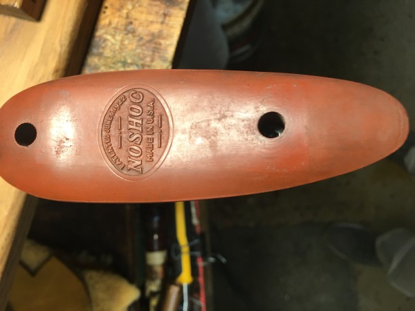

A week and a half later he called me and said, "Your gun's ready, come get it!" When I picked it up,, he told me all he had to do to it was some mild reductions internally with sandpaper and a little minor relief gouging; no rasping or other radical relieving of wood surfaces. What are the chances!! Two big bonuses: the refit yielded my measured stock dimensions (off a try gun) to within 1/8" and we preserved and reused the original NoShoc pad!

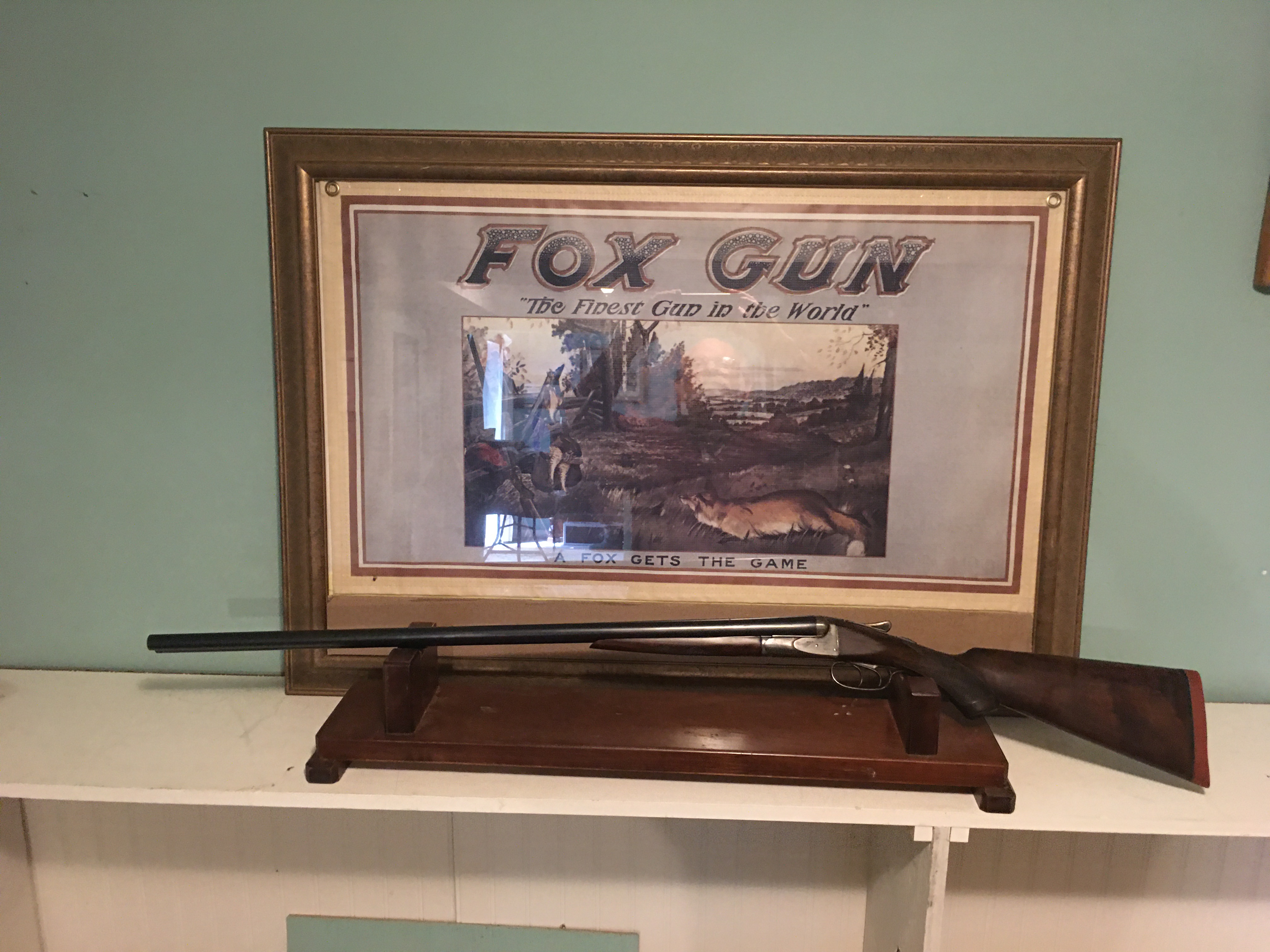

On the way back from a shoot in Addieville RI just before Hausmann's, Daryl Corona, Stan Hoover and I talked about the allure of long-barreled smallbore guns, especially Foxes, Daryl of course being a huge fan of 30- and 32-inch guns. As a tribute to Daryl's influence on me by ."extolling these virtues, I have dubbed this gun the "Daryl Corona Autograph Model". Thanks to he and Tom T., I now enjoy a 16 ga version! Attached are a few pics of the revived Sterly. Kevin

Great story, 30" 16ga Foxes are normally pretty close in weight to a 28" Parker 20ga on a 0 frame. Sweet guns that are under appreciated. Congratulations Kevin!

Congratulations Kevin! You are one of the top Fox curators! It now looks great and I’ll bet you shoot it well.

Thanks Guys! - The subtleties of these long-barreled smallbores (LBSBs) are indeed interesting - this gun weighs 6lbs. 3 oz. on my digital postal scale, with barrels only weighing in at an even 3.0 lbs. Although the barrel number (wt.) marks are struck out and no longer visible, this corresponds closely to McIntosh's book weight (p. 153) for #4 weight 16 ga. barrels at 30." What I find fascinating is that this gun is within 1 oz. of my 26" barrel 16 ga. SKUGG (- with identical #4 weight barrels only @ 2lbs. 15 oz.) which weighs 6lbs. 4 oz.!! Talk about precision barrel striking, boring and finishing: 1 oz. difference in overall gun weight with 4" longer barrels! - IMO this is where the mesmerizing handling characteristics of these LBSBs come into play. Kevin

Kevin, that is a cool gun! Per your thread above it’s amazing that w/4” longer barrels that there is minimal weight difference. I think that will make a great Dove gun!!! Thanks for sharing the pics and story
