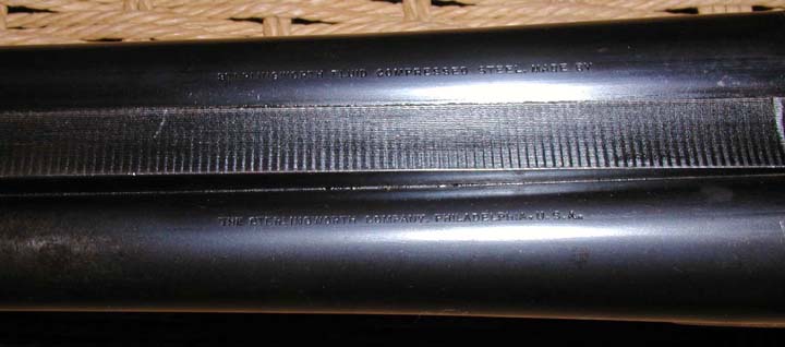

When the A.H. Fox Gun Co. added the lower priced gun, made to "standard" specifications, to their offerings for 1910, they marketed them under the name The Sterlingworth Co. They even issued a separate catalog for the guns --

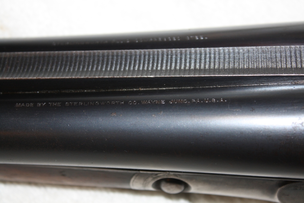

The Serial numbers for these 12-gauge, The Sterlingworth Co. guns began at 50000. From my years of recording observed guns, the earliest guns have a rounded profile to the sides of the frames --
and about the first 200 have Wayne Junc. as the address, but after that Philadelphia, U.S.A.
