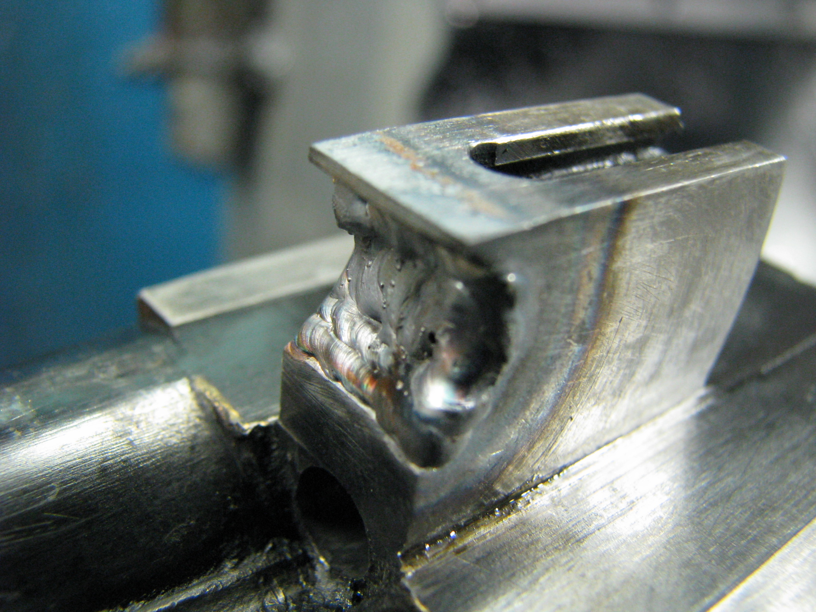

Harold, with the typical hammer tip protrusion on a Fox, I can't imagine the barrels being that far off the face to result in light primer strikes/misfires. I suspect that left hammer tip is broken or the left mainspring or hammer stirrup is bad. Regarding off the face, if indeed more than a thou or two off the face a proven GOOD 'smith can tighten that by microwelding on the barrel hook, machining to a very tight fit and then final fitting. The 'smith has to be very careful the axis of the new cut is dead nuts on the original center and also perpendicular; otherwise it becomes a mess situation.
Here for info are pics of a welded hook and the fixture and DRO (digital readout) I use to locate and plunge mill that axis exactly on center + .003" for final fitting. Yes the DRO on the milling machine reads out in ten-thousandths. Last pic is of a welded hook after the plunge milling and before final fitting.
This work is on my own Foxes; sorry I don't do commission work and haven't had any barrel jointing done by anyone after two bad experiences with a 'smith out west about 20 years ago. That was the first and last time I used a 'smith for barrel jointing work and thus I have no personal experience with jointing by anyone else. But with that said I've seen enough other Fox work by Brian Dudley in NY and Lou Rotelli in CT to suggest people contact them to check on their interest and queue times. frank
