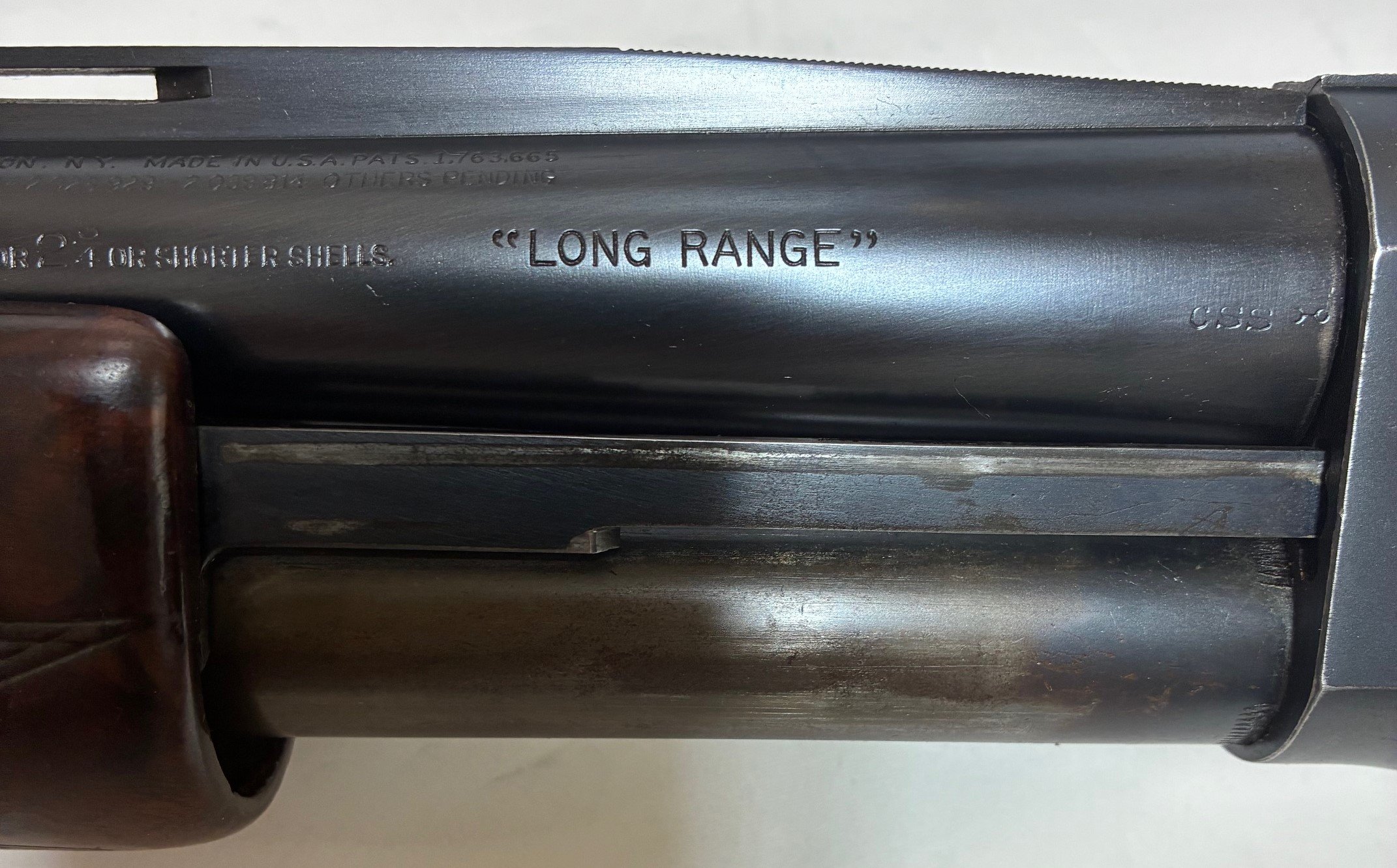

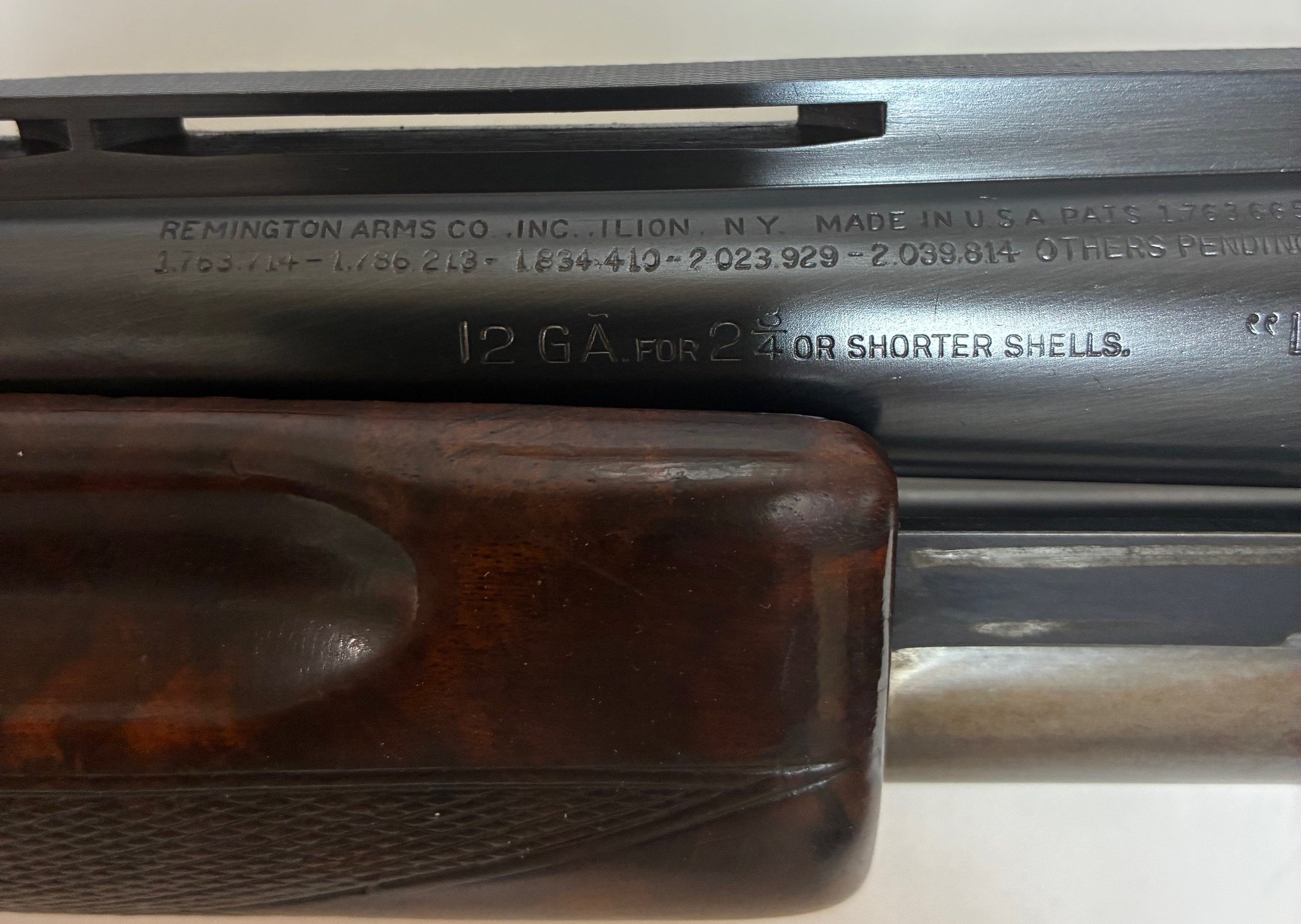

Guys another what I would consider "Factory" Long Range barrel example just changed hands on TS.com.
Notice there are no other choke marking in the normal areas, in my mind suggesting the barrel was selected and bored to long range specifications prior to any other borings.

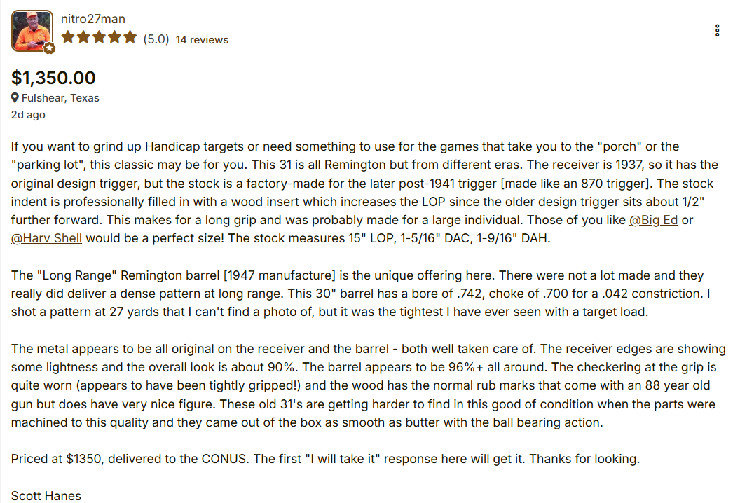

Scott was kind enough to fill in some of the bore and choke dimensions.

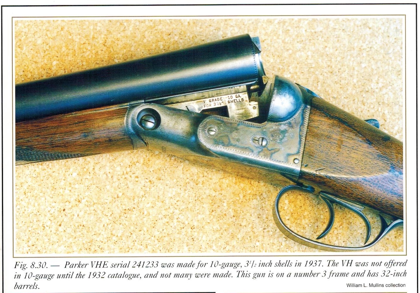

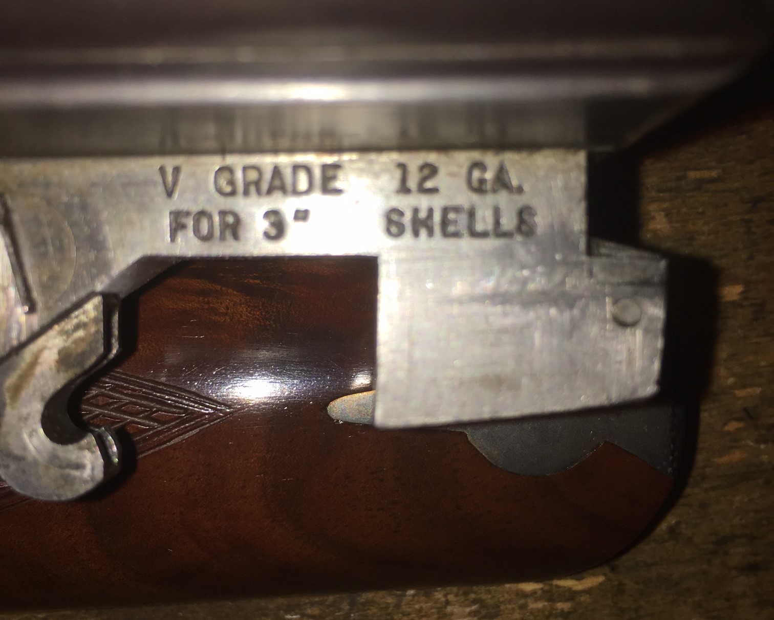

Seems like a lot of hype for a lame attempt to have something to compete with the Winchester Model 12 Heavy Duck. They offered their Model 32 and Parker doubles with 3-inch chambers in 12-gauge and the Parker 10-gauge with 3 1/2-inch chambers.
While some of the Remington catalogs offer 3-inch chambering for the Model 32, I have never seen one.

Can other owners of Remington "Long Range" marked barrels report in with the bore diameters. I find it hard to believe that Remington made barrels with a .742 bore like this poster mentions. No one with a "Long Range" barrel seems to own a bore micrometer. Kevin does but his gun is gone. Did he ever measure it?
