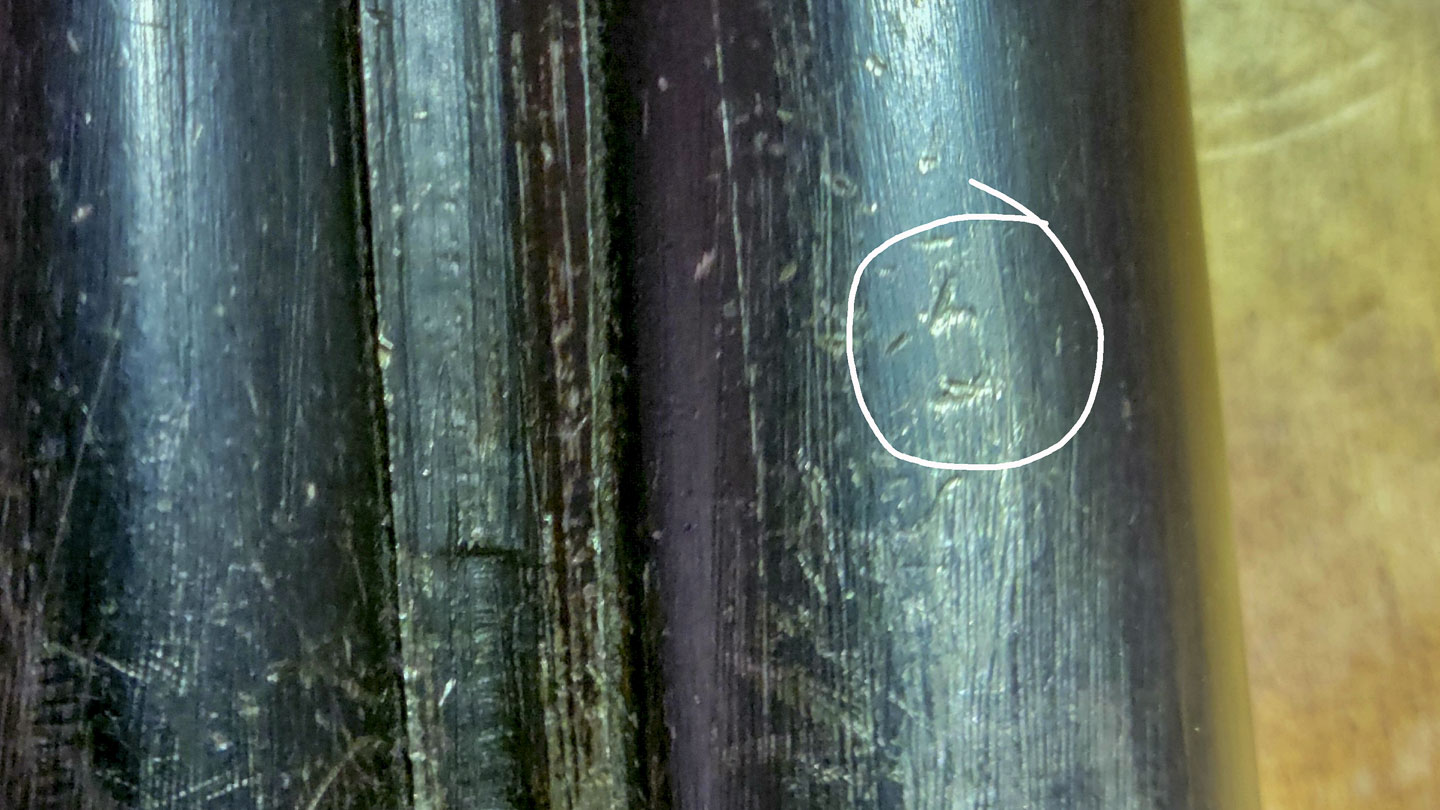

Re: Do 5 wt barrels exist?
Best photo I can get without setting up special lighting. Left bbl has a number (circled), right has nothing discernable. Must be a "3" if 5s don't exist. But the barrels are pretty dang light at 2lbs 13.5oz.
Someone must've taken some weight off somewhere, but I can't see it. In fact, the gun balance ahead of the pin. Anyway, it still shoots well!
Congratulations on your 16 ga. Sterlingworth. They are wonderful guns and a delight to carry. Looks like you had a very successful hunt.
According to the chart in McIntosh’s book, a 28” set of 16 ga., 4 weight barrels should weigh 3 lbs, 1 oz., but remember that is the “unstuck” weight. That means that the “rough-machined barrels” weigh 3 lbs. 1 oz. Several ounces will eventually be removed as the barrels are filed, polished and fitted to the frame. Since your barrels weigh 2 lbs. 13.5 oz., that implies that 3.5 ounces were removed during the “striking” process.
For comparison purposes, I just pulled my 26”, 16 ga. A grade out of my safe. According to McIntosh, the unstuck weight of the barrels was 2 lbs., 15 oz. I put mine on a scale and they weighed 2 lbs., 10.6 oz. This implies that 4.4 ounces were removed during the striking process. Reasonably consistent with your barrels.
I’m sure that many of the members have weighed their barrels and compared them to the unstuck weight listed on the chart. I don’t know that there is a reliable “conversion” rate, but surely the finished barrels always end up several ounces lighter than the charted weight. I hope this helps clarify the situation.
Thank you! It hadn't occurred to me that the weights listed were unstruck weights. Mystery solved.Jeff S wrote: ↑Thu Jan 30, 2025 9:38 pm Congratulations on your 16 ga. Sterlingworth. They are wonderful guns and a delight to carry. Looks like you had a very successful hunt.
