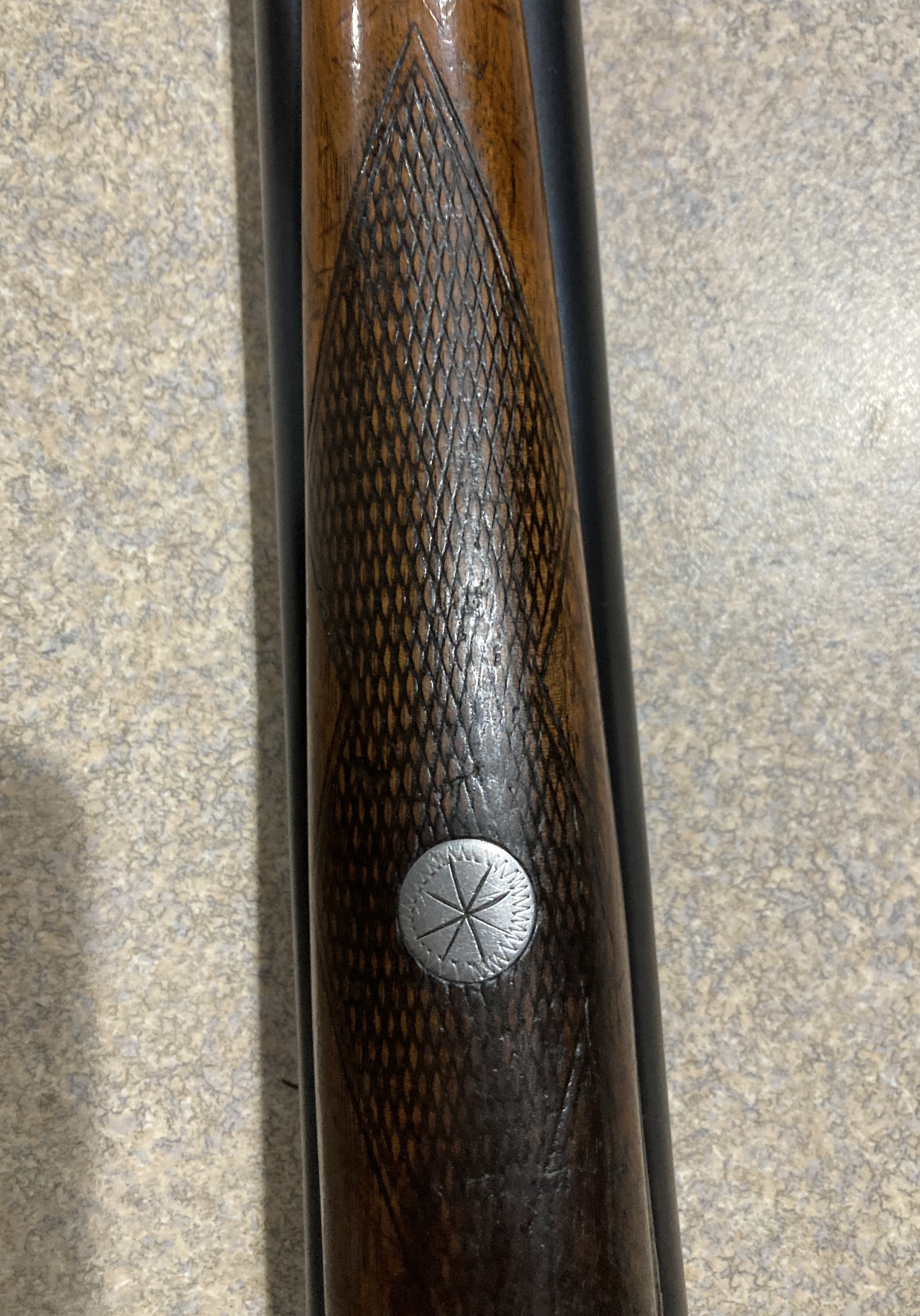

I noticed that some sterlingworth fore arms has a small metal medallion is this only on deluxe models
Posts: 3838
Has thanked: 2903 times
Been thanked: 1818 times
Re: Fox deluxe
Is this what you’re referring to? It’s on all “ejector” Sterlingworths. While it looks nice, it’s not decorative. It helps secure (anchor) the ejector spring system. This is how people can tell if a Sterly has ejectors.

Thanks that’s what I needed I could not figure some early guns having it

Posts: 3838
Re: Fox deluxe
Jabba3153 wrote: ↑Mon Sep 30, 2024 12:17 am Thanks that’s what I needed I could not figure some early guns having it
Jabba, your question reminded me of the time I learned that lesson. When I joined the AHFCA in 2015, several members suggested that I make the trek to Hausmann’s to attend the NE SxS Classic. As I was milling about, one of the members asked what I had brought to shoot. I handed him my 1918 20 ga. Sterly, and he replied, “Oh, a Sterlingworth with ejectors. Nice!” I was surprised and asked how he knew it had ejectors without opening it, and he pointed to that little round anchor. I’d been shooting that gun for 15 years, but because I hadn’t been active in a vintage firearms group, I didn’t know the purpose of that little “button”.
