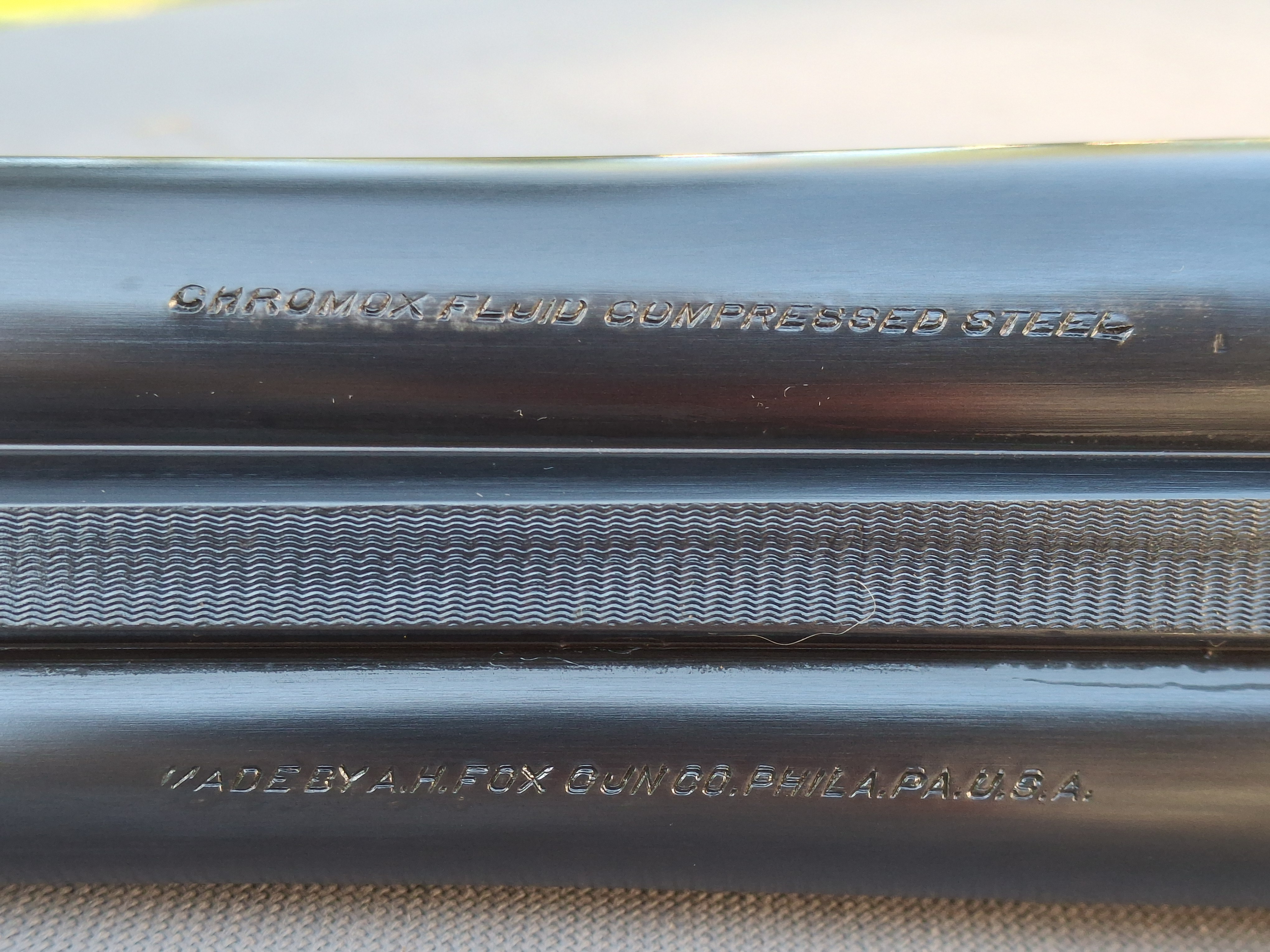

Are the roll-stamps John has A.H. Fox Gun Co., Savage or both. Mitzie obviously had roll-stamps to mark barrels as being A.H. Fox Gun Co. Chromox barrels --

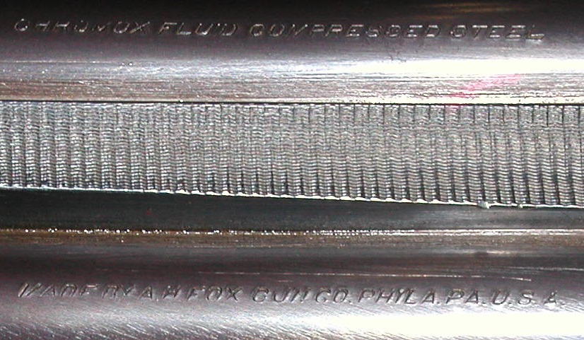

Researcher wrote: Thu Sep 05, 2024 8:15 pm Are the roll-stamps John has A.H. Fox Gun Co., Savage or both. Mitzie obviously had roll-stamps to mark barrels as being A.H. Fox Gun Co. Chromox barrels --
Believe he only has the early ones. Here is a set he marked for me:
