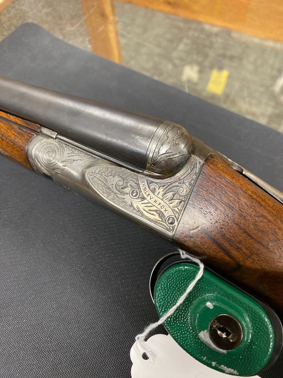

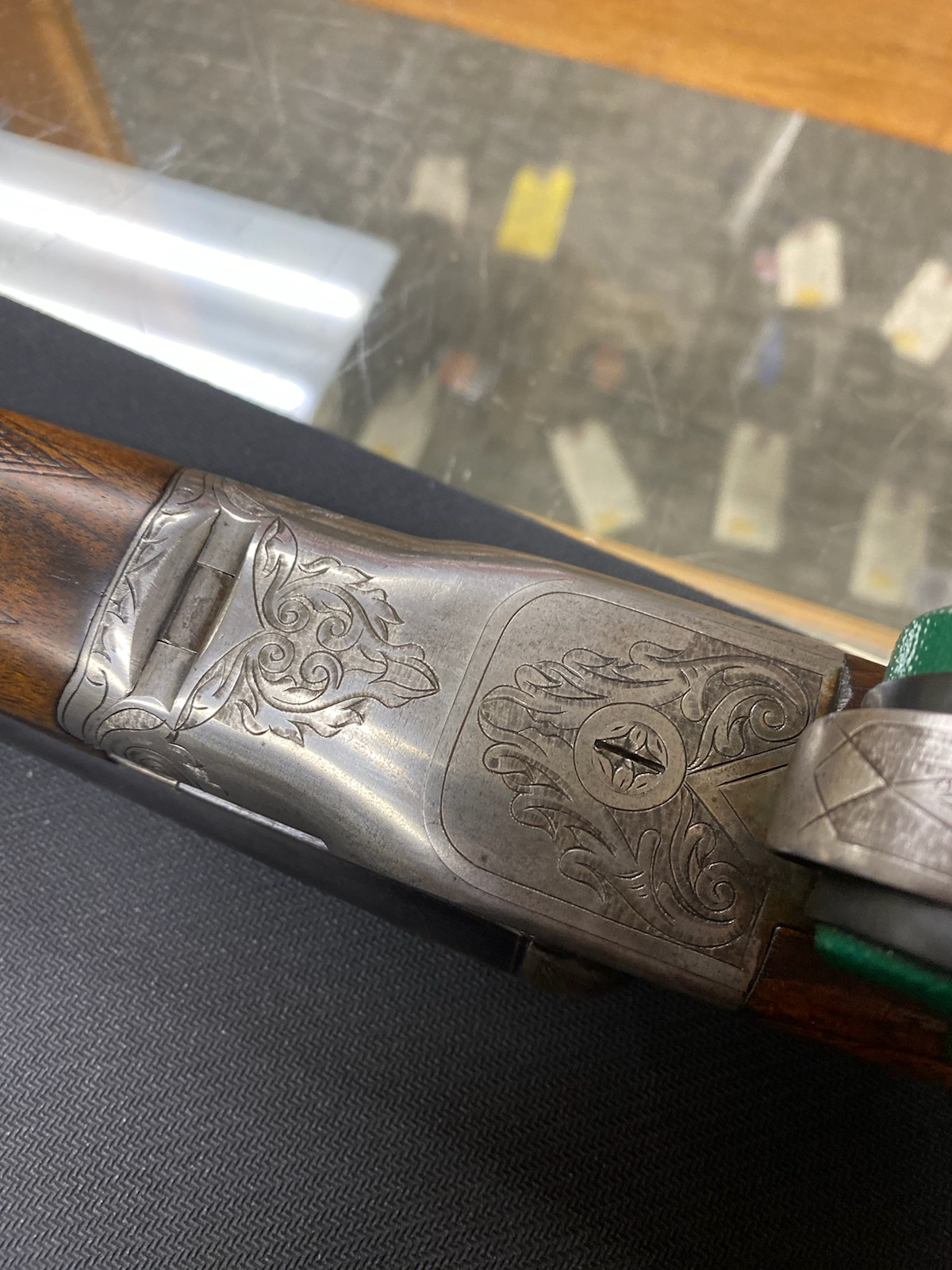

I had them send me a few pictures.
Being new
What can you tell me about it from the limited pictures.
I do plan to at least check it out.

Looks like a very nice late A grade. Worth a look.

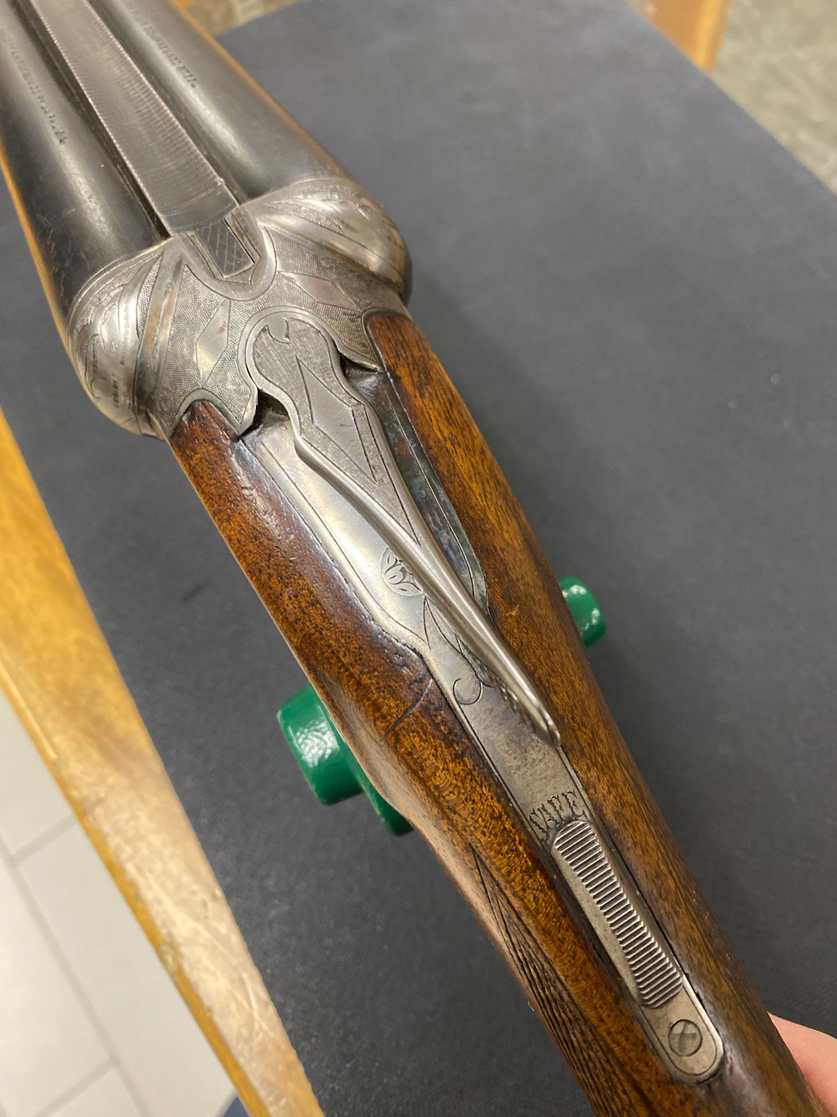

Lever is right of center and the trigger plate screw hasn't been buggered. Things we like to see.

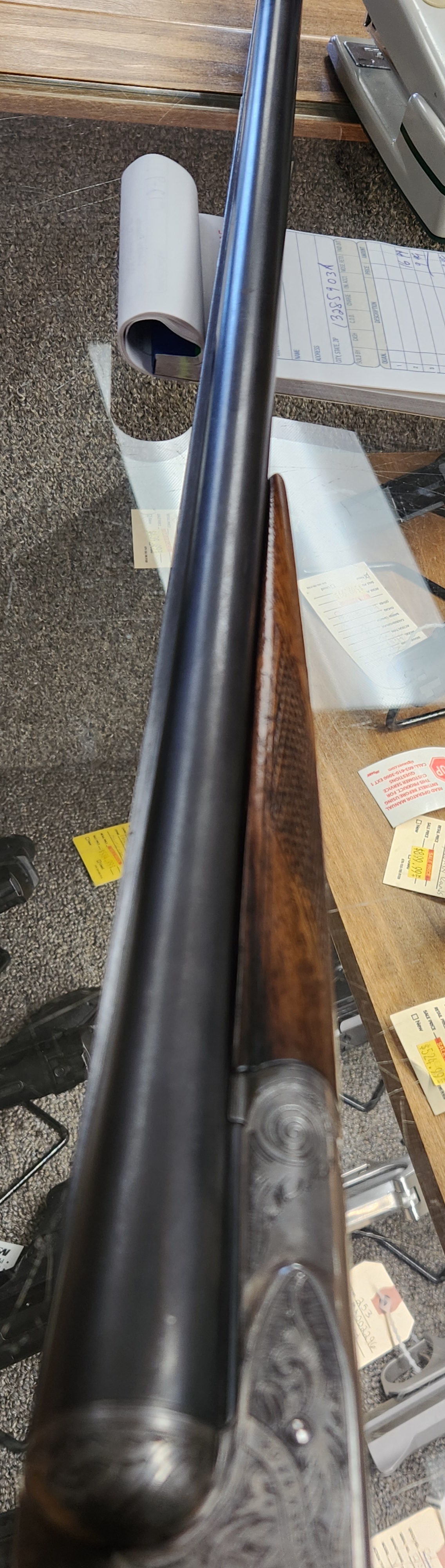

Looks like a 12 ga. Correct? Barrel length?

What they all said. Honest looking gun....at least from what the pics show. Please keep us posted. Frame looks a bit shallow for a 12b (could be just the pic) ...is she a 16?

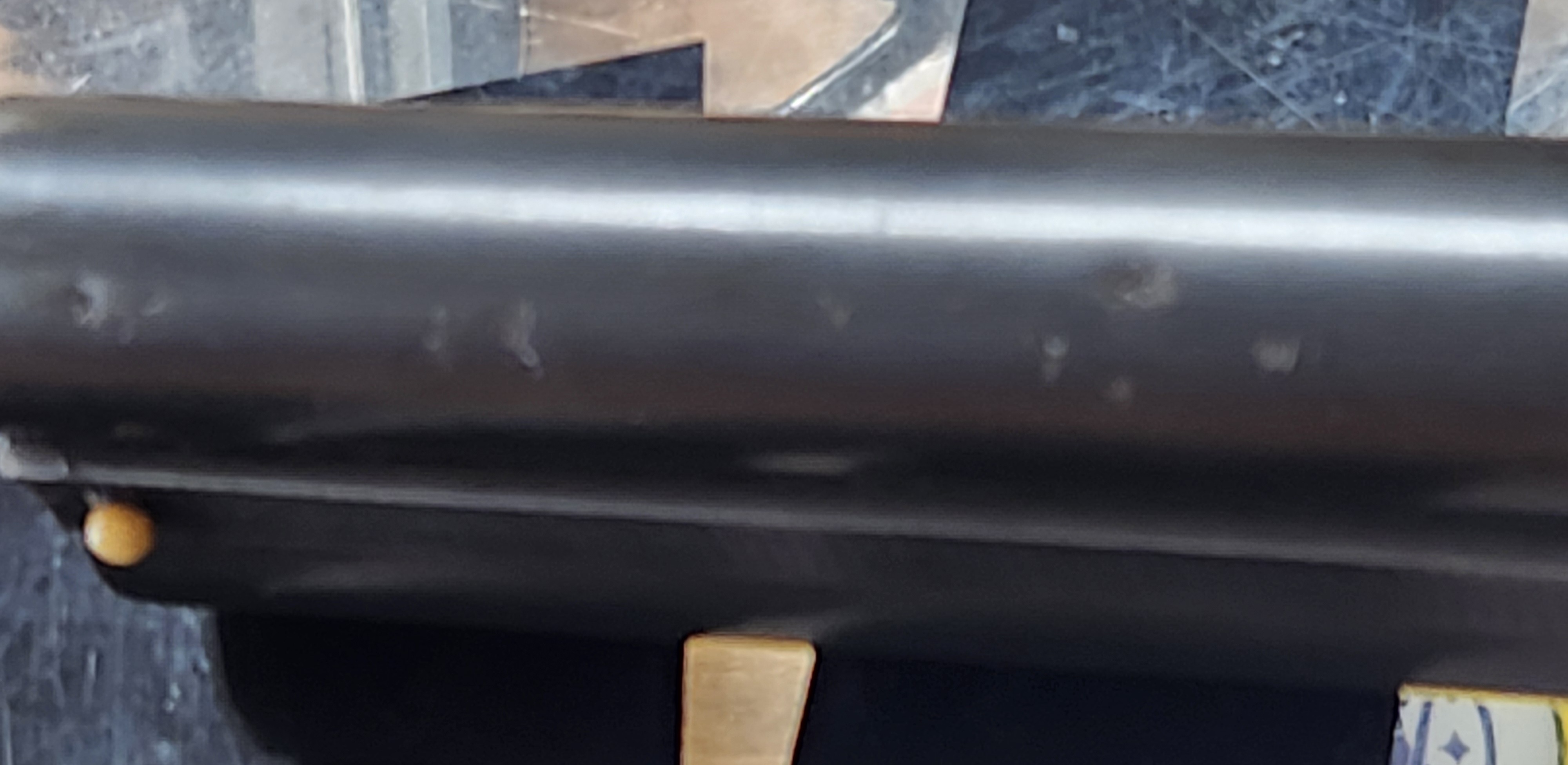

Mid bead is broken.
Had a small dent on a barrel also.
It all numbers correctly and the barrels were 28"

The dent can be raised to the point it is unnoticeable, unless it is a sharp indentation resulting in a "crease" at the bottom. Most dents are not this way. I've removed several myself.
Gun looks good. I don't blame the owner for not wanting to take $400 for it, if everything else checks out right and original.

Everything else seems good/honest to me.
The dent isn't creased.

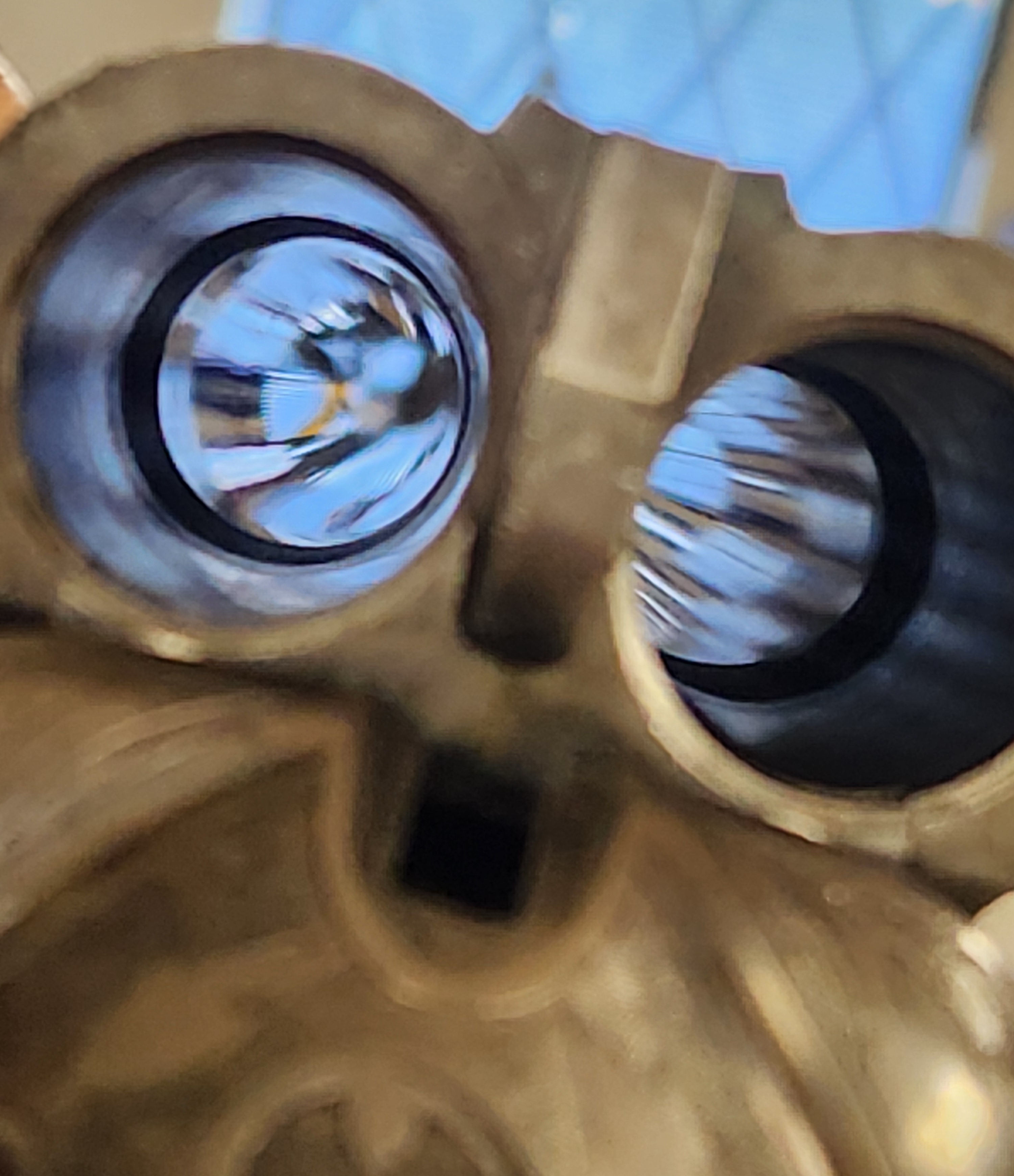

Bores are bright and shiny.

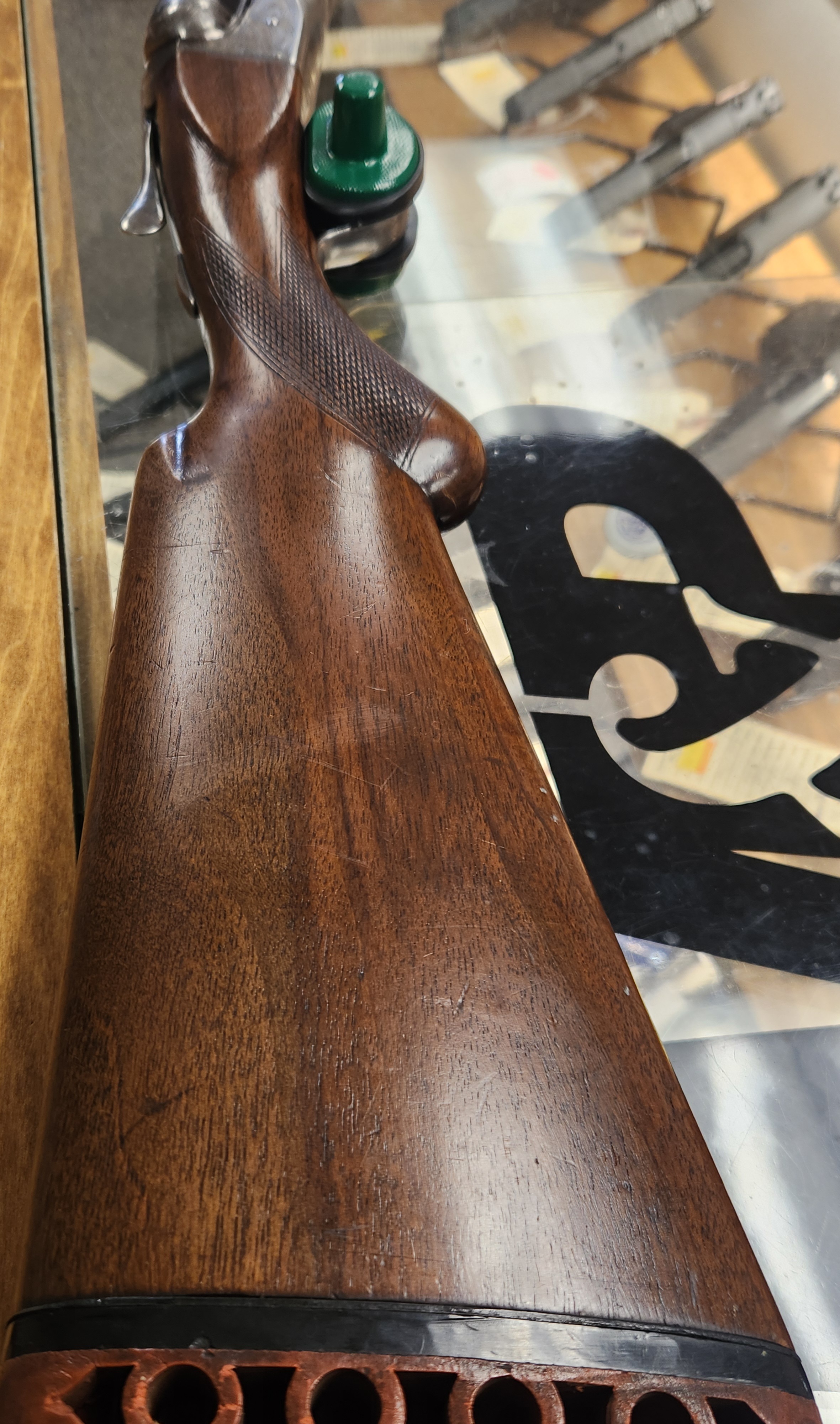

Recoil pad says ranger IIRC so most likely replaced ?

What is the length of pull over the pad?

What do the chokes measure?
What do the chambers measure?
Is this an extractor or ejector gun? If ejector, are the kickers strong and in time?
Any cracks in the forend or buttstock wood?
Are the ribs tight and do the barrels "ring"?

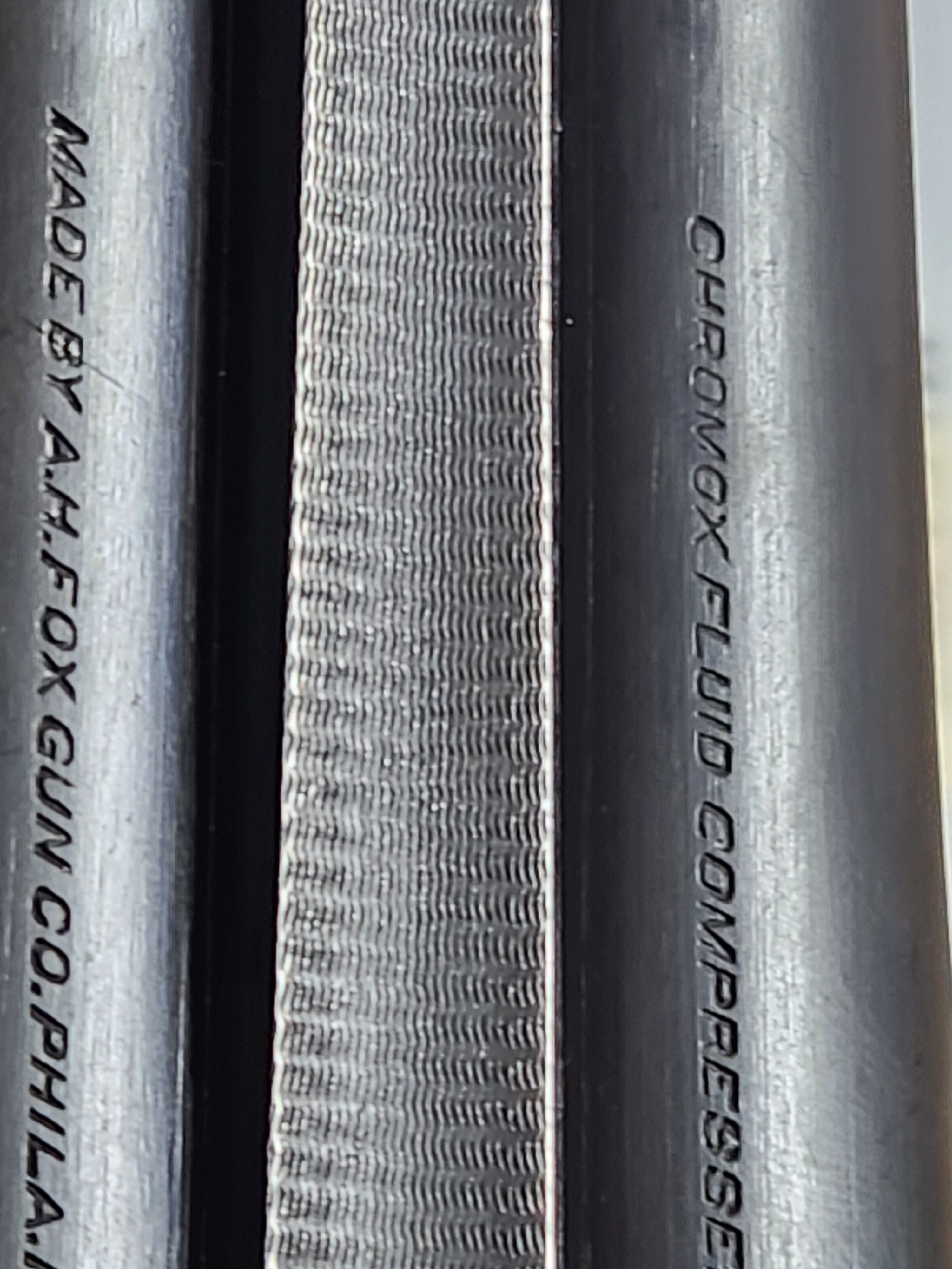

2nd generation “A” grades are nice. I can’t quite make out the lettering on the barrel. Does it say Chromox Steel? Was it made in Philadelphia or Utica.

It does say cromox and it is a Philadelphia gun.
No cracks in the stock.

There are actually 2 dents and I feel leary about them.
Should I be ?
