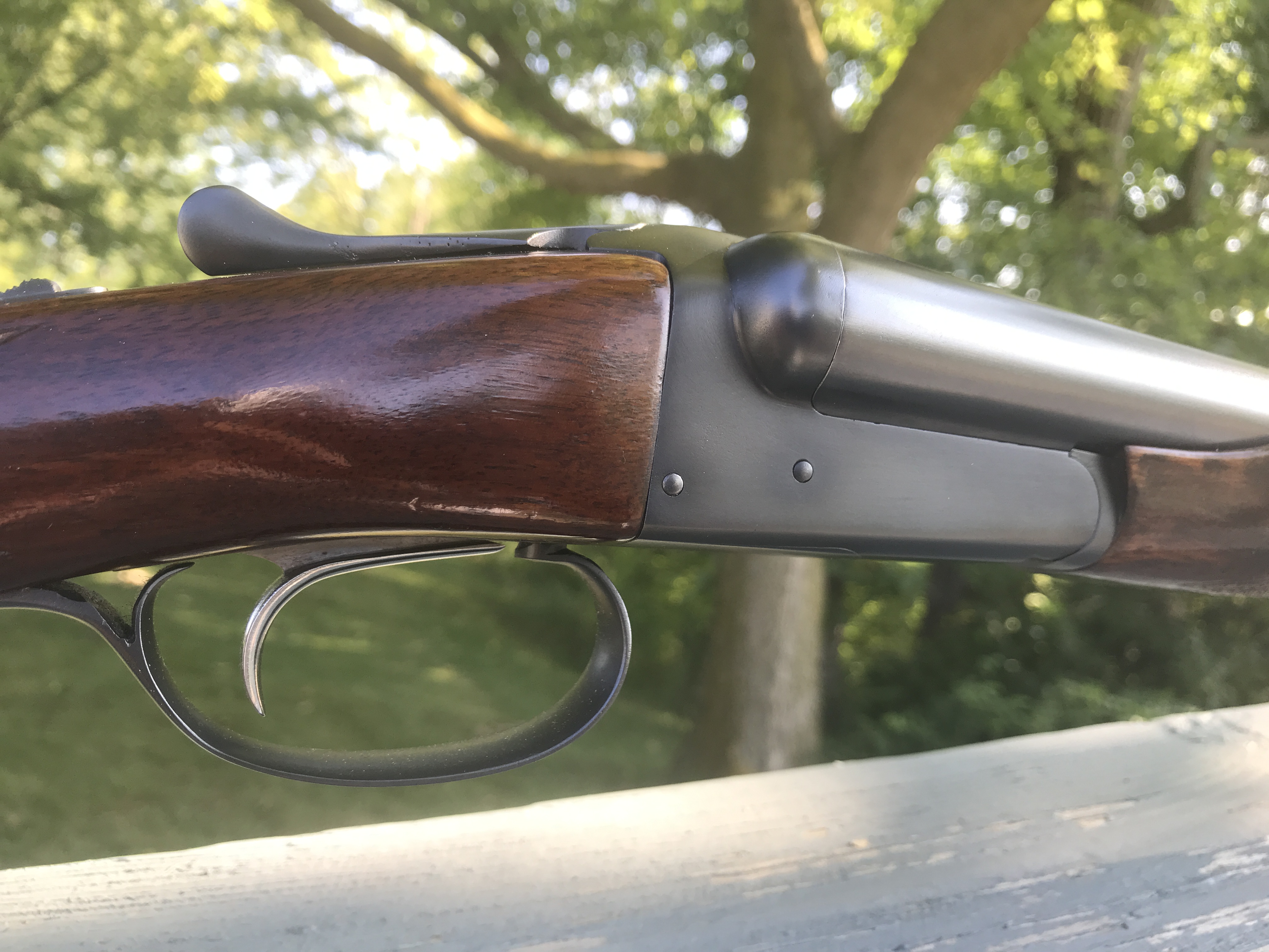

[/attachment]
Here’s an example on an early SPE.

Nice gun!
