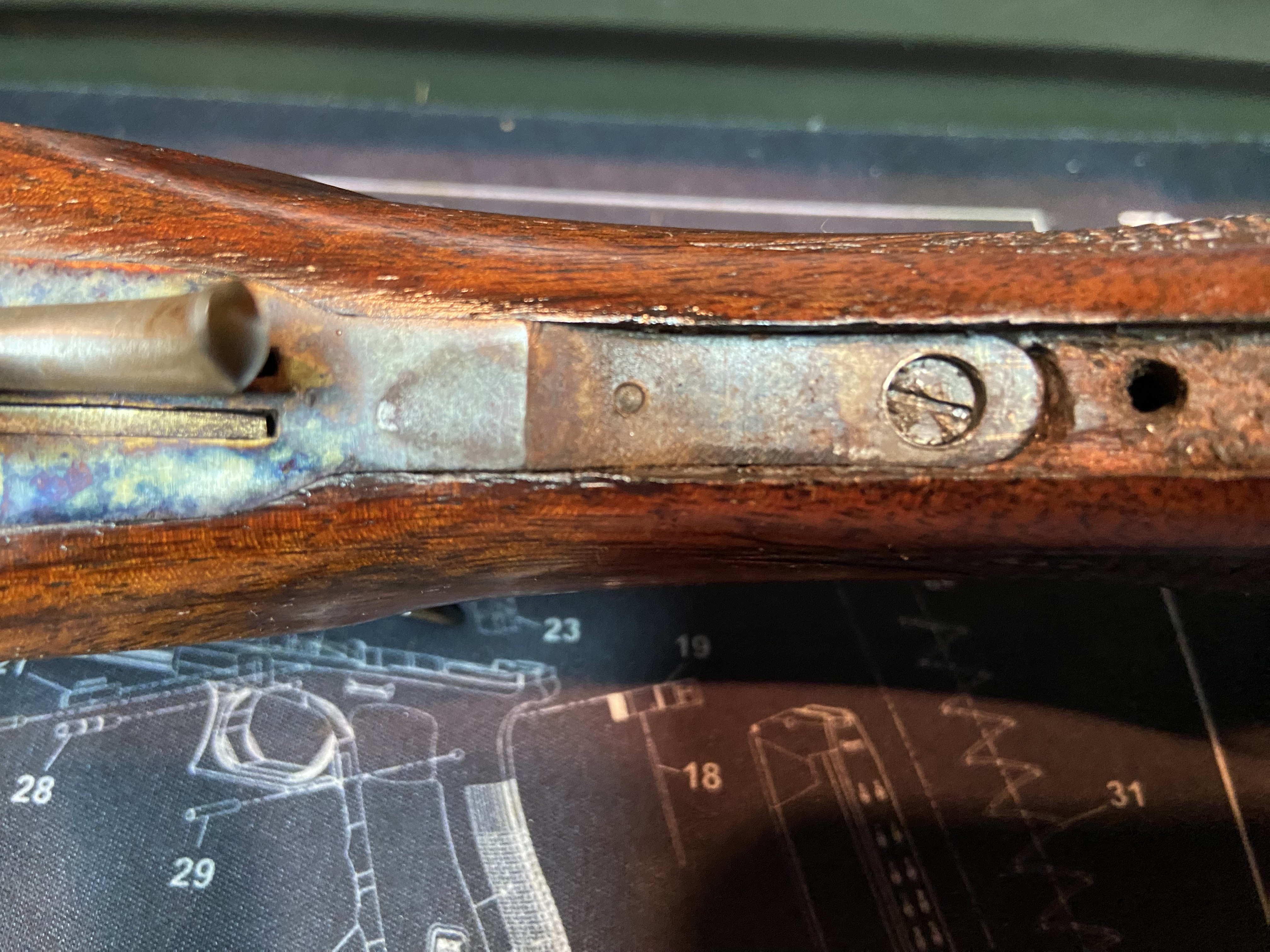

I was having trouble with my 12 Ga Fox during the event the safety would come back on between shots. When I mentioned this to Tom he mentioned to check that the rear tang screw was tight and that you had to remove the trigger guard to expose the screw.
Well I was giving my 12 Ga Fox a proper cleaning after work and noticed that the top tang was a little proud of the wood where before it was always flush with the wood. I carefully removed the wood screw and rotated the trigger guard and sure enough the rear tang screw was loose.
I tightened her up and now the top tang is once again flush with the wood. I hope this resolves the issue but I'll have the gunsmith check it just in case.

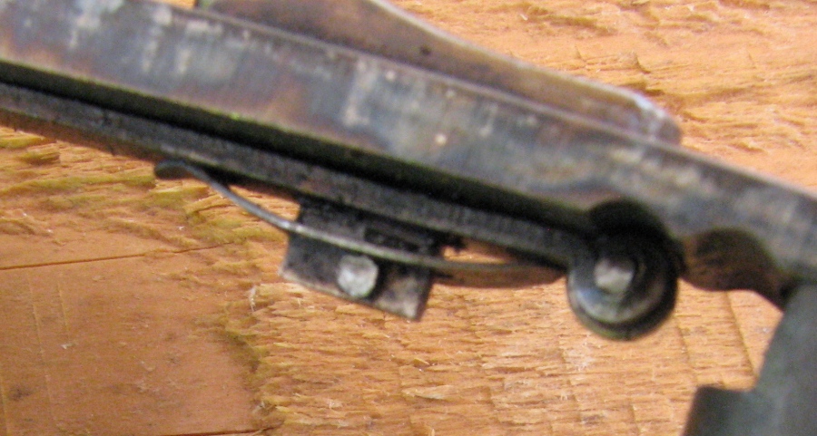

What's been discussed here is a good expedient for a relatively quicky fix but there's a caution. Overtightening the Fox tang screw can compress the very small wood bearing surface that's underneath the top tang and also put a slight bend in the tang. And while that may make the safety button operation more positive a better alternate is to remove the stock and then the small flat spring on the underside of the top tang below the safety button and slide. Most anyone with some mechanical ability can do that. There's a small pin that retains the spring and you'll tap it out. Use something like a 1/8” dia flat end punch and be sure to hold the spring when it comes loose. All easily done. Then use your fingers to put more of an arc in the spring which in turn will increase its tension. Don't overdo the bending, just a little. Replace the spring and pin and reassemble the Fox, and you should be good to go with the safety slide less likely to jump the 'Fire" detent under counter-recoil.
Here's a handy pic of the setup on a Drawbolt Fox; the safety spring/pin setup is the same on all AH Fox guns. Safety slide is forward in the "Fire" detent in this pic. The "Safe" detent is to the rear = to the right in this pic. The retaining pin is underneath the flat spring. frank
