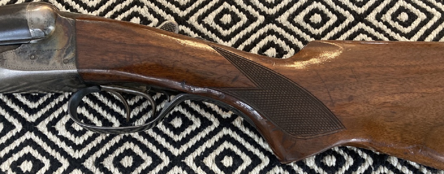

I'm curious to learn more about the various stock and forearm configurations found orginally on Sterlingworth guns. I have what appears to be a 1911 "Pin gun" that has a standard pistol grip with a grip cap, but I'm seeing a lot that appear to have Prince of Wales grips as well. Were the Prince of Wales grips mostly on the small bore guns or was there a change sometime in 1911/1912 when they started moving away from grip caps?
My forearm is also a very large beavertail rather than a splinter. Curious about the likelihood that the wood is original rather than a restock.

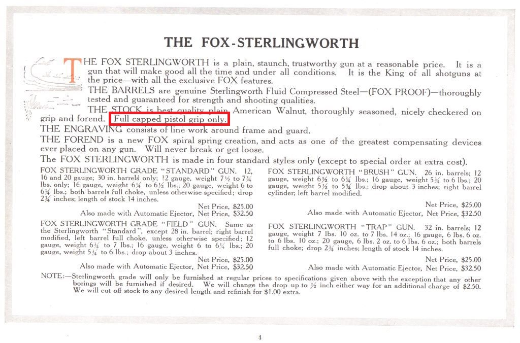

The Half Pistol Grip was the standard on the graded guns, A to FE. A capped pistol grip was the only style offered on the Sterlingworth during the Philadelphia years. From the 1910 The Sterlingworth Co. catalog --

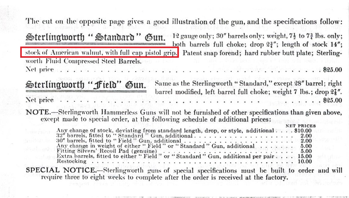

1913 Sterlingworth folder --

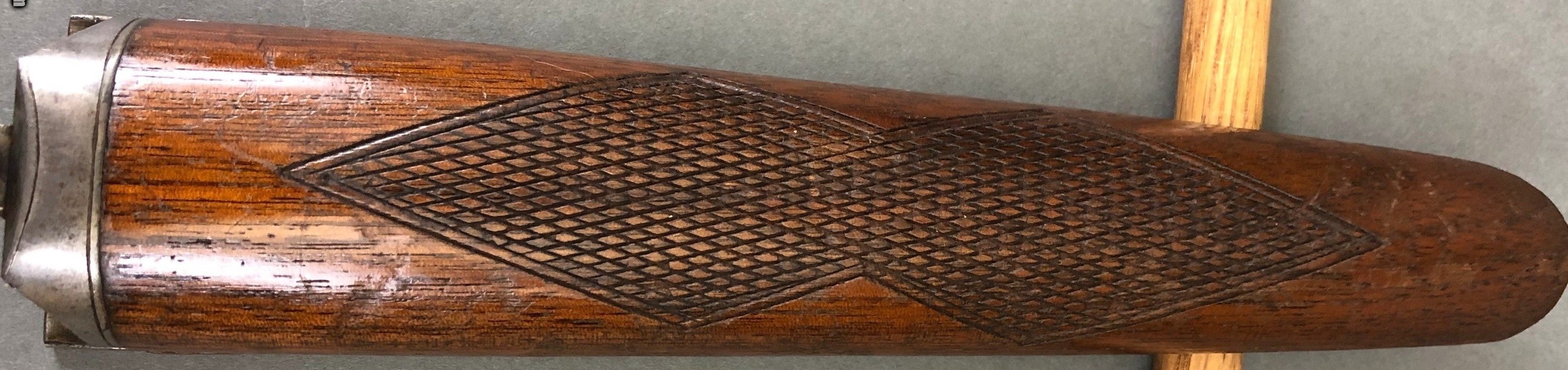

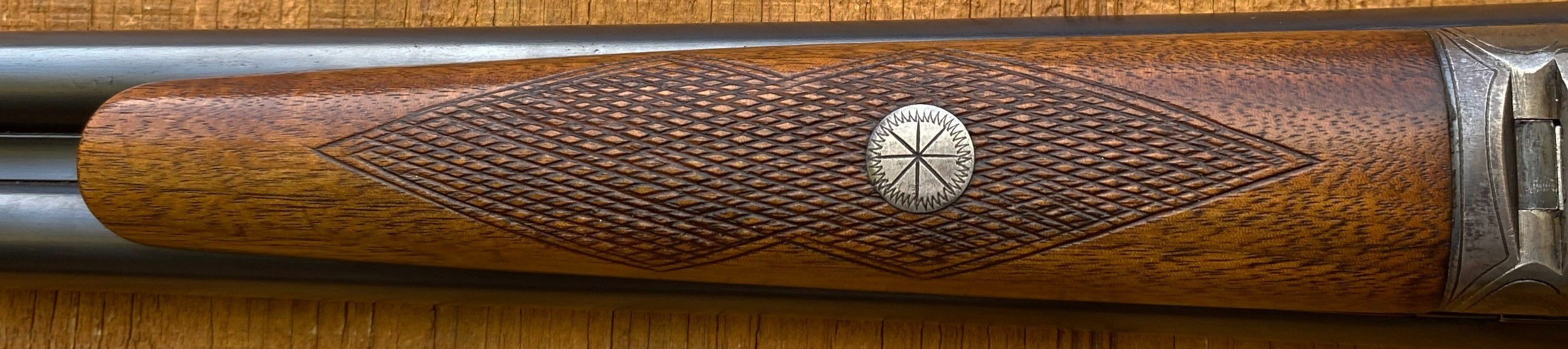

All Philadelphia Sterlingworth forearms were slim. Extractor --
Ejector --

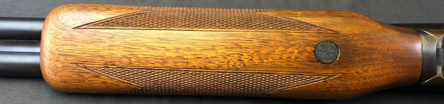

A beavertail was only offered on the very last FOX-STERLINGWORTHS from Savage. The first offering of a beavertail on a FOX-STERLINGWORTH was when the straight-gripped FOX-STERLINGWORTH Skeet & Upland Game Gun was introduced in Savage's 1935 A.H. Fox catalog.
Typical Savage era FOX-STERLINGWORTH beavertail forearm.
Factory original beavertail forearms on these entry-level guns are very rare and some of them seen on 12-gauge Skeet & Upland Game Guns have the Deeley latch of the graded guns.

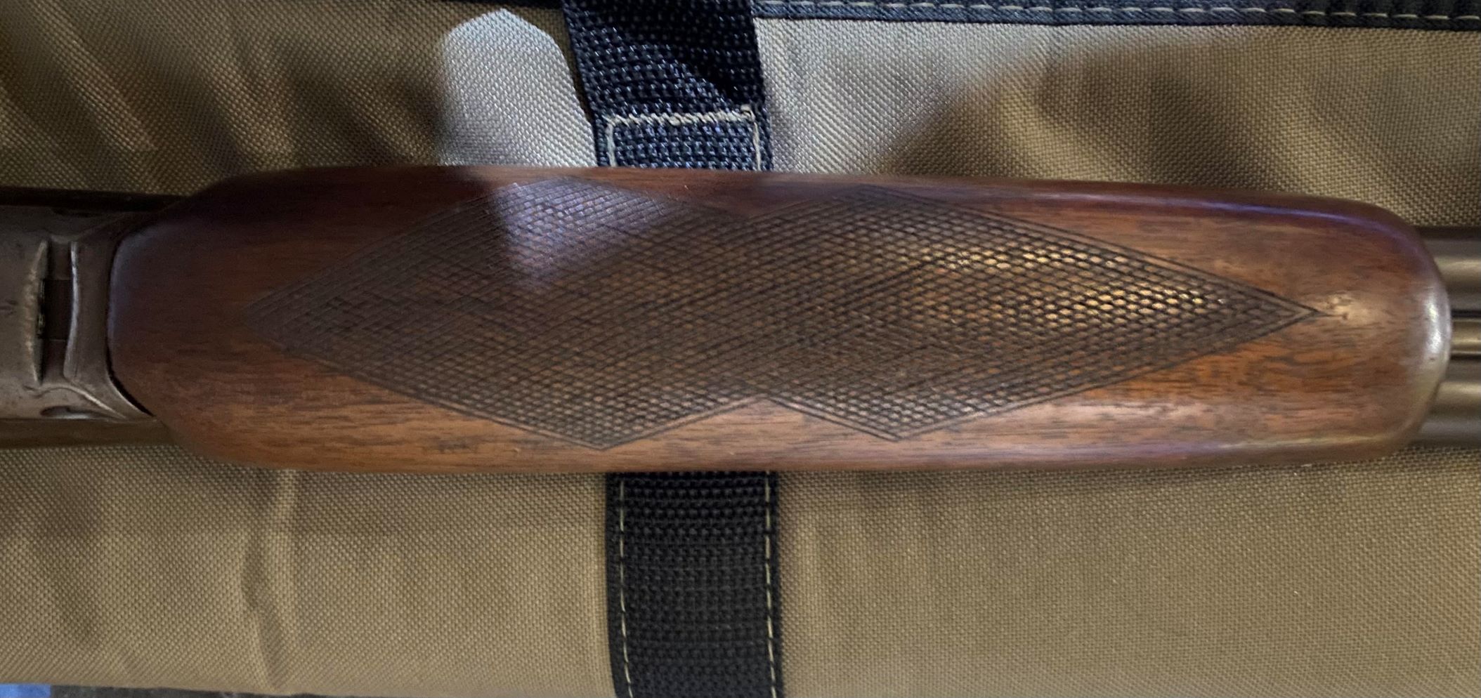

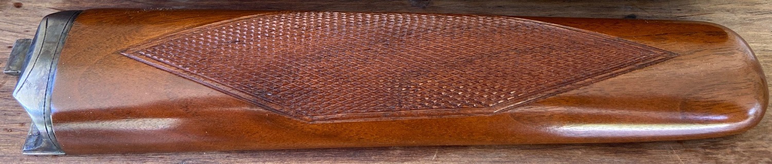

Thanks for the info. The stock has a cap and a full pistol grip, so I assume the wood is original. The forearm is a beavertail, but the gun is a Philly "Pin gun" most likely made sometime in late 1911 or early 1912, based on McIntosh's book. So I'm assuming that the wood there is newer/replacement. It also looks a bit lighter in color, but not sure how much that matters.
I don't know how standard the checkering was on Sterlingworths but this is what mine looks like.
Really appreciate the help and all of the info. I'm fascinated by McIntosh's books and the history of Foxes.
Brian
Posts: 6256
Has thanked: 488 times
Been thanked: 2500 times
Re: Original stocks on Sterlingworth guns
That is definitely an after-market forearm.

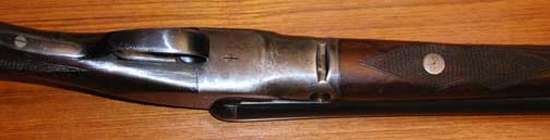

Sounds like a Savage restock. I own Sterlingworth Ejector pin-gun Serial number 62126 --
62126 01 Sterlingworth Ejector Standard, Pin Gun.jpg (24.11 KiB) Viewed 5961 times
62126 02.jpg (38.22 KiB) Viewed 5961 times
62126 03.jpg (27.11 KiB) Viewed 5961 times
This is right in the transition from the pin-gun 12-gauge to the smooth dressed pins. Highest serial number pin-gun I've recorded is 62409 in the 12 June 2010 Horst Auction. The lowest smooth pin I've recorded is 61960.

In looking through the images it seems as though someone tried to match the checkering pattern on my forearm with original wood. The top picture of forearms has a similar pattern, but is on a splinter forearm. The forearm has the snap in attachment as well.
Thanks for all the info.
