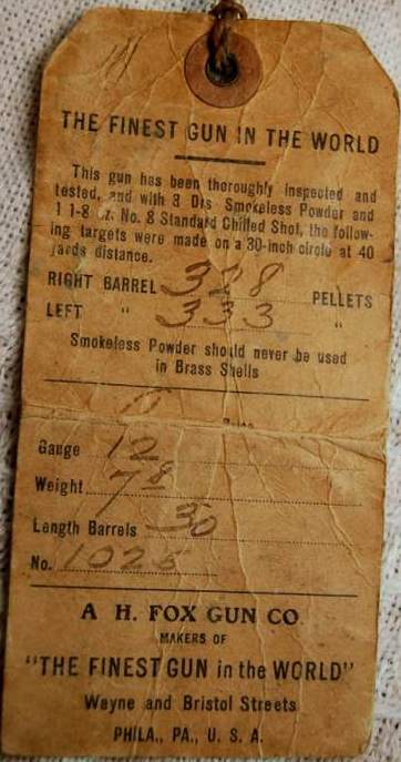

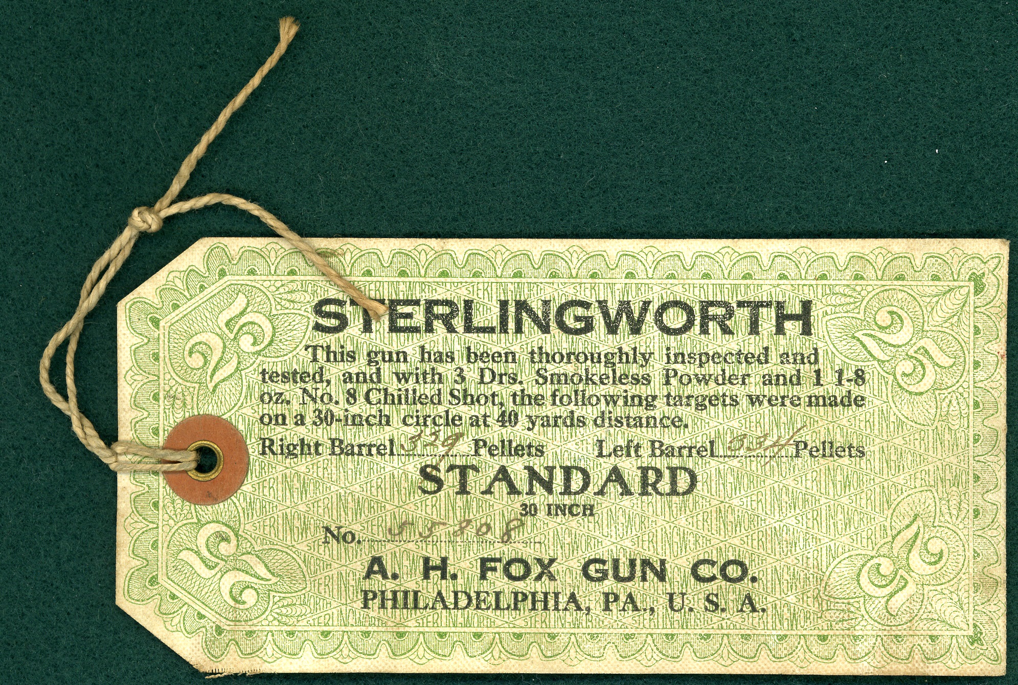

Early hang-tags show a load of 3 drams of smokeless powder and 1 1/8-ounce of No. 8 chilled shot.

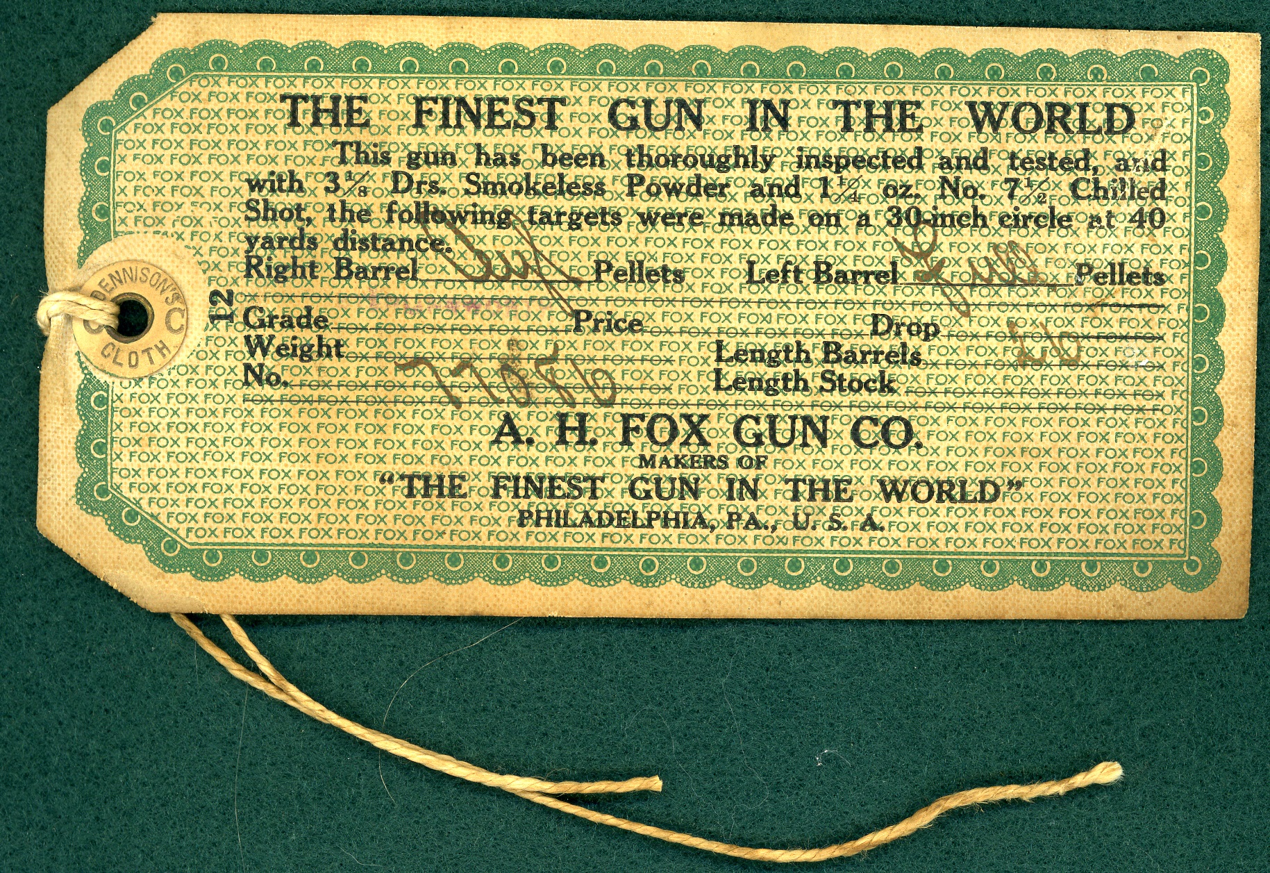

A bit later the tags show a popular trap load, 3 1/8 drams of smokeless powder pushing 1 1/4 ounce of No. 7 1/2 chilled shot.

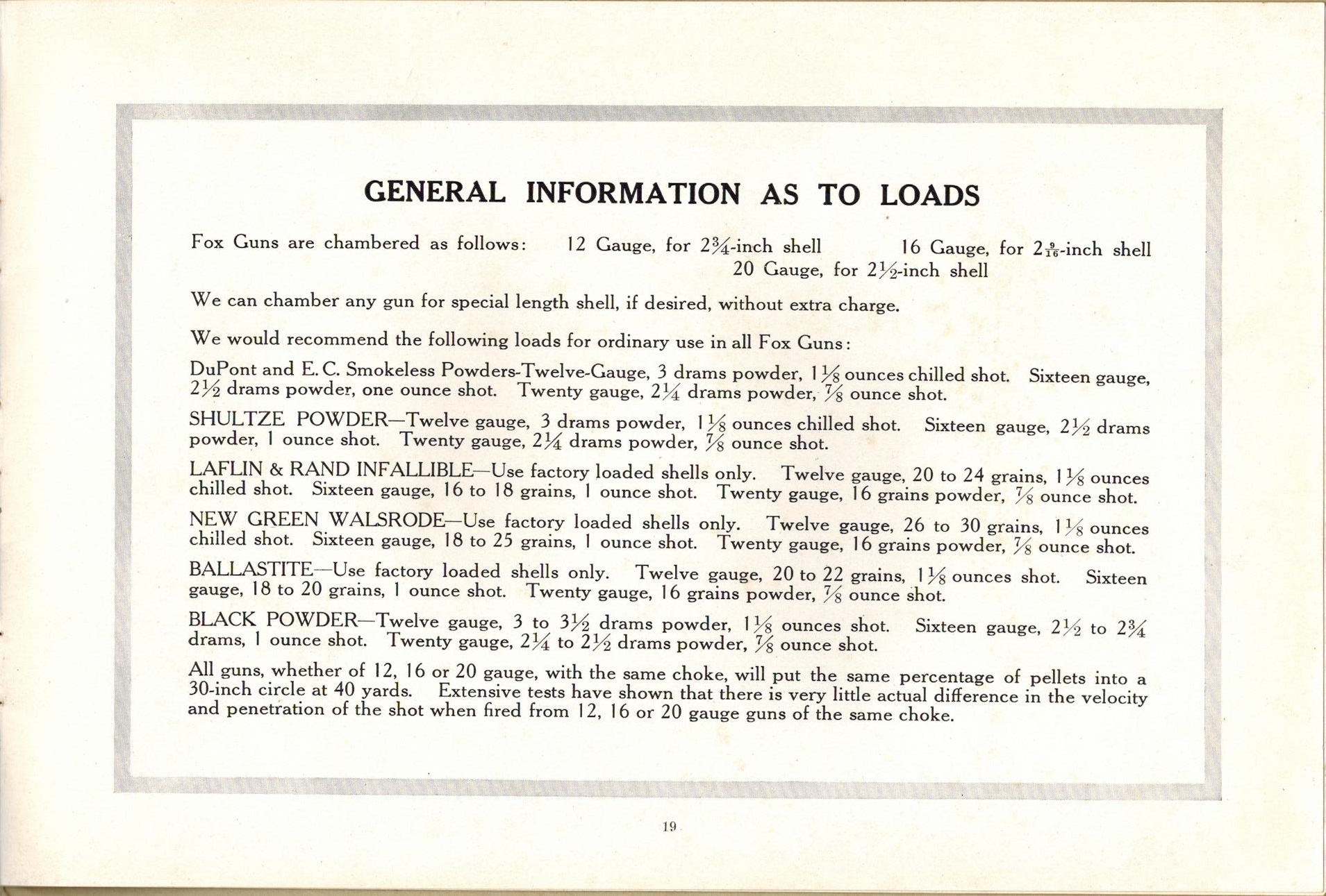

Only one A.H. Fox Gun Co. catalog I've ever seen shows loads, the big 1914 "A Fox Gets the Game" --

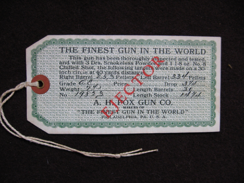

Here's another one for comparison.
An early A 12 with 30" barrels looking to be choked Mod and Full. By the way, the gun does not have ejectors as the card says.
Pellet count pretty close to your gun: 253 and 334 from a load of 1 1/8 ounce of #8's

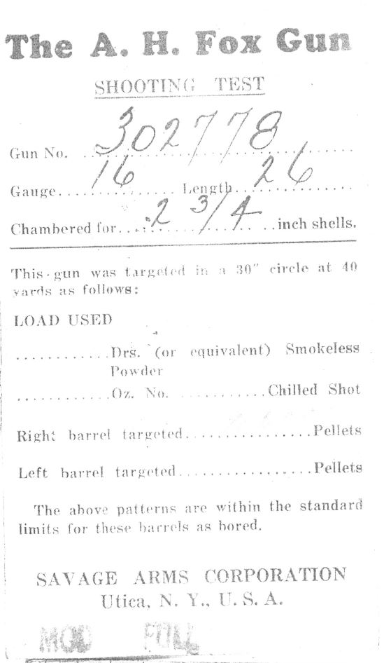

Here's a scan of a Savage Shooting Test form.
